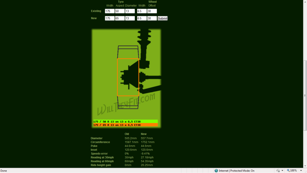

Increase the height? your going the wrong way mate.humm really? they only increase the height by like 3mm which isnt really enough ill try and find some 165/65 with rim protectors
Whatever size suits you, if you have rock hard suspension you will scrape less... meaning you can go lower. (Y)
