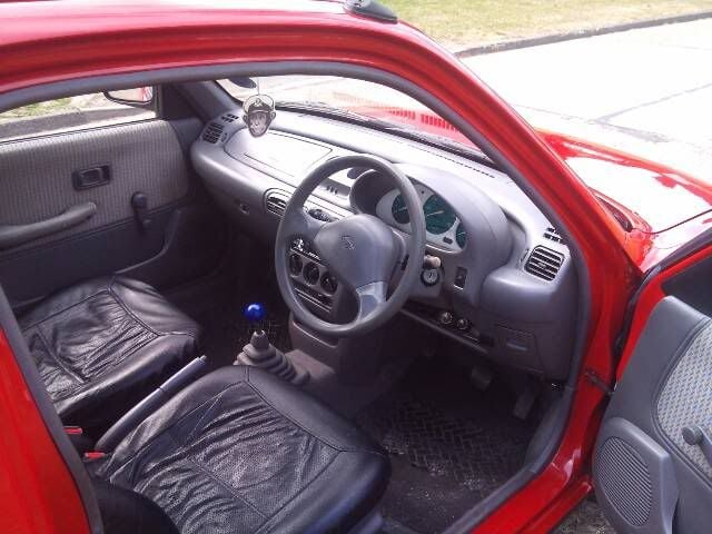

I've just fitted a pulsar short shifter myself. Where the stick joins with the connecting rod, you reuse the micras metal sleeve, and put a washer from the pulsar short shifter each side before threading the bolt back through, so there's no movement there other than what they should be. But the main place they rattle is where the ball is held on the stick. Theres a circlip ontop of the ball holding it in place but its slightly loose. I took the circlip off to remove the ball joint and slid a rubber o ring down to the bottom where the metal ball sits, there's a recess which seems to be made for one too, doing that made it a snug fit when put together. And no rattles!:grinning:

how much space you reckon there should be so that it doesnt lock up? like 1.5mm washer each side?
my kit came with 4 washers, and I only used two:) These were closer to 5mm each iirc and still had some play before tightening up. I might be able to send you the others, but you should be able to get a couple from halfords easily. And I found my rubber o-ring off the garage floor:)

Well your 1 guess beat my 3/4 Will, the washers I've used are about 1.5mm thick, I thought they were thicker:wasntme:

Well i used rubber innertube with a hole for a like bush in the bottom works nicely!
And i found an o ring to put under the 1st circlip as u go down the lever but still rattles a bit :-( so maybe another? Im gnna remove the whole thing again and check it over anddd use more o ring in there
I put mine at the bottom, and iirc as the weekend was a long time ago, I put 1 layer of electrical tape around the shaft between the ball, just try to reduse the amount of metal on metal contact and make it all snug.
ah so the top one was wrong :(so remove the entire thing again and remove the top circlip and lower it through and then place a ring around the bottom circlip and fit it back though... i see

5 layers of the stuff smothered in grease makes it smooth but softens it up but its good if i see u one time u can try it
only movemont is from the actual joint and the movement in the gear linkage

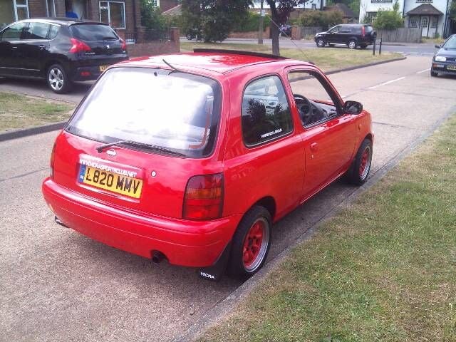

just a few picture updates!
not 100% set on the wheels yet they need a paint and polish on the rim to look perfect!
but dont some tcutting in the shuts etc too but i got too hot
when i said not 100% sure i ment on keeping them haha
heres a little picture story
maybe go back to the white wheels one day? or stick with the 13"s?

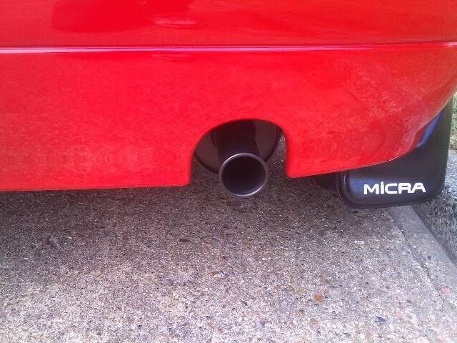

however yesterday i also had it all booked in for the exhaust to be done but im going to go back as i dont think it was even done at all it still blows :(

i wouldnt say a grinder would help... but can gun gum be used on joints? where it slots together and the cuts are its pushed right in but still blows by so i may a small amount of gun gum on these points
I use high temp black silicon :D
if the garage done there job it should already be pushed together but i know gun gum isnt great and falls off very easily... scott whats the sealent stuff?
Maybe it hadnt set and you gave it a "spirited drive" and blew all the stuff out?
and its just high temperature Black Silicon from a motor factors or B&Q man. Custom Phil at Unique Exhausts doesnt use gaskets, only silicon and they never blow if left to set.
To an extent yes, but it should only be used from the cat-back where temps arent as hot as manifold area etc. Same with gungum, its not recomended to be used forward of the cat, but folk do anyway.
