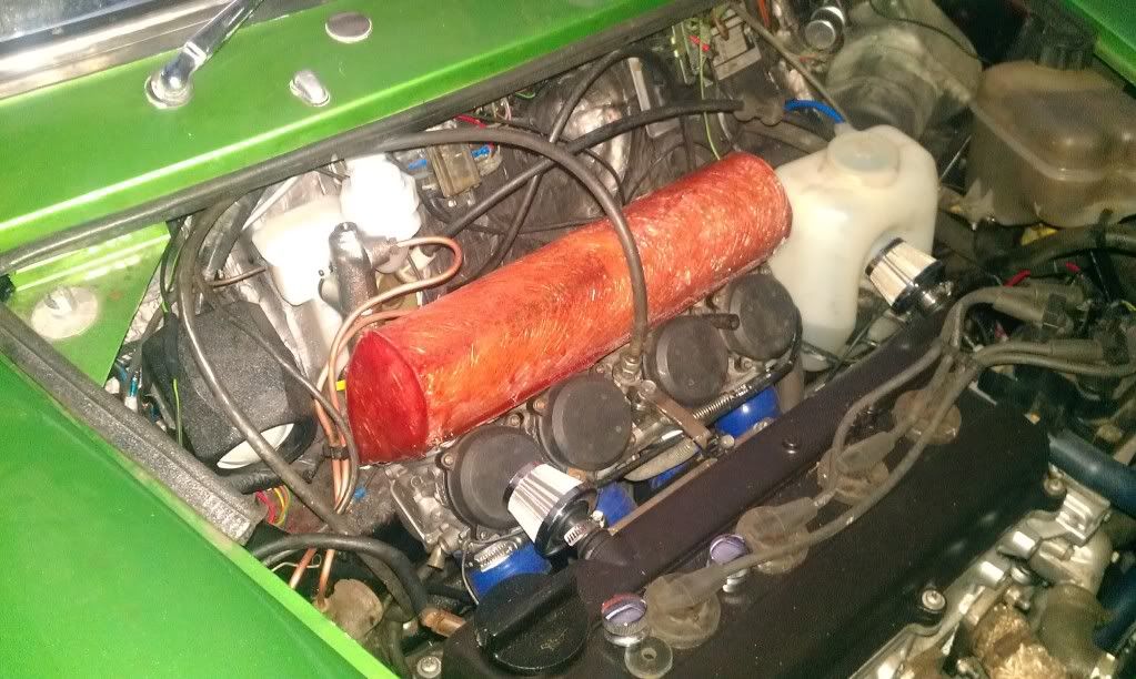

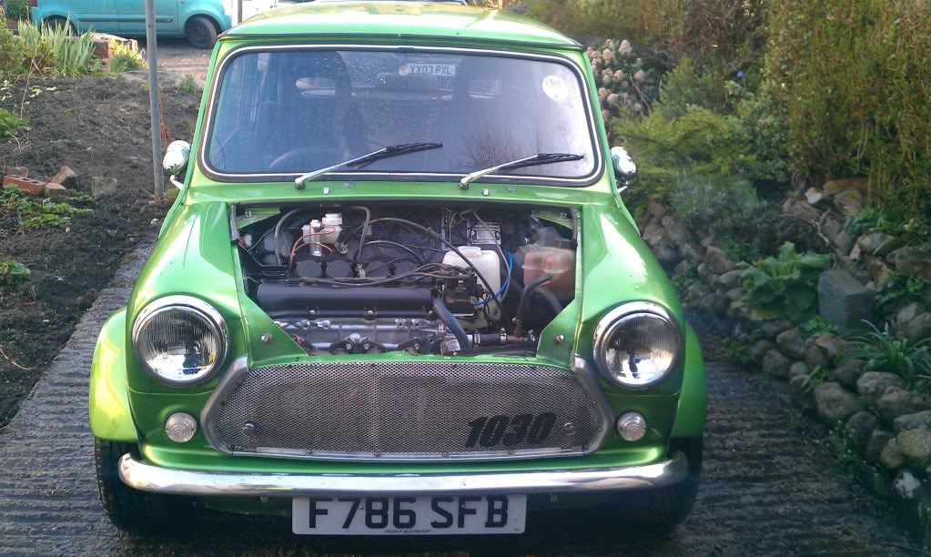

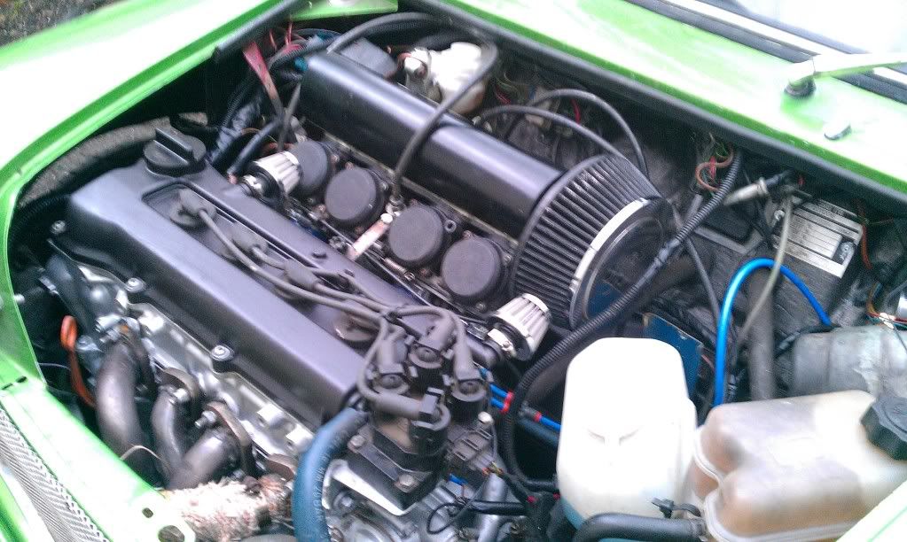

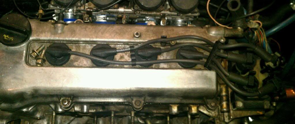

not sure if anyone is interested but i thought id share a few pics of my mini with its new cg10 heart
mini
cg10

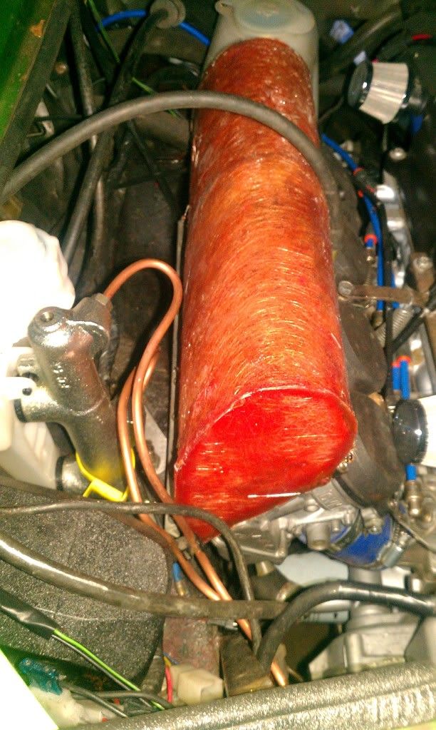

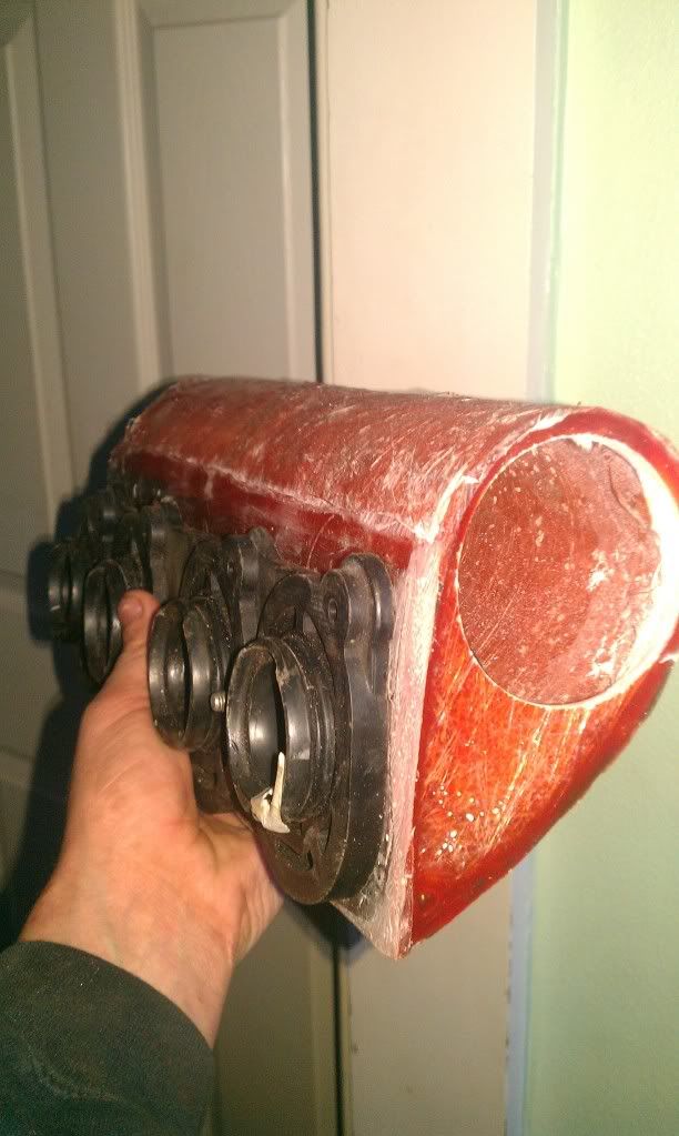

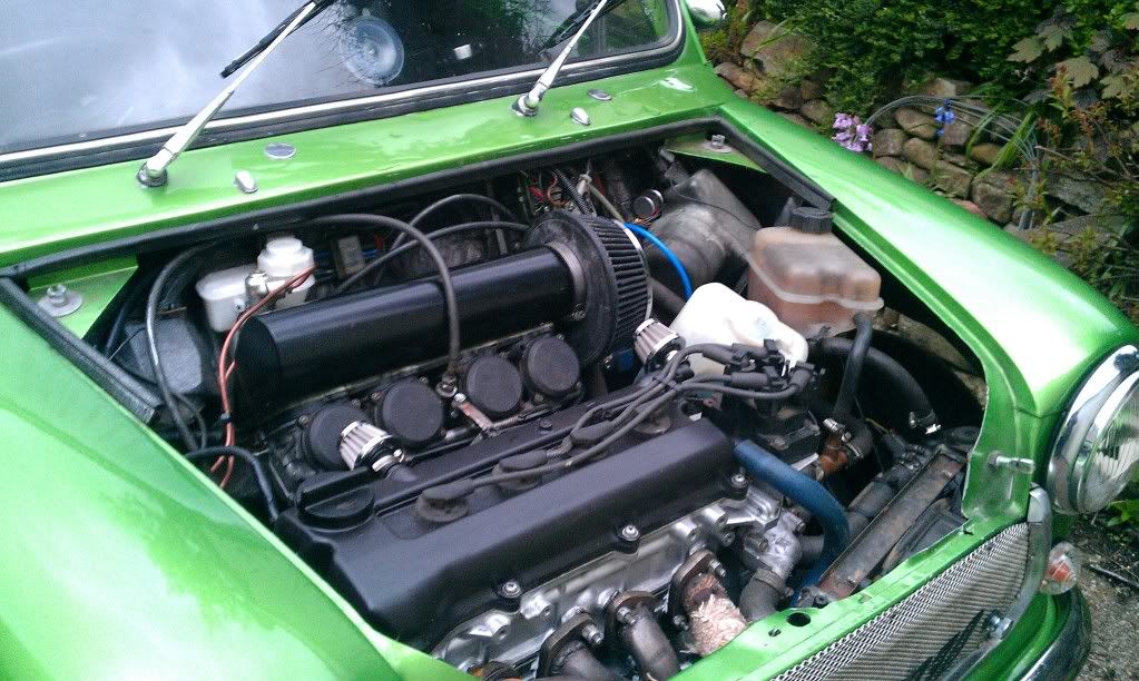

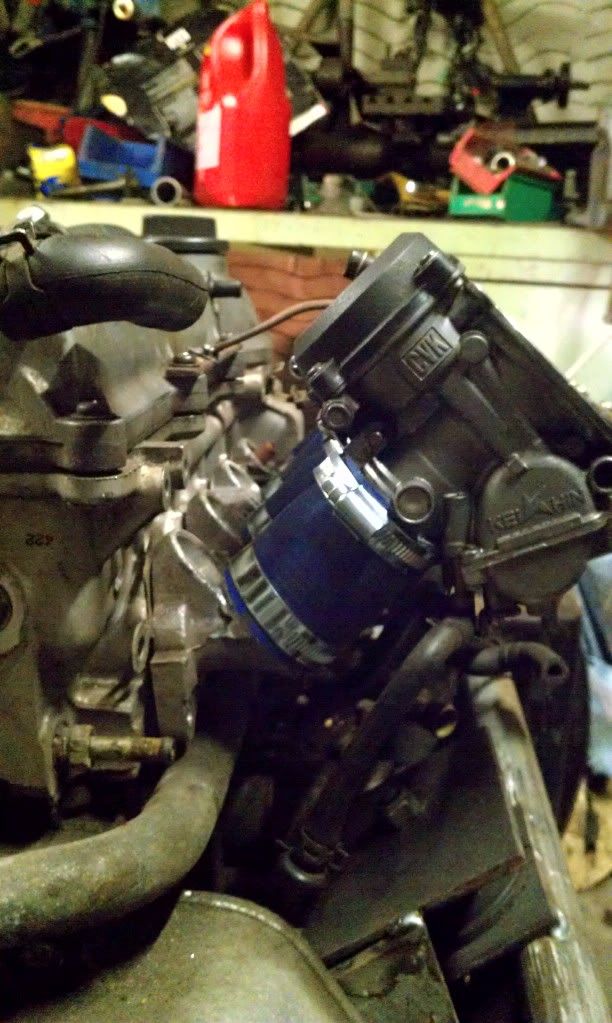

rover k series manifold made to fit
inlet manifold modified to accept bike carbs

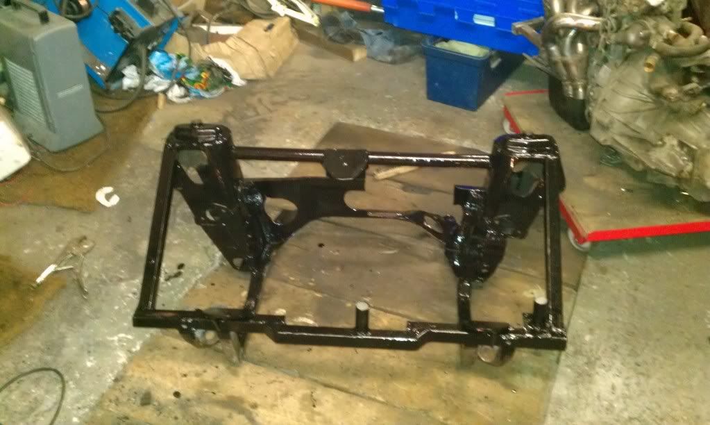

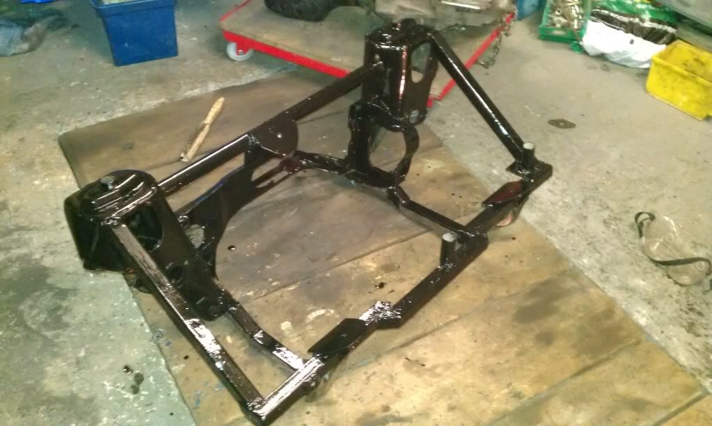

built a subframe

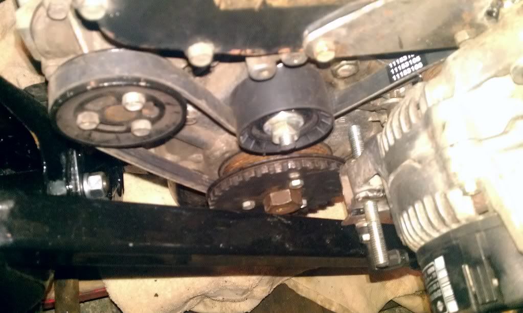

idler pully and bracket for alternator belt also a trigger wheel fitted to allow me to use megajolt

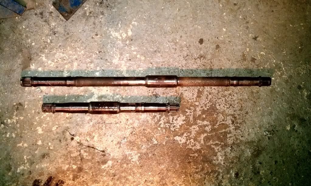

drive shafts made
coil pack mounted with some new leads made

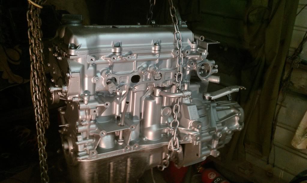

engine painted

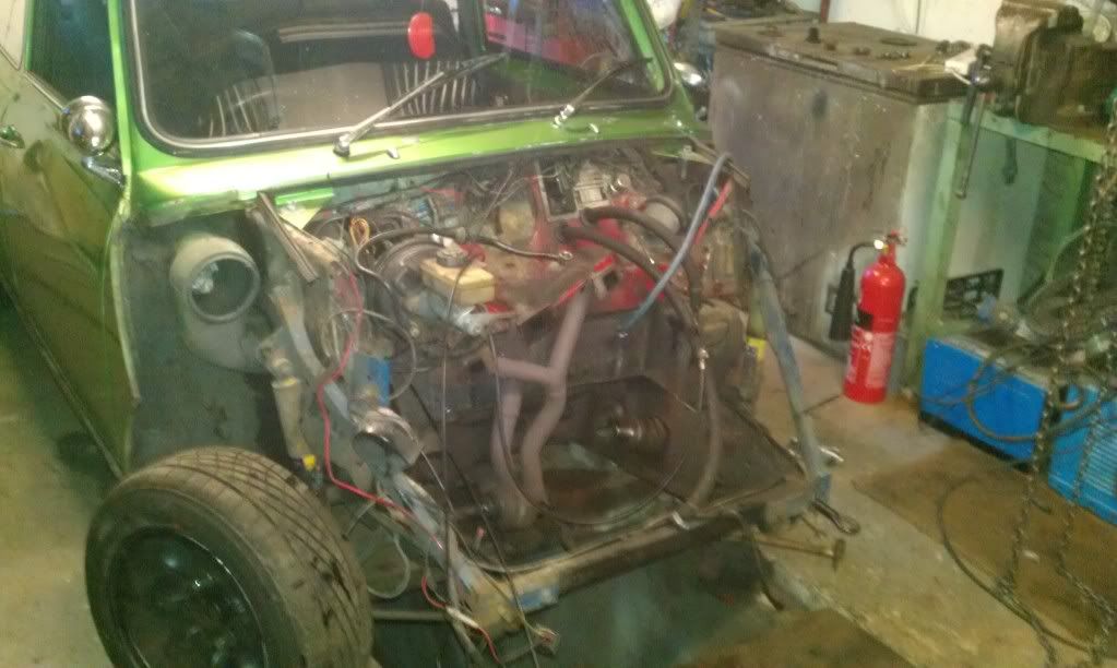

old g-A-y series out

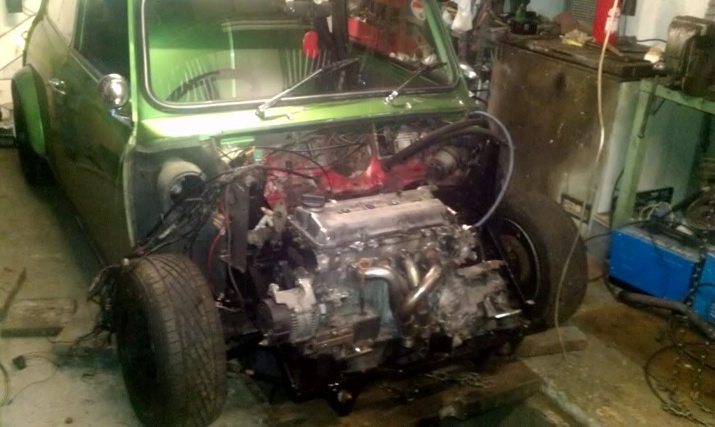

cg10 and new frame in
everything put back together

its runs map, it gives a actual load input rather than just throttle position so much better.

Thanks I decided to ditch the efi and go with what I'm used to which is mappable ignition and carbs, there's nothing like the sound of bike carbs at full throttle.

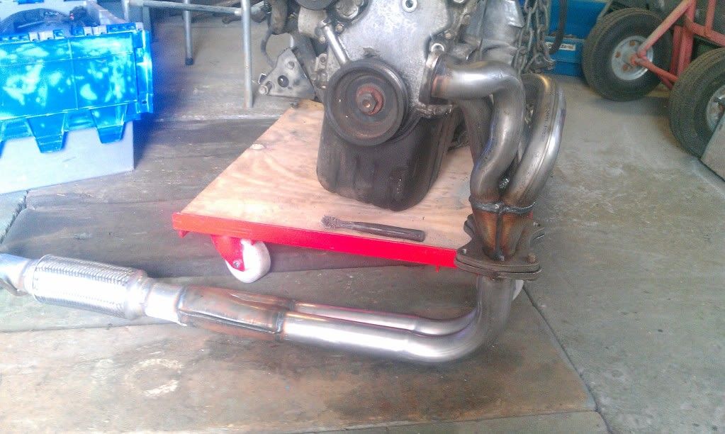

Wasn't that bad as long as you can weld,
Cut runners
Cut flange into 4 sections
Redrill flanges to suit micra
Bolt on flanges
Bend runners to line up
Weld back together

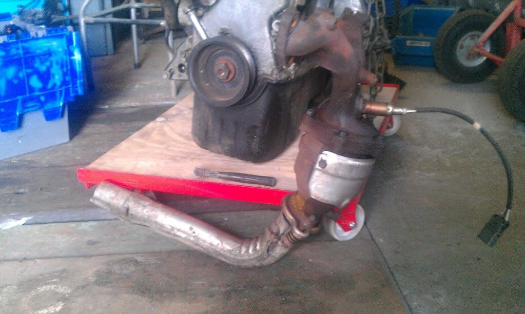

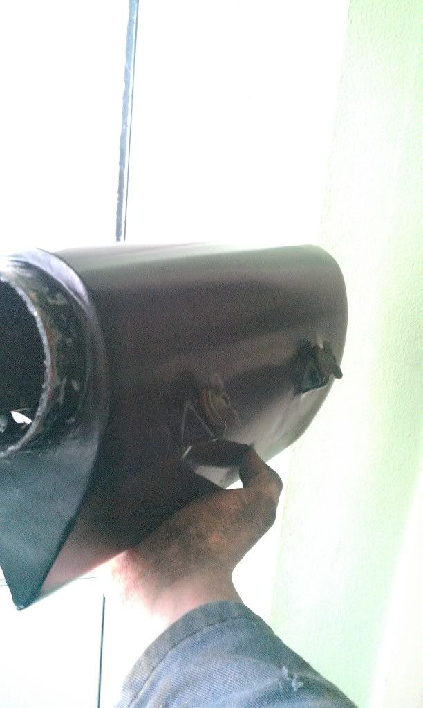

Because there was a limited amount off room in the mini I had to cut off the flange which bolts the manifold to downpipe. Pic shows it before being modified
Vs standard

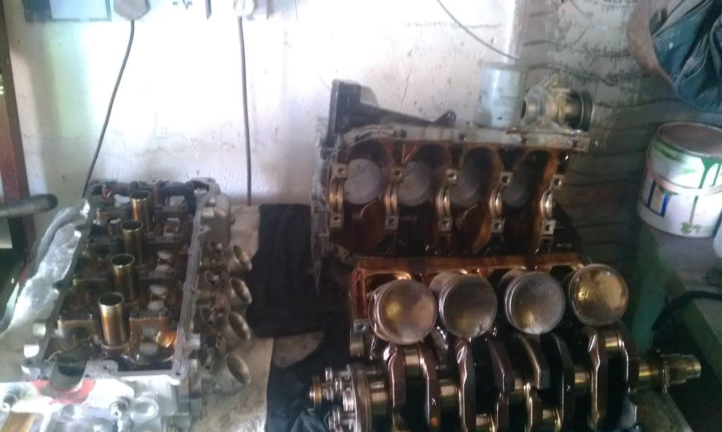

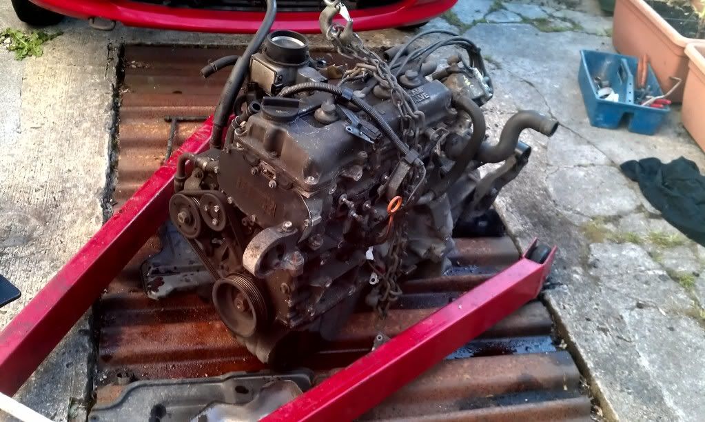

Right then the 1.3 started today after a but of a fight - that's the good news
The bad news being it turns out it has a blown headgasket ( water leaking into a cylinder) and even with it running very hot the compression is 3 bar lower than the minimum allowed. The old tea spoon of oil down the bores confirmed its the cylinders/pistons.
Sooo tomorrows job rip the engine back out

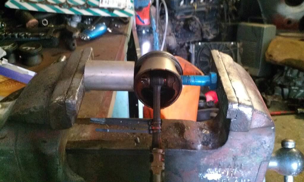

Looks to be a bit of wear on 2 pistons, got to try get a bore gauge on the cylinders but they don't look to good, there's a few scores :-( at least the crank seems to be like new, will get the micrometer on it tomorrow.
New pistons and a rebore should sort it out nicely. Will probably fit flat top pistions :)
