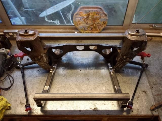

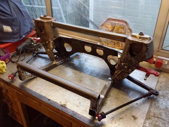

I gave up trying with it and fitted a 1330 A series instead. its developed a massive oil leak so thats got to come out soon too. So on the off chance i sent around some emails asking about the conversion etc and to my surprise was sent the offer of buying a complete conversion. Frame, engine, wiring loom and ancillaries included!
I'm in the process of getting it delivered and figuring out what parts to use etc.
A few issues Ive come up against:
The engine is a 1.0 coil pack, i have a 1.3 non coil pack that id prefer to fit - I've got to change the wiring loom
Subframe is a twin bolt, my shell is a single bolt - got to modify it in some way.
The frame wont allow the standard inlet manifold without cutting the bulkhead - is there an alternative apart from bike carbs? its a tight space!
The standard exhaust manifold is fat and bulky - need to find a way to make more space up front.
Got to cut the inner wings away to squeeze it all in..
