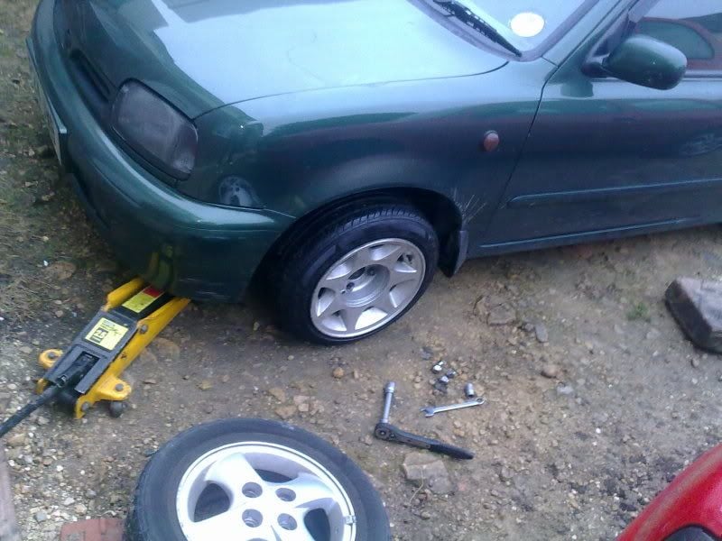

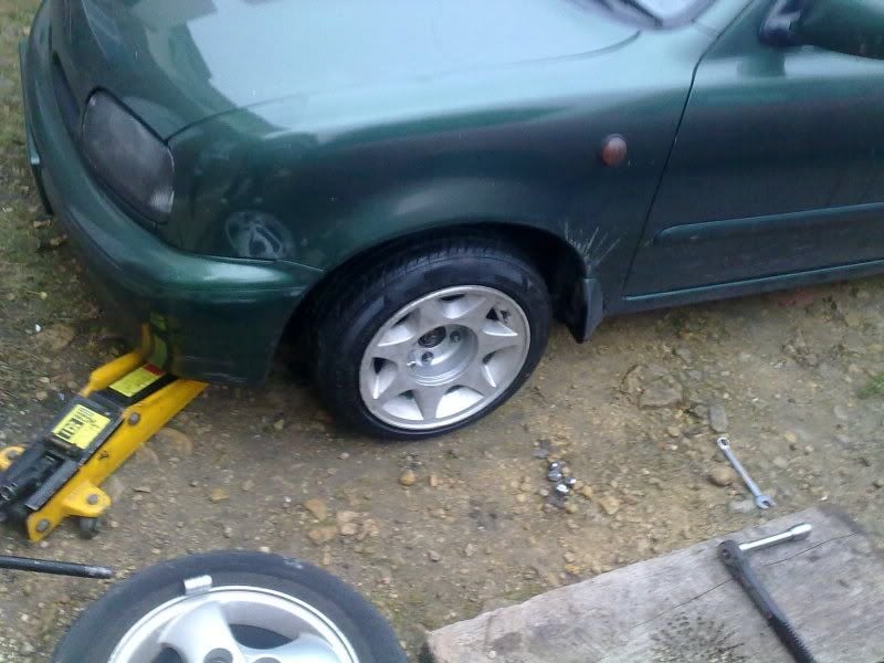

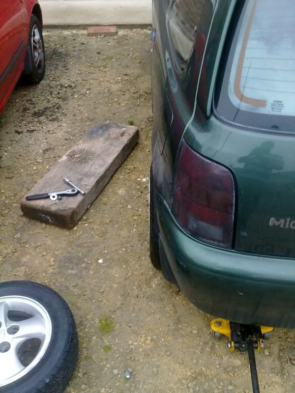

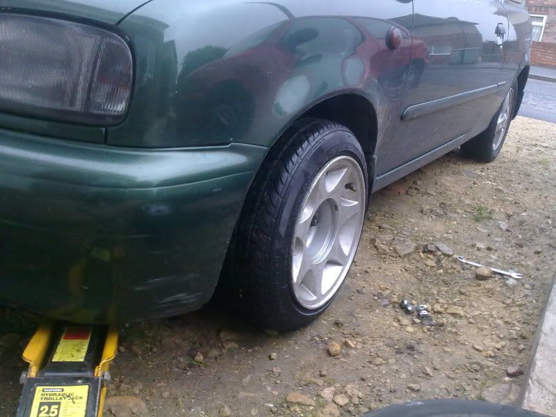

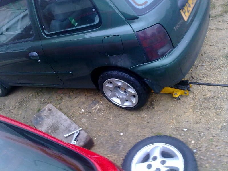

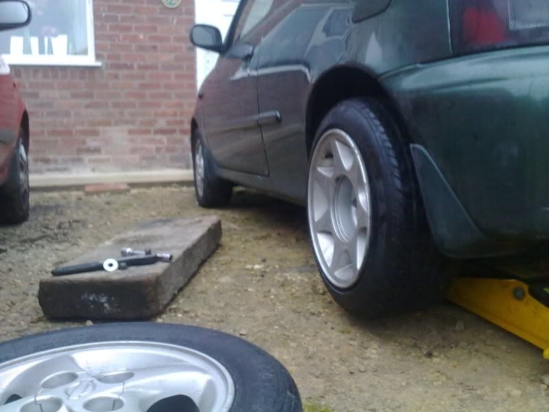

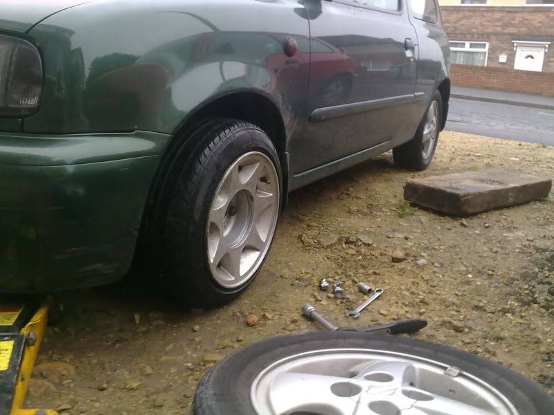

trial fitted a new wheel today, i like it, whats your thoughts? there (it's) 13x7 et+5, the tyre is a 165/55/13.
anyway, pictures say a thousand words and all that.
rear fits perfectly, could do with a bit more poke, 2-3mm ish.
front far too much poke

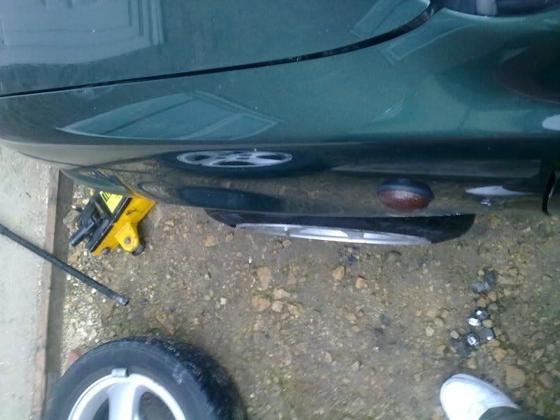

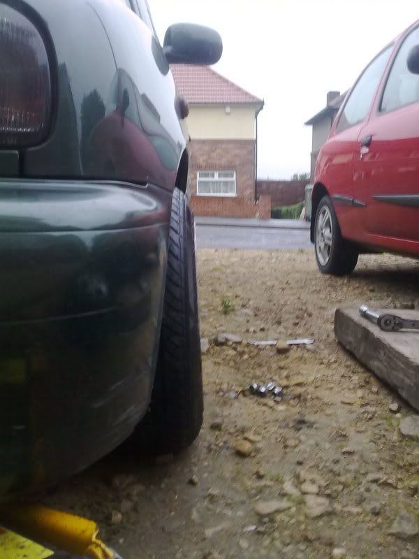

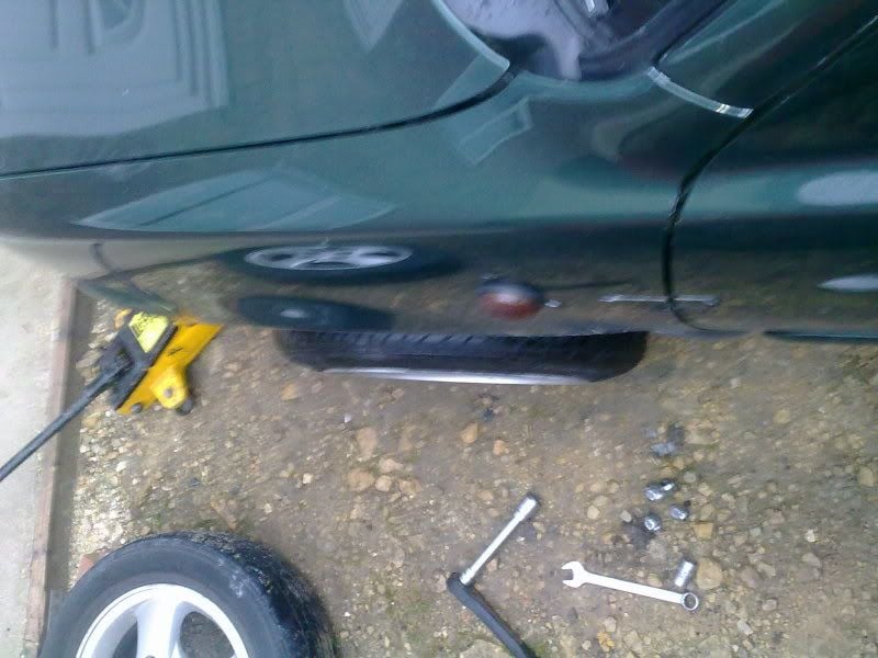

so decided a little negative camber was in order.
you can see the camber better below.
ill be making some centre caps and painting them matt black, overall im happy with how it looks.
to temproarly achieve the camber on the front, i removed the lower strut to hub bolt, slackened the top one and adjusted the angle then tightening it up, ill be making some of them excentric camber bolts in due course.

yeah, i was thinking 2.8i special capper, but 4x108 leads to confusion - low offset from the adaptors? whatever they look the business,(Y)(Y)(Y) keep them silver and sans centres though. get those coils adjusted.
mark looks like i owe you a pound, ill give it you next time i see you, lol
yes they are 108pcd, but no adapters im afraid, the stock offset is et+5, that is only temporary fitted, as it turned out, the stud holes in the wheels are about 15-16mm, so my 4x100 studs just fit through the holes, allowing my to put a washer and a nut on to hold them on, i will be re-drilling them much like you did with yours mark.
the coils will be adjusted in due course, mr angle grinder will be introduced to them at some point.
