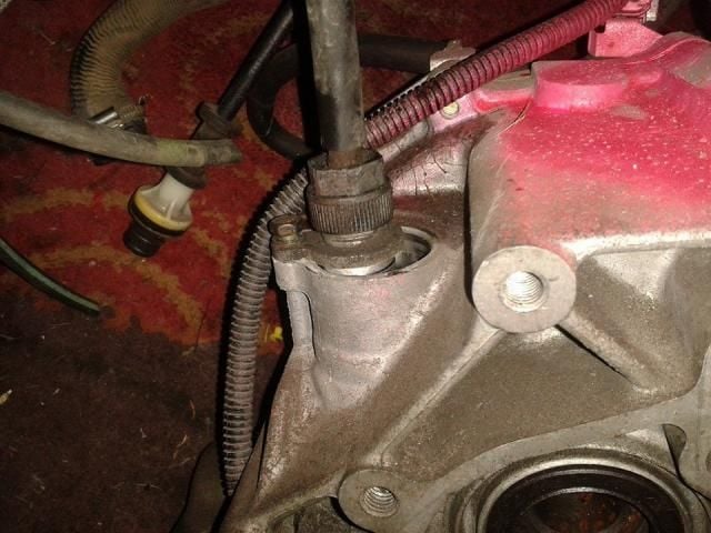

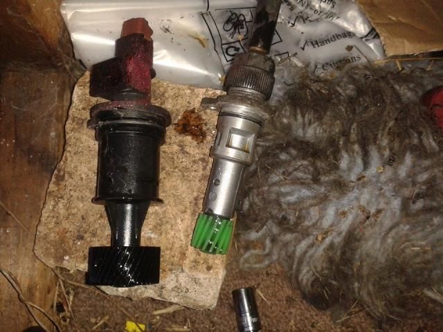

Today i went to swap the speedo cables and something seems wrong.. il let the pictures explain:
What do i do? :/
Edit : i guess its due to the pre facelift / facelift issue?
