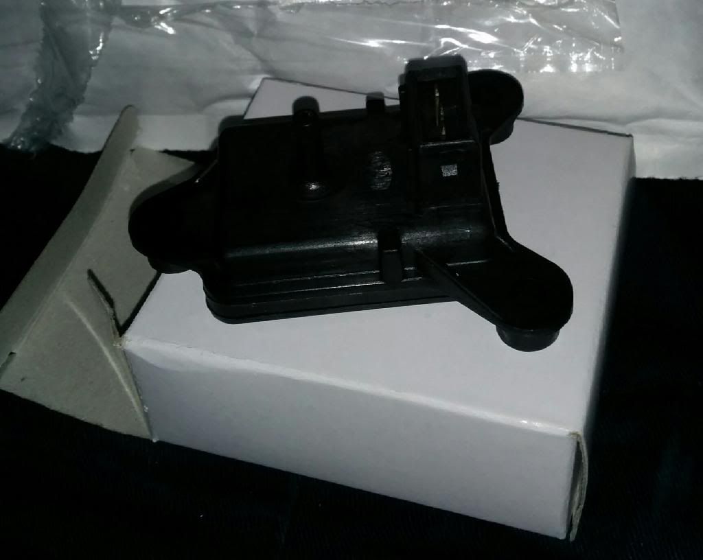

Well my map sensor turned up today :)

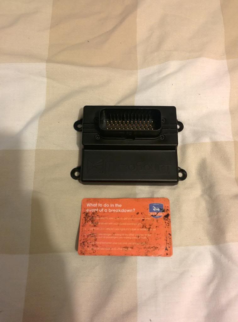

I'll get the ecu Monday. I've paid the import tax :( parcel force are cheeky *insert foul language here* they charge a 13 quid handling fee!
Apparently the way it works is....
Customs decide how much you owe
Parcel force then pay your import Tax for you ( the kind people they are)
Parcel force then hold your package ransom until you pay the import tax plus their handling fee!
If you don't pay in 20 days they send it back

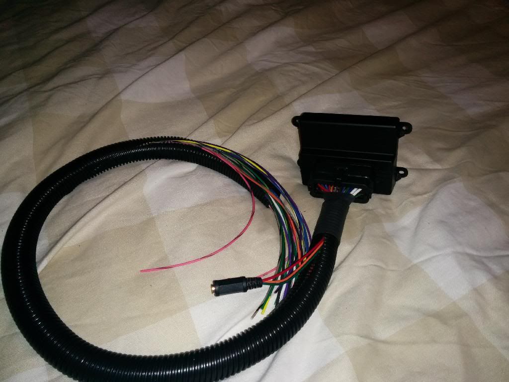

Carried on with the wiring for the ecu today, new fuse box, relays and ecu have all been mounted and the internal wiring completed, just as I moved onto the engine bay the heavens opened so at the moment its left pretty much left like this....
Might try get the wiring finished this week weather permitting. Then it will be just a case of when I'm ready swap the carbs for the ITB'S and fuel pumps over and it should start :confused:

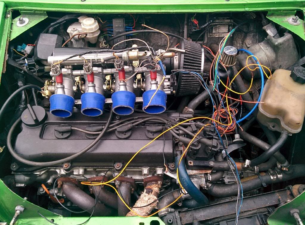

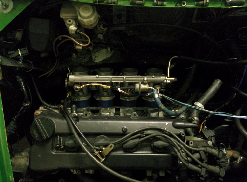

Well I bit the bullet and started to swap bits over, the injection tank is now in place and plumbed in also the carbs got removed and the ITB'S put in their place.
Now it should be a case of swapping 4 wires at the fuse box and it should* start
*crosses fingers and prays.
