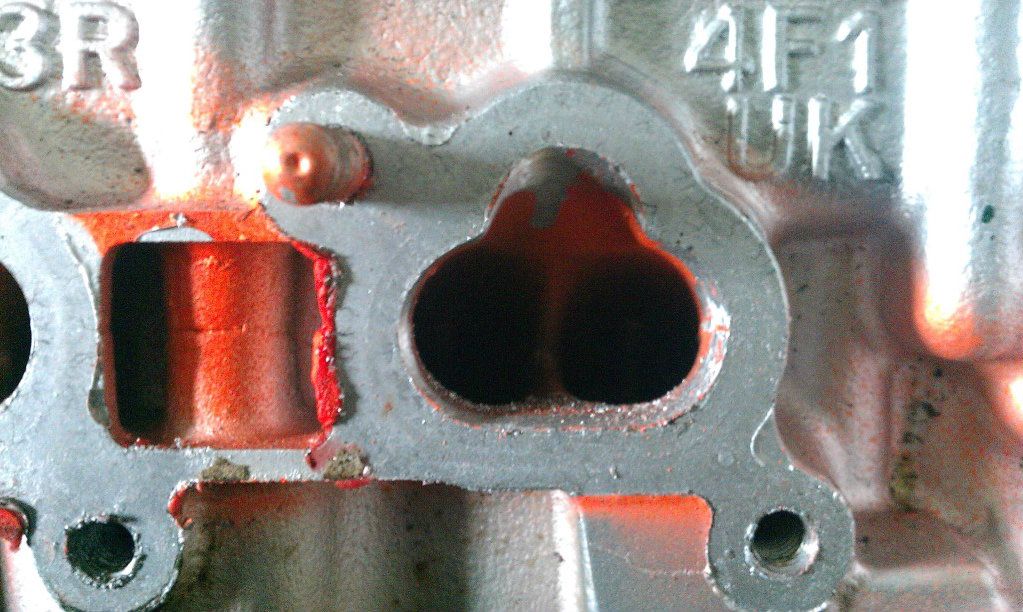

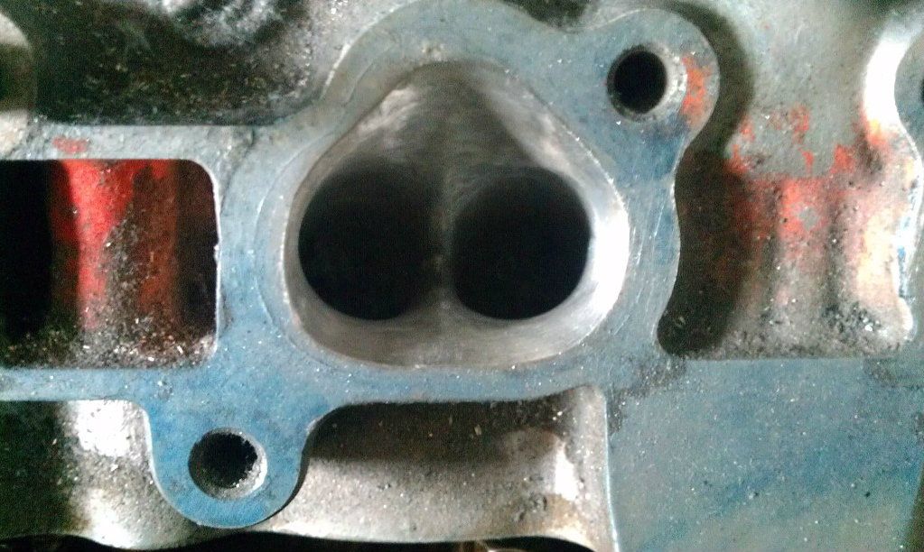

So whilst the block is off having a rebore I was sat looking for something to do and noticed the inlet ports where a bit smaller than the manifold and creating a step. Sooo I opened the ports up a little.
Before
And currently
Still need to smooth it out but the basic shape is there

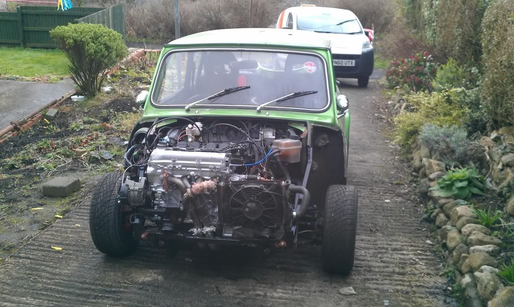

I keep forgetting to update this thread, since the last post the engine has been rebuilt after a rebore and some corsa pistons being fitted.
Hopefully tomorrow will see it leave the garage :)

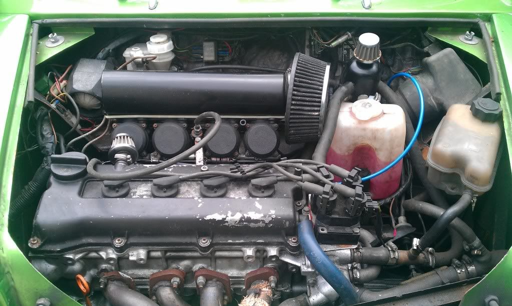

Had half hour spare earlier and I've got a bit fed up of oil vapor from the breather on the rocker cover which collects inside the filter and drips down the back of the engine, so I decided to make an oil catch tank.....
Take one old argon gas bottle and chop the end off
Chop it down to size
Weld on a inlet and vent
Will have to sort through my fittings to find appropriate elbows for a view/level glass then I can weld the top back on.
Pretty much finished off the oil catch tank earlier. Top welded on and 2 elbows fitted to create a level gauge (pipe will be replaced for clear when finished)
Just need to paint and create a small bracket to hold it now.

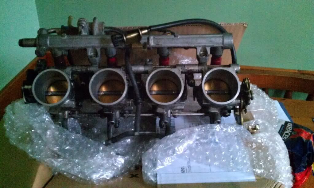

Im currently looking for a set of ITB's so that i can get the most out of the engine, the carbs are great but adjustments via laptop rather than having to remove the carbs each time will make life easier. Also on the look out for some 276 duration cams.

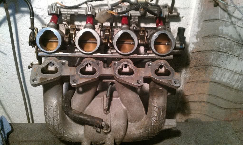

Going to make a new one, the current one is ok but Id like the runners to be a bit longer.
Old manifold is going onto another project I have planned. Im, going to be using Megasquirt for the EFI which will use all the ford side of the Megajolt system, and I'll be keeping the ECU for the other project as well
looks like the port spacing is pretty close
