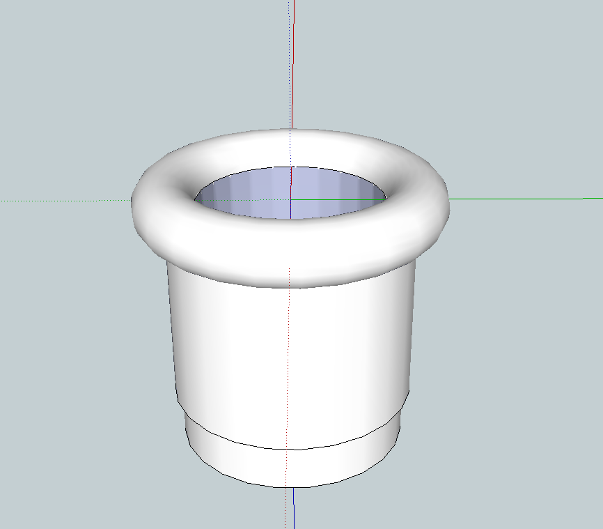

Today has been spent thinking about improving the driveability with the ITB's. Looking at the data logs its reaching WOT at just over 30% throttle which confirms the ITB's are oversized.
Currently I'm not running any velocity stacks sooo my first option is to make some velocity stacks but I'm planning a slight change to normal as they will insert into the ITB's and hopefully the reduced inlet size and extra length will improve things.
Quick drawing to get an idea
If that doesn't help I'll pick up some smaller ITB's
that should move wot higher up eh :) moving the high vacuum area upstream might upset the resolution at part throttle tho ?
