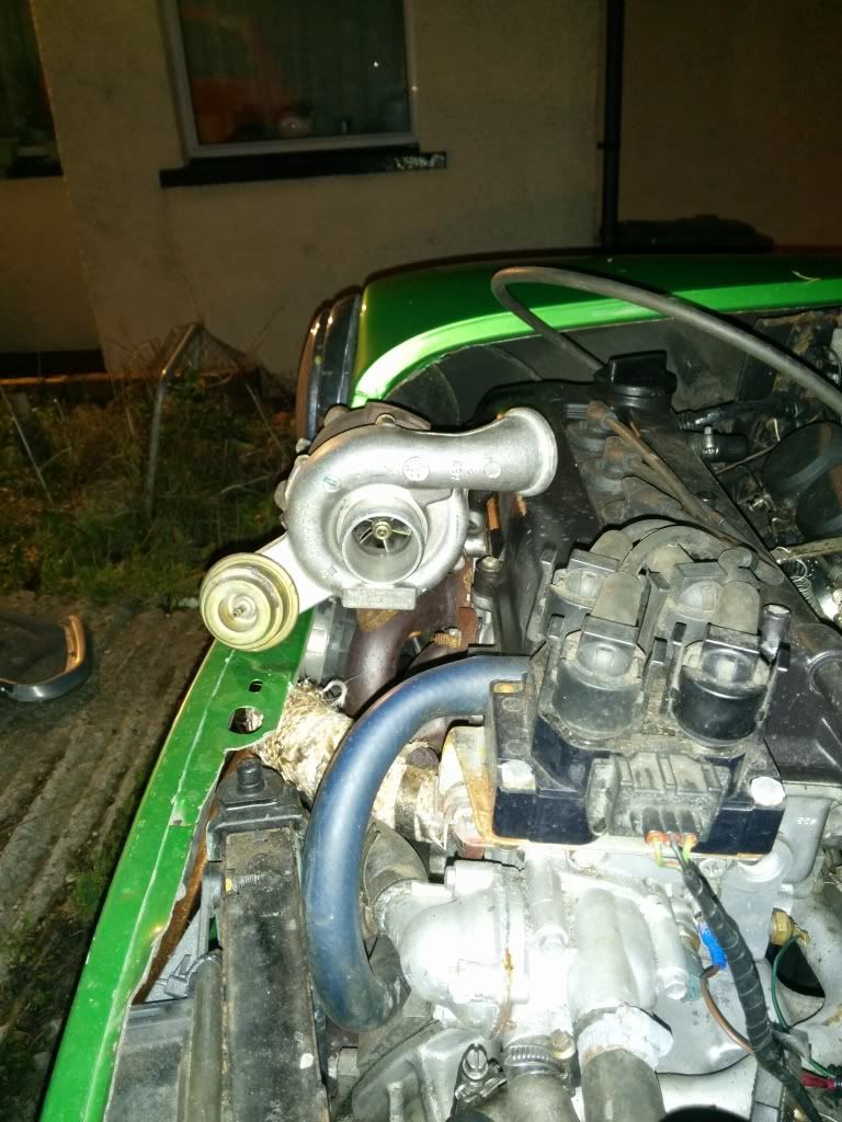

mini with a little bit of micra

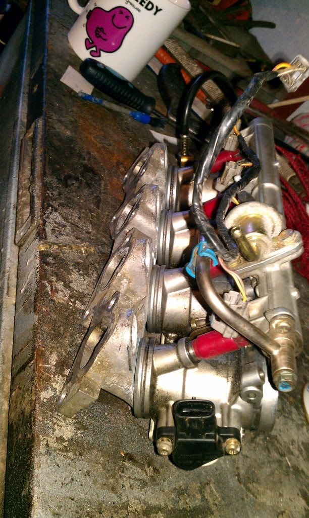

Mmm so tempting! Mind you i dont know about running without tps working, or if the injectors will run with micra ecu... Bookmarking and research time methinks :)
These have a TPS :D
I'd be tempted to try make them work with the micra ecu as a challenge but I threw the loom out.
Injectors I'm not sure but I'd imagine there's some available that would suit. I think these have a 240cc flow rating. Also they would need to have a air box made with the MAF sensor on the inlet.

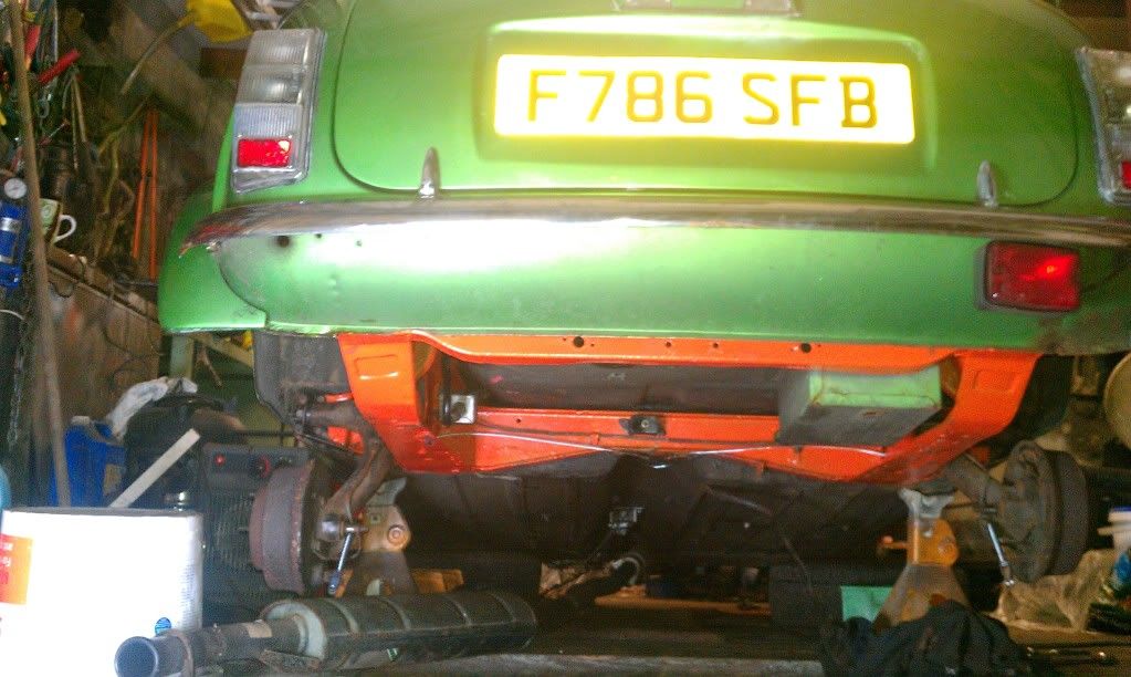

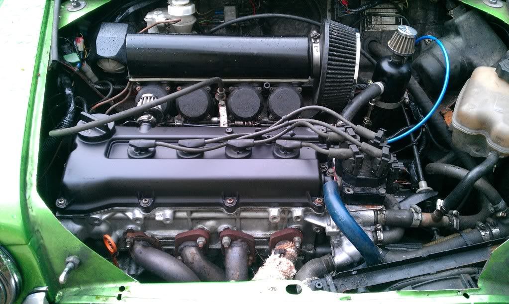

Got a show the weekend so im thinking of changing the colour of the cam cover
my mate suggested the same orange as the rear subframe
but im not sure
any other suggestions ?

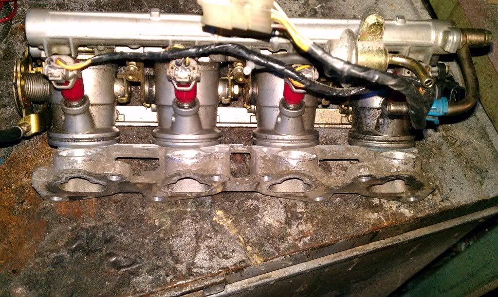

Finished cutting up the micra manifold and tubing ready to make the new inlet manifold for the ITB's, will try drop it off tomorrow to get welded
Also got bored and started drawing what I want bog brothers to make me in the future
Picked up my temporary manifold today
Just need to do some porting now

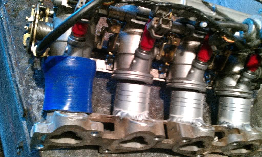

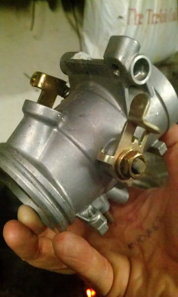

Just had a nice surprise, turns out there's just enough stretch (after being warmed in a bowl of boiling water ;) ) in the silicone pipe I'm already using to go over the larger throttle bodies. That saves me sourcing some reduction sections :D

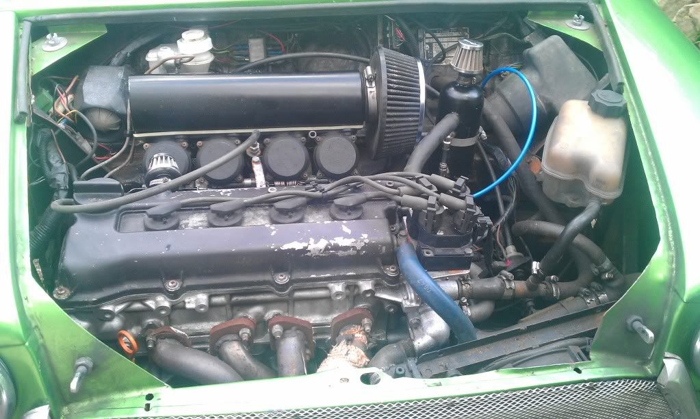

Also I give my old cam cover a lick of paint and swapped it back over

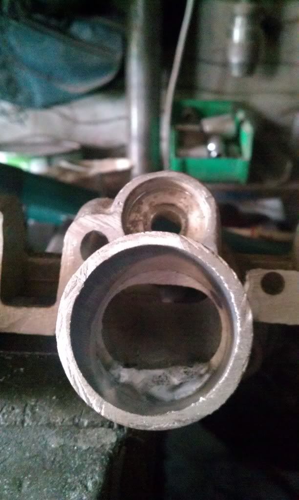

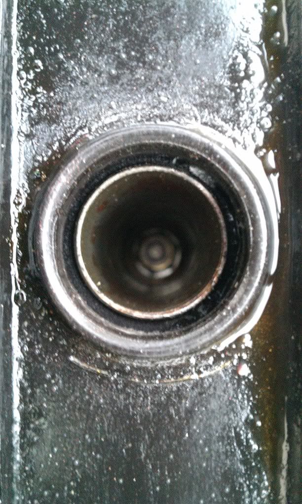

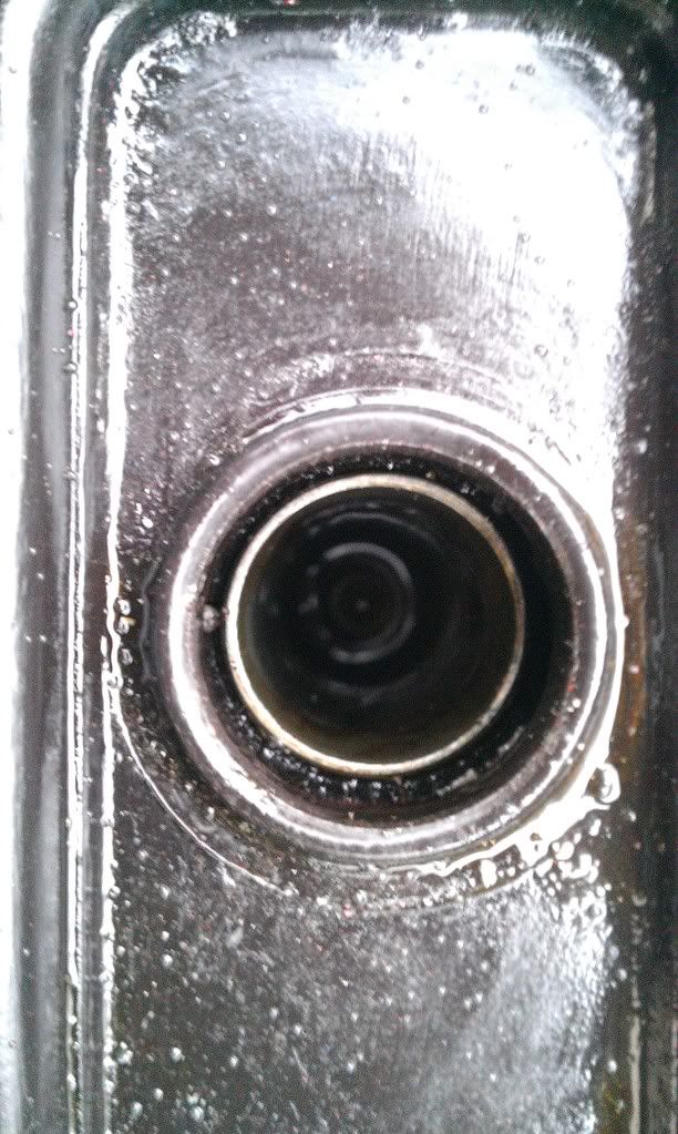

Here's what i found...
spark plug tubes on 2&3 nice and clean
tubes 1&4 covered in oil with a 10mm deep puddle in the bottom :(

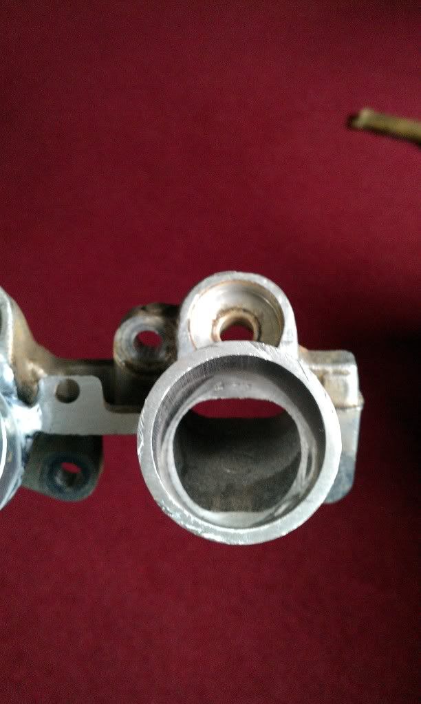

Not really had a chance to play with the mini recently also I managed to lose my rotary burrs so could not port the new manifold :( but over the weekend I bought a new set so after a few min of work I've got the basic shape of the runners sorted
Before
After

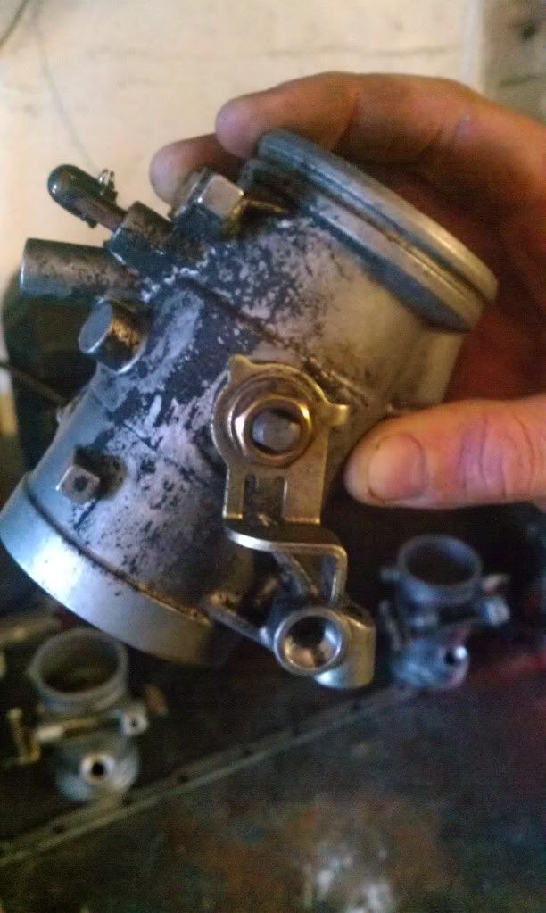

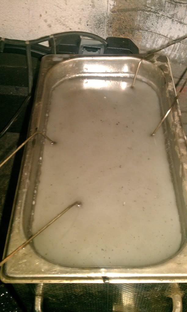

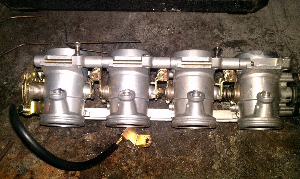

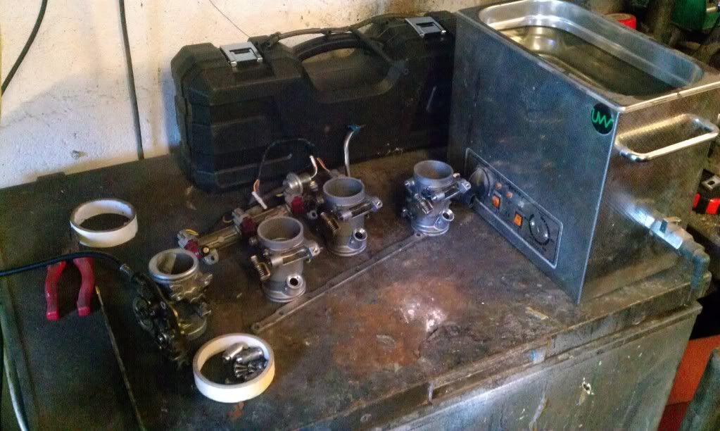

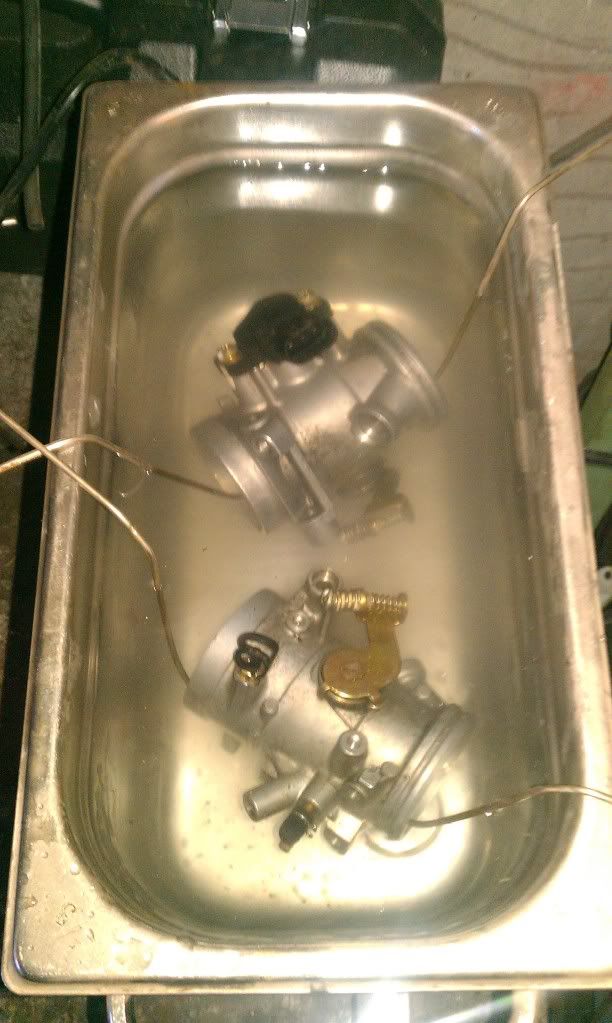

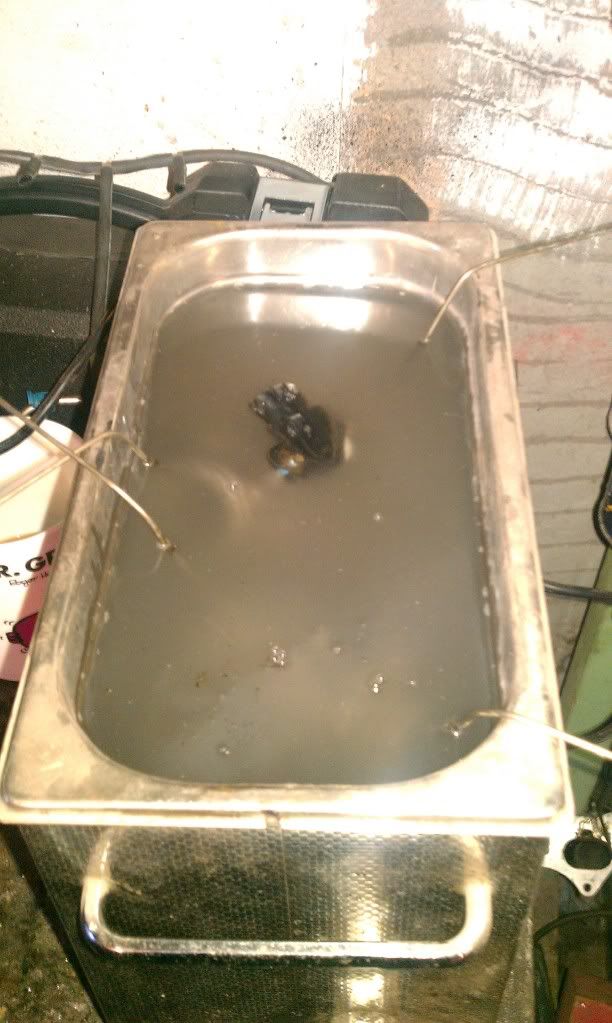

I thought I'd give the throttle bodies a dip in the ultrasonic cleaner before they get fitted
Broken down into component parts
Pretty clean to start with
After 5 min
After 15 min
After 30
Then built back up

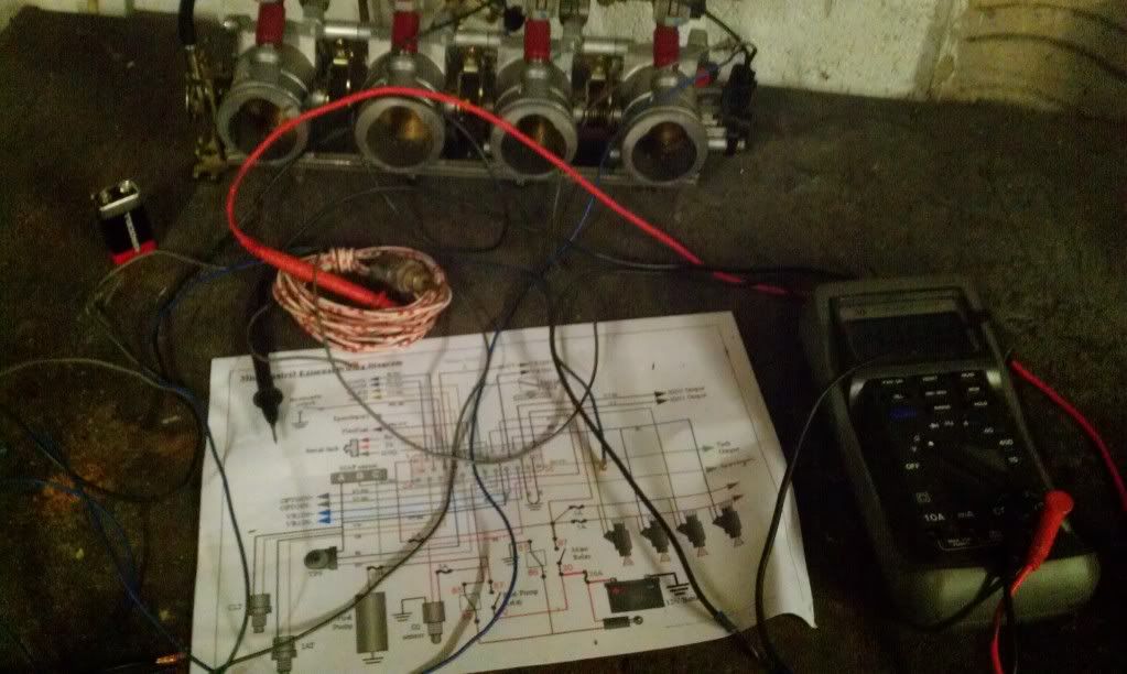

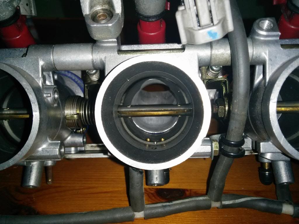

started sorting out sensors and associated wiring for the conversion to injection
seems simple enough :-S :-/

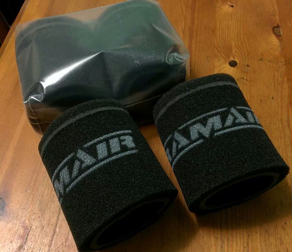

Finally bit the bullet and started spending money ready for the swap to efi. Just bought some sock filters for the ITB's. I'm hoping that if I wait a few weeks I might be able to pick up a microsquirt ecu cheaper in the post Xmas sales.
I had planned on building another air box but the socks won out in the end to their ease of fitment

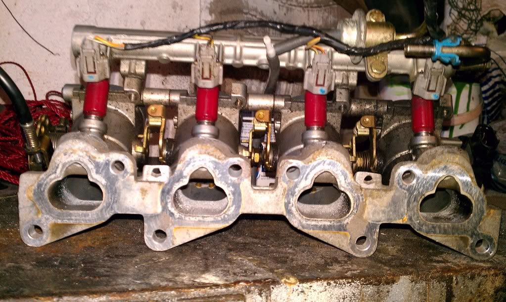

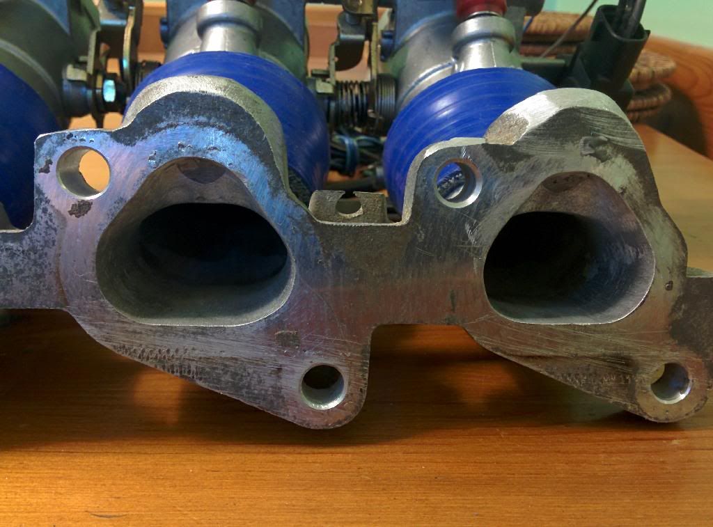

Finally finished the new inlet manifold today, a total of 6 hours of porting and polishing mainly by hand ( I've actually worn skin away from my fingers) Have resulted in ports that are about 20% larger than when I started and now it has nice free flowing smooth bores.
We have a flow bench in work that's used for working out water flow in mains/valves etc so I might see if I can try mount the manifold on it and compare it to a standard manifold.
