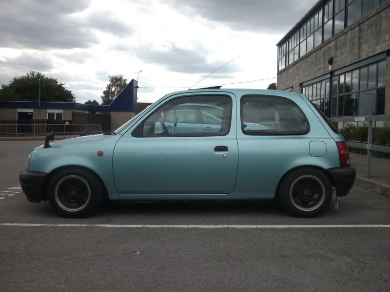

Mark's 1.0LX
That sits luvly! Great work Mark, im confident you'll make it work :D
are they the 8j -10 offset ones from futher up the thread tho mark?
Yeah they are the same ones - I probably made a mistake with the offset up there. They are stamped 0.5 out (or 13mm ish). Though I'm sure when I actually measured them they were slightly different. Its not enough to make a huge difference to how the wheel would sit relative to the arch. The axle isn't dead centre either, its evened up with a spacer one side but that is still the side with the biggest gap.
I'm not conviced that they would suit it, on a solid colour they would work, with more motorspot type influences in the styling. I'm stuck with this mettalic, that is rather nice but not a race car colour or finish and will be blooming hard to match/fade in if I wreck the arches.
I went back to black centres after my play with gold, the eights are both painted and I'm going to try and get the sevens done this week so that I can get some tyres on them and hopefully start running them on the rear for the time being.
mark mate that looks awesome!!make it fit!heat the paint roller it properly and gentley it will be fine,
worst case with the paint is your have to buy a $4.28 can of officail nissan one coat spray paint
ultralite do a roller for 190, buy it and sell it or ask on retro rides, some one will rent you out one for cheap
falling that, heat gun hammer and scaffold bar,it worked for me without damage mate :) but whatever you do, you have to keep them on!

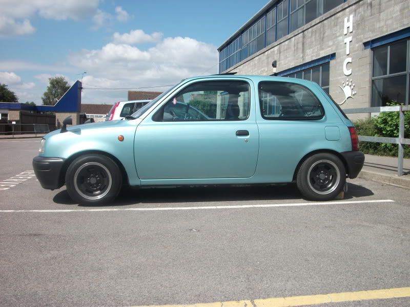

I had a little play with the car today. I made a subtle change.
Before,
After,

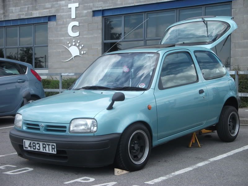

I took another coil off the front - thats 3.5 off the front and just over half of of the rear - so I suppose they are at about 2.75 off.
I also wired both ends of the front springs into the cups because I was never happy with just the tops wired. I also made up some droop straps for the rear, so now that end stays nicely located when jacked up as well.
With the car's weight on the suspension:
Its close to the exhaust on the off side, but i've now tied it out of the way with a cable tie, if the suspension was unloaded the cable tie would break and support the axle like so:
On the inside:
The straps are fixed through the boot floor, not ideal, but the fixing point is very close to the chassis rail each side in thhe corner formed by a cross member so its nice and strong, with the big washers spreading the load nicely.
While working I wondered if side pipes and a brake light on the axle is the way I should be going with this?
Cheers guys.
Its got a bit of intentional rake in that pic, so that it sits about level with a full tank of fuel and some stuff in the back. If I find that it doesn't generally sit about right I shall just have to have another half coil off the back to even it out.

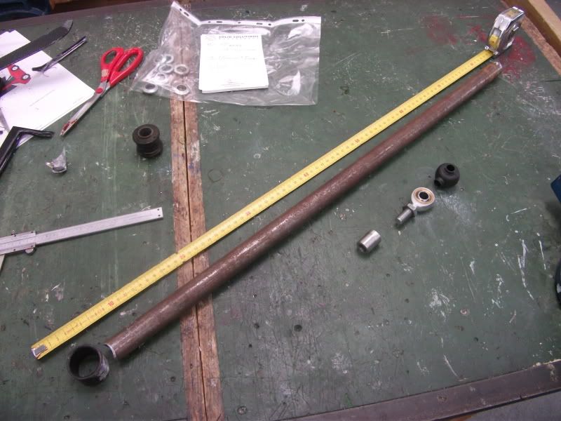

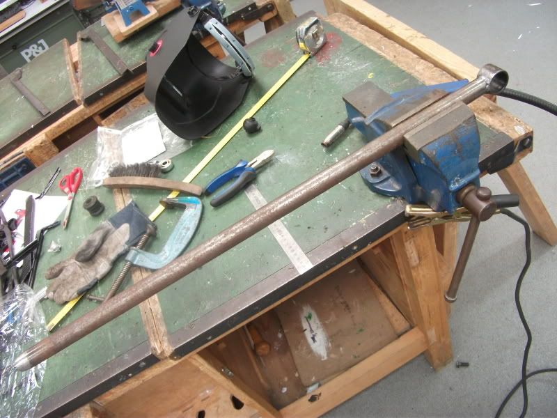

I got another couple of hours this morning. After a bit of measuring I set to work on an adjustable panhard rod.

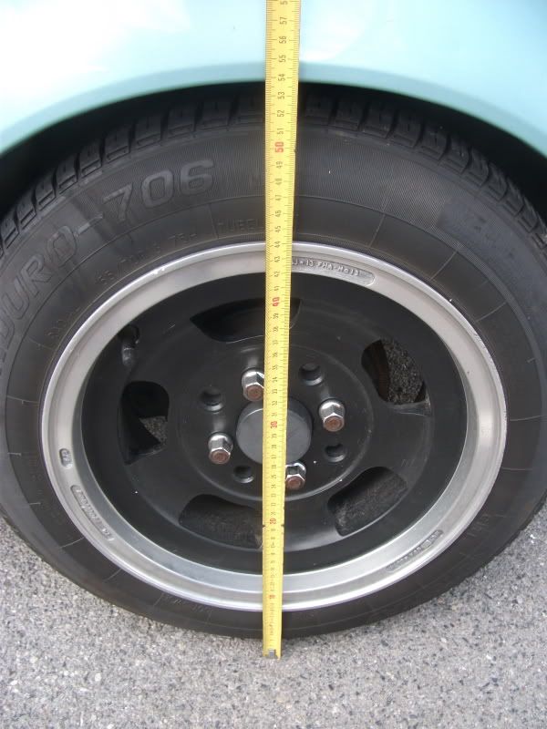

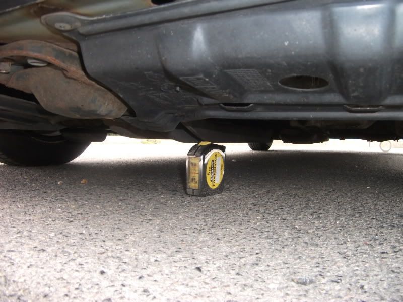

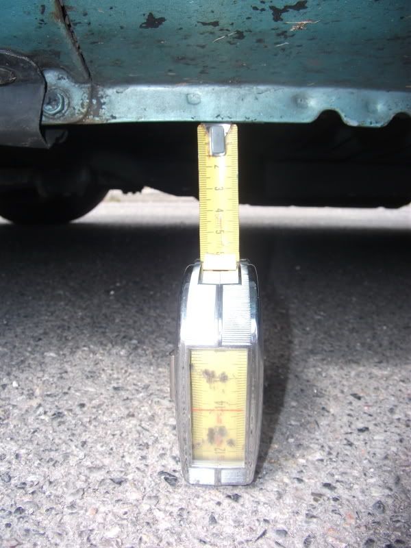

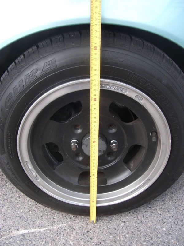

Ride height - Not that low. I'm still not really bothering the speed bumps into school. Must try Harder.
Front
Rear
Engine support member
Front sill 140mm
Rear sill 145mm
Panhard rod bits, some pipe, fishmouthed on one end, the large bush eye from a stock panhard rod, an M12 rose joint, M12 threaded insert and an M12 half nut (well full nut actually, turned down to a half nut).
Welded together
It's just recieved a coat of hammerite, unfortunately I've run out of tinker time today so I'll have to wait to have a go at fitting after I've pressed the bush back in at somepoint, probably next week. I'll probably need to turn up some tapered washers to fit the rod end into the space previously occupied by the bush on the body end.
Then its some more machining to make some spigot rings and eccentric sleeves for the studs so that I can get the 7" wide slots on the back, and probably a ghetto arch rolling as well.
I decided on a mid adjustment length of around 815mm for the panhard rod. The stock rod is 820mm. I had 10mm difference between the wheel placement in the arch left to right, so half that should have the wheels in the centre, with adjustment each way for fine tuning.

Have you not got an adjustable already - has you panhard rod gone past horizontal and started pulling the axle back in line or is it at its longest - about 15mm wheel to arch difference between the NS and OS?
Lolz, maybe you have a smaller tape measure. The one I used was pretty large. I'll have to use something with a more easily replicated size (or prehaps get an actual measurement :) ).
No. I havent got one yet but I do need one. My rod is at its longest atm. Looks absolutely horizontal to me. I just dont wanna spend 100 odd quid for a technically "steel pipe".

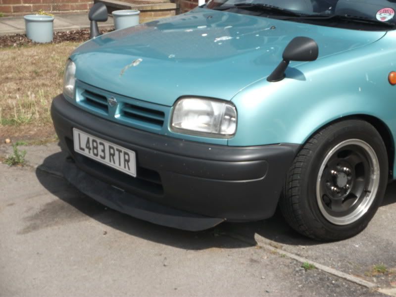

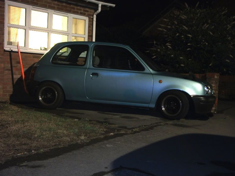

Just some more pics to illustrate that the only modifications I've made since the last set was washing the dirt off.
Current plans involve something like this happening,
Is it bad that i want to copy pretty much everything you do to your car? (don't worry, i wont!) Love it and love the splitter idea, proper retro. Also, are those new reg plates i spy?
Is it bad? I dont know. I would be nothing but flattered if you did.
Yeah there's a new plate on the front, I got a pair of plates made up at the Retro Show at Santa Pod the other weekend. A standard plate for the front and an import size rear, for fitting between march nipples. I'm not overly impressed with the quality the front is OK so that went on to neaten the front up. I wish I had asked for standard black letters not the 3D and I should have got them done in original charls wright not the new font. All in a bit of a waste of £20 because I have decided that I'm probably never going to get round to fitting the March nipples as I dont want to have to do the paintwork involved.

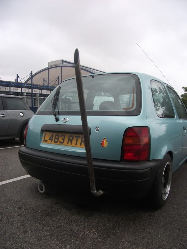

Nice Bosozoku. Did you paint it red because of cops? Id love to go to the gathering but its just a bit far. And post 1990 cant go on proper stand or something like that :(
Cheers. It's painted (orange - just because I like it) because I didn't have any stainless tube to polish nice and shiney (and being inherently a pit lazy it was easier). I've also noticed that a lot of the actual boso cars have painted exhausts. Post '90 is ok if you were booked on a stand or with a club. A bit far? the furthest travelled award went to a chap from Finland who had driven over in a Citroen GS!
