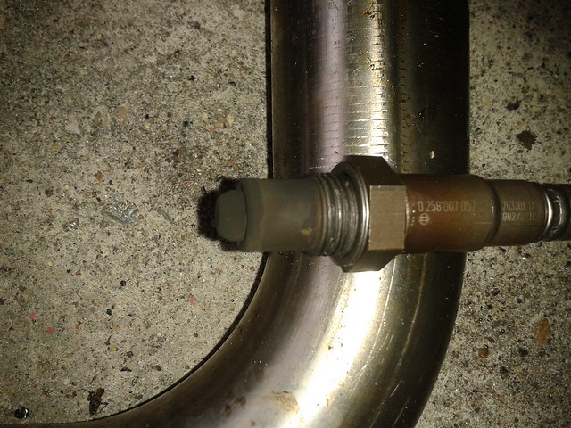

None of the 3 wires on the lambda would work :s its working ok plugged into pin 105 in the ecu though - I think. Results showing it runs lean at cruise until about 60mph then it goes off the scale lean at anything above it. Or if the throttles 3/4 open or more its off the scale lean. (edit: no, pin 105 appears to run <0.2v when at idle and cruise, then jumps to 13v> at WOT or lean perhaps. And the voltmeter says the black lambda wire works, but the gauge doesn't appear to agree:rolleyes:)

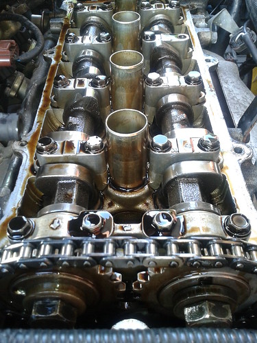

In the search for more I installed the reground exhaust cam and undershim buckets, had to settle with .45mm clearence which was a little noisey:eek:
The performance was poor though, akin to stock cg10 cams I think.
So that exhaust cam was removed and I fitted a cg10 one.
Performance was slightly better low down but then it hit a wall at about 5000rpm.
So in the end I swapped back to the CG13 exhaust cam.
Which is clearly the best choice, it's better everwhere on the rpm scale, except when it bogs down at around 1000rpm.
I've now advanced the inlet cam roughly 3* by filing a sprocket.
That additional advance has now pulled the powerband down and smoothed it out nicely, so it's a little more comfortable as a daily driver now, I keep forgeting it's only a 1.0 litre.:) But I still need more.

Do you have any advice for someone attempting to swap cams for the 1st time? I have had a set of 1.3 cams sitting around for a year now and havent had the bottle to try it yet!!
Hi there,
Apart from the usual guides and how to's..
I'd advise you to mark the positions of the cam, sprocket and chain very clearly, as putting them in one tooth out is quite easy imo:oops:
Don't drop the sprocket washer, it can be a nightmare to fish out, a rag stuffed underneath the sprockets will help save things.
Loosen the tensioner to aid putting the chain back on, I personally just press it in with a screwdriver.
Do the inlet cam first and try it out, that exhaust cam can change the powerband quite a bit.
It's dead simple when done correctly. Your not going to get masses of power, but you feel like you've got back what Nissan took, and it's very worth while.

Wideband O2 sensor and the 2 cherrybombs.

MTX-L wideband. With lambda unplugged, stock injectors, speedsensor cut, I'm getting 13:1 at cruise but there is a 15:1 sweetspot, 12:1 under acceleration leaning out gradually as boost rises to 17:1 at about 6psi.
