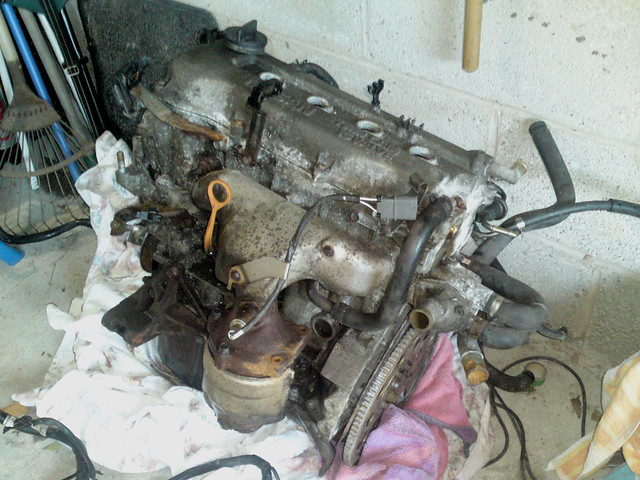

Have been working on the spare engine instead.
Completely stripped the head, bathed in dilluted bleach and detergent. Worked well, came out shiney.

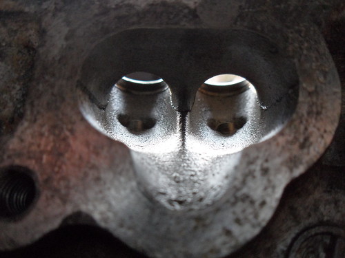

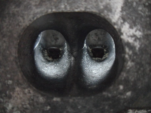

Started to give it a light port and polish treatment, diy style, in the manner of "you never know 'till you try it out". Have read from various sources that you can't really go wrong with porting on a turbo engine, so nothing much to loose. It is starting to really come out well though, if I do say so myself.
before:
inlet:
exhaust:
during(now):
inlet:
exhaust:
Exhaust ports need some more work, trying not to remove too much material, just casting marks and those ugly steps, that's an awkward spot to reach though.

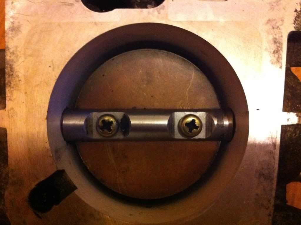

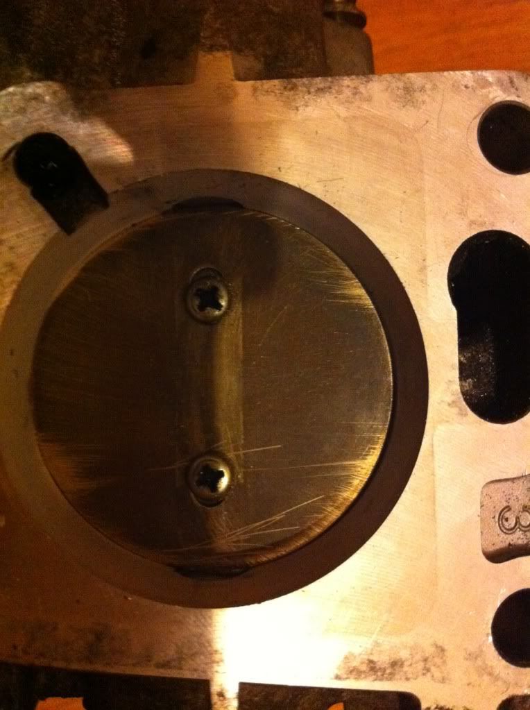

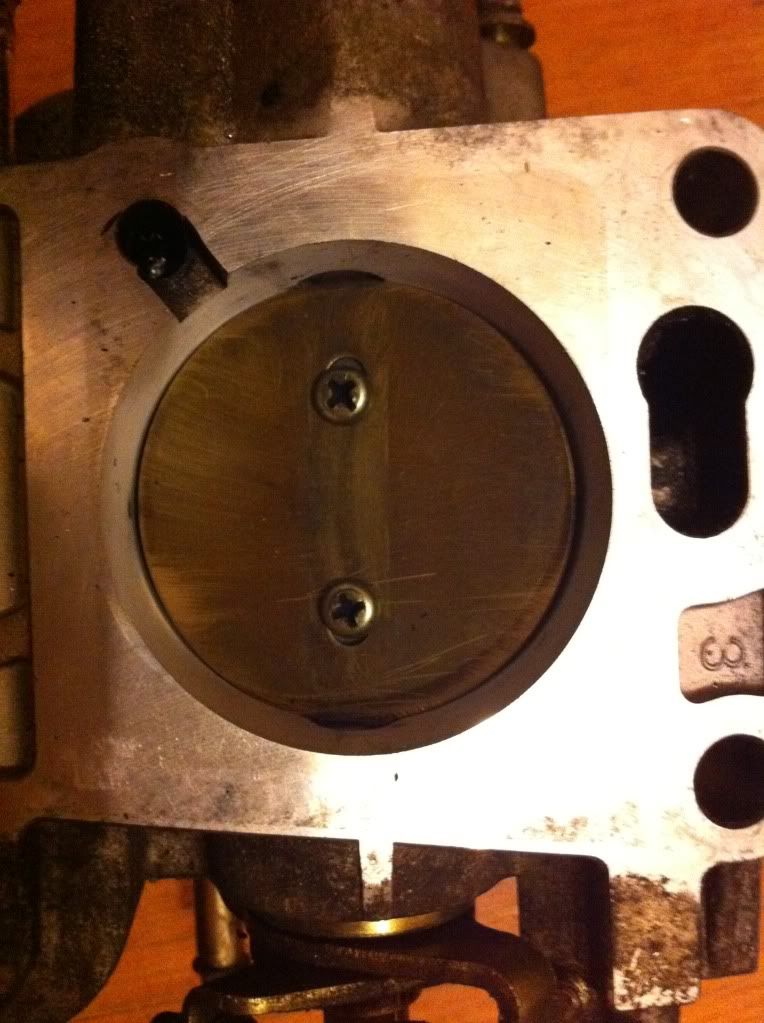

Just started to custom fit a 50mm throttle butterfly into the 45mm Micras throttle body. May post up a detailed guide if successfull. I'm doing it this way as opposed to sticking on a ga16 t/b in order to keep the idle control, and I can also remove the maf and replace it with a sr20 one upstream for a smoother air flow. And because it was all spare.
