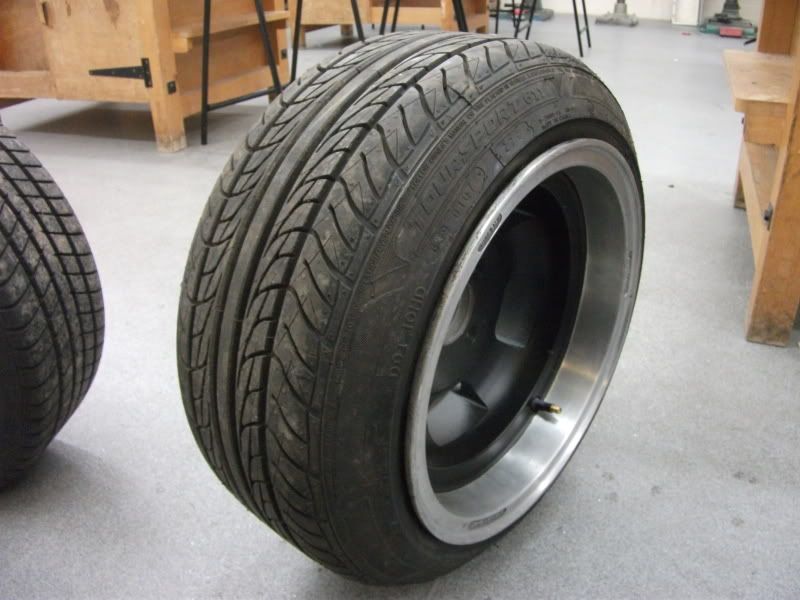

Not sure really. I think that the lighter fluid just burnt slowly, rather than evapourating and exploding. Prehaps I just didn't have enough in there. I'll have to give it a try with something else, maybe the easystart or prehaps the butane mix in my blow torch.
i cant see the pics cos im at work, but i assume you blowing a tyre on?
if so try this ive never failed with it
parts needed
cheap A55 deodrant,
blow torch is best but lighter will do
light the blowtorch,
spray about 3 seconds worth of deodrent in the tyre, pull the can back a foot ot so still spraying and put the blow torch infront of the trye, it will light the spray, and boom tyre on.
Hairspray works every time I tried it, stand back and don't wear shorts!!
Spray inside the tyre not just the bead, takes 5 seconds per tyre,
Then light the hairspray like flame thrower with lighter :)
Total cost ....... = Free!! Just don't tell the missus you stole it !!
Pop!
No video, just thought I'd have a quick go at lunchtime, and pop on it went. I think I might have been using too much fuel, and driving out the oxygen....or something. I also sat the wheel on another tyre, so that might have helped seal the bottom.
Yeah, its kinda fun, but there's no way I actually have the balls to run with that much stretch on a daily basis. Thats the 165/55's on an 8" on the back. So now I'm thinking, as I have before that the only real way forward is to run with the 7's on the back and a pair of 6's on the front, with either 145/60s with comparable stretch to the rear or unstretched 165/55s which will look a bit pants but will probably be better for the driving experience!

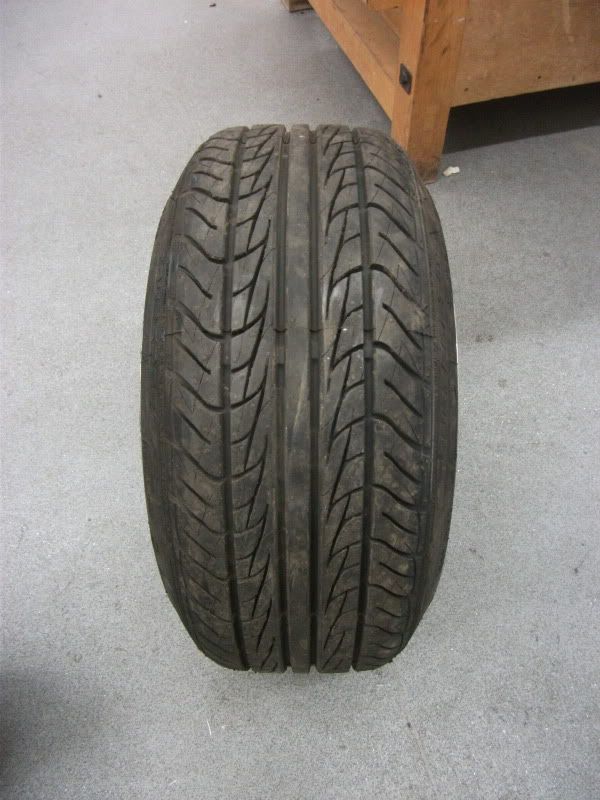

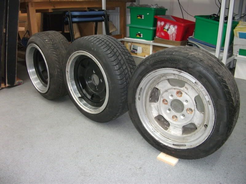

This week I have mainly been thinking about tyres. 165/55s to be precise.

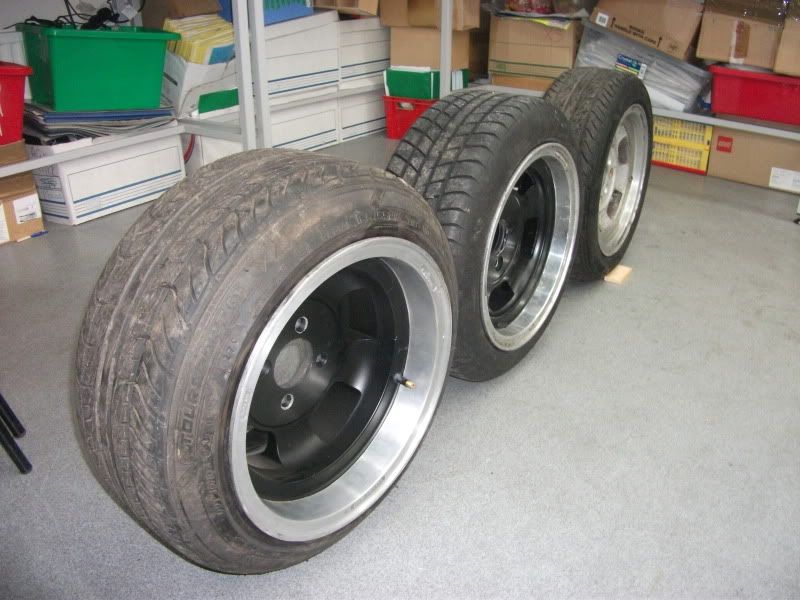

L-R 8", 7", 6"

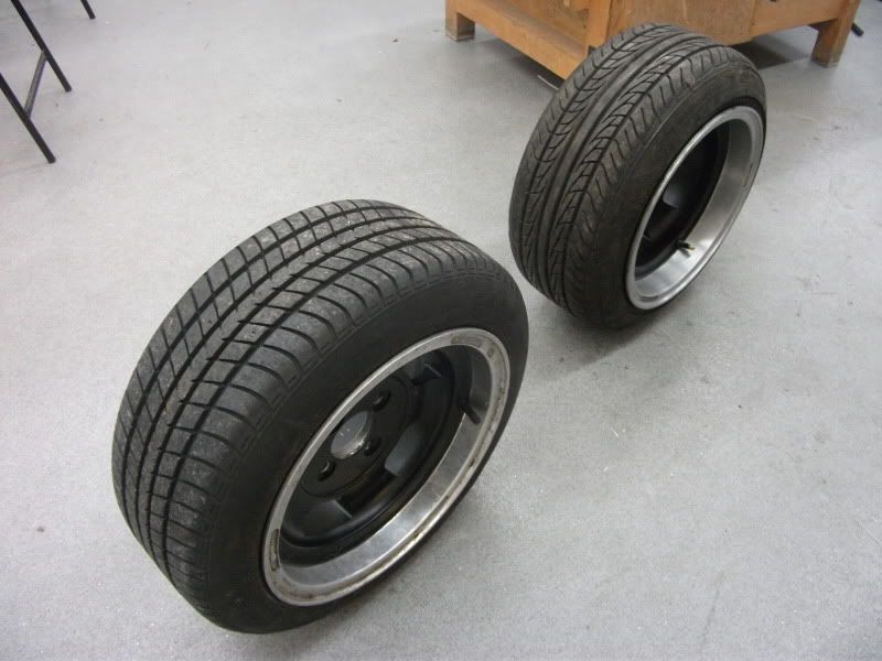

From the other end,
I'm committed to going with 165/55s at both ends now, rather than those on the 7's and 145/60's on the 6's. The load rating of the 145's available is a bit iffy really.
I'll still have to put up with having the bit of stretch / no stretch at all difference front to rear this way, but working at the lowliest budget end of the modding spectrum compromises have to be made.
I'm booked in my friendly local tyre shop for a pair of 165's for the front tomorrow afternoon. the 7's have part worns on already so I need to pull my finger out and do some machining to get them on properly.

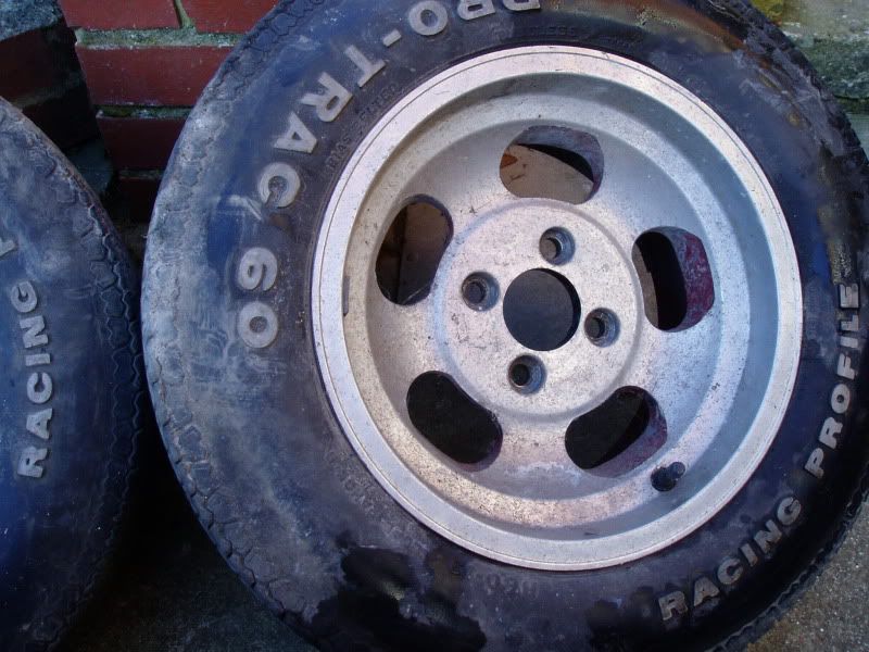

The wheels are Wolfrace, known as Slot Mags. Usually seen fully polished on hot rod/street machine type cars and Often seen on 70's fords.
I have 5x 6" wide ones, these were originally 4x120 and have been re drilled to 4x100 between the original stud holes - These are the ones on my car plus that spare one that I chucked a scrap 165 on to see what it looked like. I also have a pair of 7" wide in 4x4", and the pair of 8" that were originally 4x108, which I've drilled to 4x100 (see further back in my blog). I bought the pairs because they turned up at the right price. I had hoped that the 8"s were a high enough ofset to fit a bit better on the rear, while waiting for the 7's to crop up.
Unfortunately all the wheels are made with the same back space, so each increase in width pushes them an inch further out.
If only I had a another pair of 7's, There wouldn't be any problem, 165/55s with a nice subtle stretch all round. Lovely.

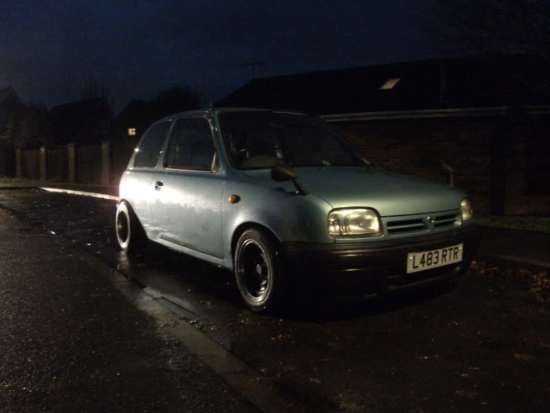

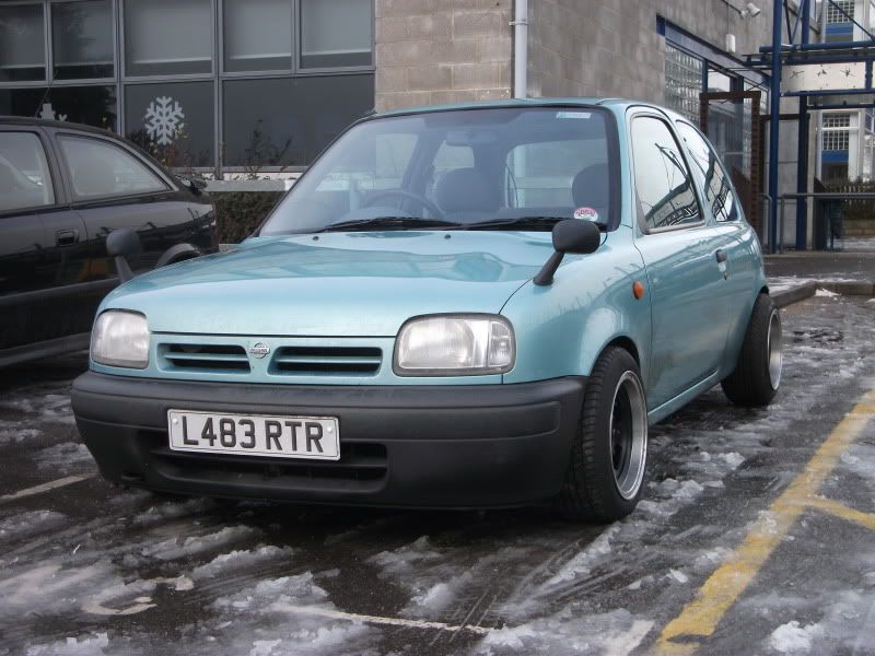

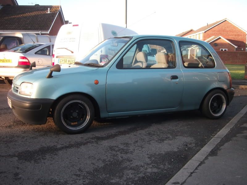

I got some spigots made for the 7's, they are on with the nice looking 165/55s on the back. I've also get some nice new 165/55s on the 6's on the front.
I've made a bad choice and don't like it.

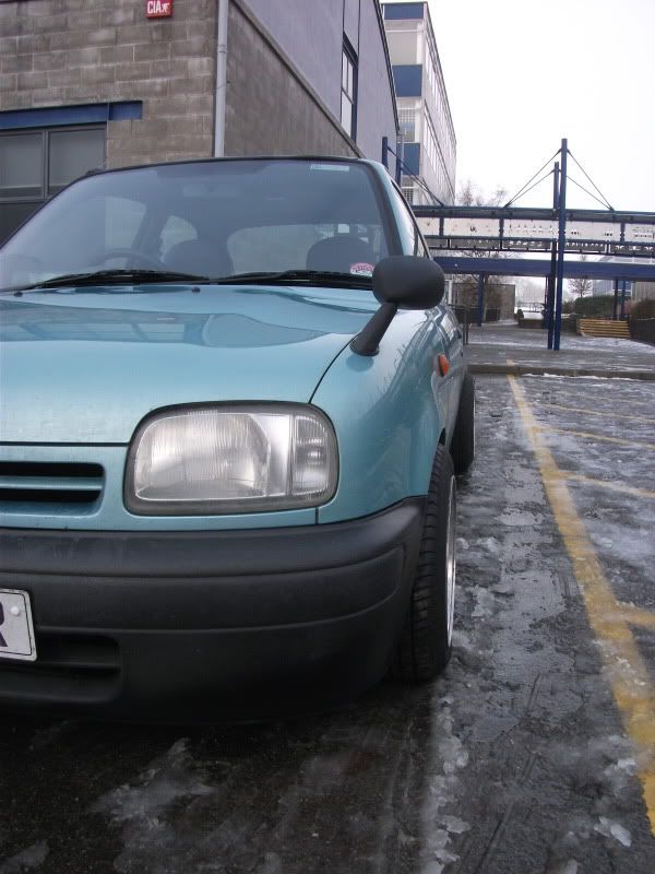

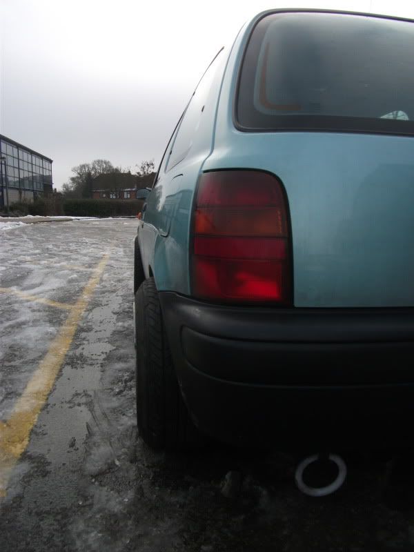

On the way home, this is the wide side, where the panhard rod has shifted the axle over.
The other side, this has a 10mm spacer, to even up the gaps, but its has nothing like as much poke as the other side. They will fit nicely when I re-centre the axle.

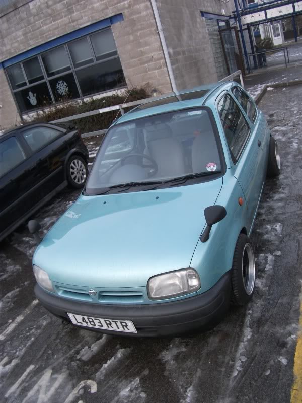

I don't like the difference in the look of the tyres front to rear.
I don't even think its that much better than when it had the 155/70's! Though it does now need a bit more drop to loose the arch gap again.
The pic of it in the dark looks better. Im not taking the #### here btw, in those two pics the wheels look different to me... :S
Slam it if you can, then see what i looks like (temp remove the spings?), might make all the difference to how you feel about it :)

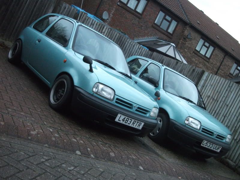

From the RR awards night yesterday evening. I've spaced the front wheels 10mm, its amazing what a difference it's made in the flesh. I like it again now. But still very much need another pair of 7's. I didn't take any pics, but if you want to have a look there's some here.
I just need to loose some more of that arch gap and I shall be a very happy boy again. Prehaps my wife, mother-in-law and parents would like to get together and buy me some corsa coilies for my Birthday.

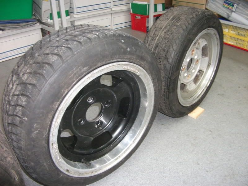

I've got a lead on these. 7x13 unbranded slots.
Not Wolfrace but simmilar. The slots are quite a different shape, but painted black would anybody notice? Simmilar enough to run this pair at the front?
Well I probably wouldn't notice unless somebody pointed it out. i'd notice the redrilling more i think. will be great to see it done.
Probs wouldnt stand out that much, if at all. Ive scrolled up and down the page a few times between the images and nothing jumps out at me as them being overly different.
Might be different in person though :S
