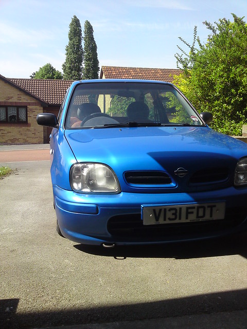

My facelift K11

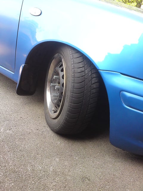

The negative camber was killing the front tyres. So I've put the stock steels on the front for now, running some tuck-poke. And I'll have to adjust the camber next week when I have some spare time.

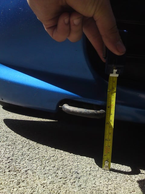

Got a pic today:
Only problem is the rear tyres scrub on the top of the arch on hard cornering or bumps. Could do with raising about 20mm.

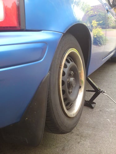

Also raised the front suspension again, about 2" higher than last month, it looks tall now :eek:
Wishbone now sits about horizontal
Front's still lower than the rear, will bring the rear down a little.
May remove those helper springs, they're doing nothing but firming the suspension up now, and it was allready quite hard.

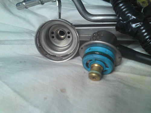

Finally started work on the fuel rail. It's from a cga3, with the later-style top-feed SR20 292cc injectors. Plugged into the rail with the SR retainers with no problem, fitting the cg intake mani needs a little work, 15mm collars are needed I believe.
Removed the cga fpr. Ideally this would need to flow much more to lower the pressure while off boost(which I estimate would kick-in around 3000rpm), I think filing, or removing the gold nipple would allow for this.
The plan is then to fit a fmu, but they're not exactly adjustable so it's a bit hit or miss regarding the ratio, and possibly an adjustable fpr to allow for some scope, I guess it's like franks custom vacuume advance rrfpr but just independent and in a series.

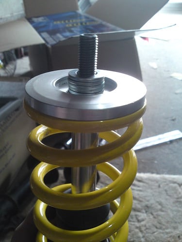

They're FKautomotive Corsa B Street coilovers
Adjustable, so I can lower it so low its undriveable! but I settled for a little higher than that:p But it's still quite low and would scrape the curb driving off and onto the drive, as well as every other mound in the road and I even had a flipflop get stuck under the front bumper driving home, so I've settled at the ride height above. Although it may have a sunk a little bit since.
So now the top of arch is about 30mm above the rim on the stock 13"s steelies. But with them being tucked in so far you can still turn like regular. Corners now don't exist as there's very little to no body roll, so that's fun! Ride comfort at the minute is bad as the springs on the rear are far too long and the shock sits at it's highest. Comfort from just the front coilovers alone is really good, not bouncy as it was on stock shocks as there's little movement, but it's still soft and glides over most bumps. I'll be cutting the rear springs in about half, they should still be captive and should lower to about the same as the front hopefully.

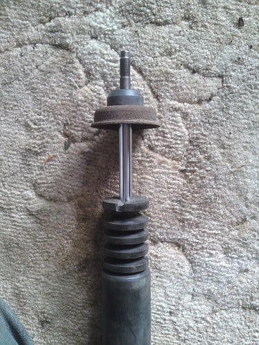

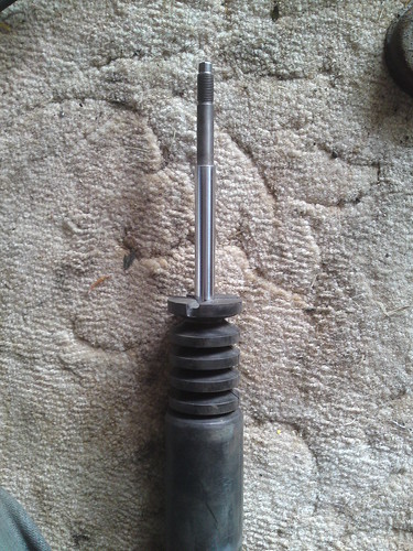

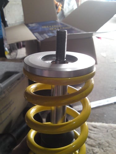

To fit the fronts first I had to remove the original shocks, and retrieve the topmount.
Had to then remove the thrustwasher from the coilover spring mount.
And place back onto the coilover, important note is this top spring mount is to sit over the rod and not sit ontop.

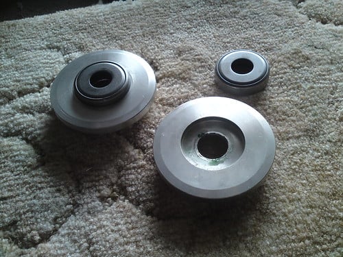

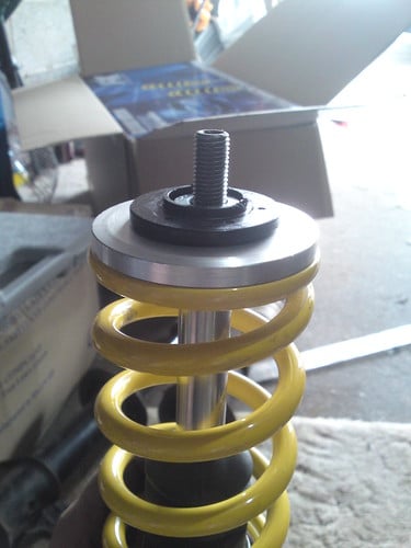

Need to space the top of the shaft, I used m12 washers, I ended up needing another 4.
Over them was the micra thrustwasher.
Followed by micra top mount, after filed to 12mm.
tightened with m12 nut. Making sure the top spring mount is clear and over the shaft, and your spacer's big enough that you don't run out of thread.
Fastend with m12 nyloc nut on top.

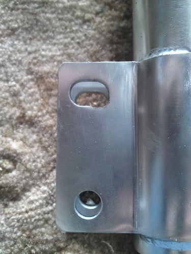

Also needed to file the lower mount holes, I opted for the top one as to keep the bottom hole a solid unadjustable hole. I also went for the most camber given by these coilovers, athough it does look like more could be got from them if I filed outwards. Did need to file more off but did this on the car with the bottom hole bolted to the mount.

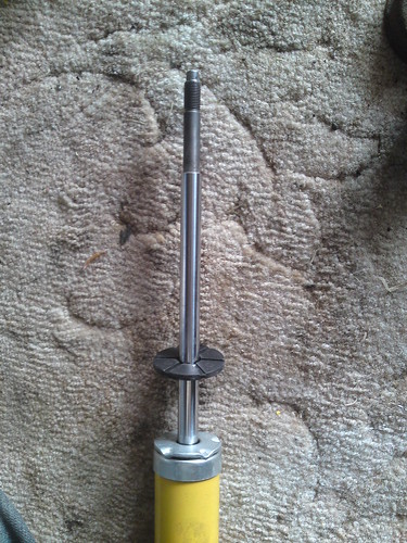

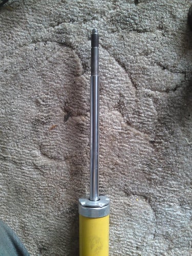

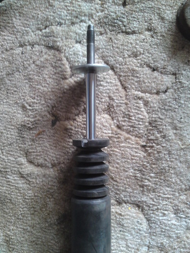

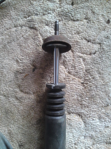

The rear dampers took a little longer, and again, neede to remove stock one for parts first.
Corsa damper from coilover kit.
Add the plastic disc it came with.
With the rubber cover and built-in bush, over the top.
Metal washer supplied.
Micra top.
One half of corsa bush.

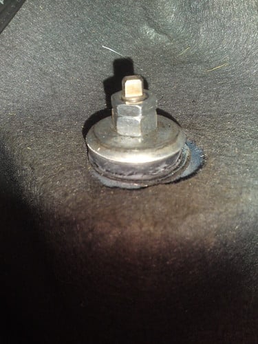

Second half replaces micra bush within the boot. I'll be replacing the nuts with nyloc ones soon.
Damper extension.
But before I can fit them , the metal edges on the lower bush needed to be filed flat, and the m12 bolt replaced with a m10.

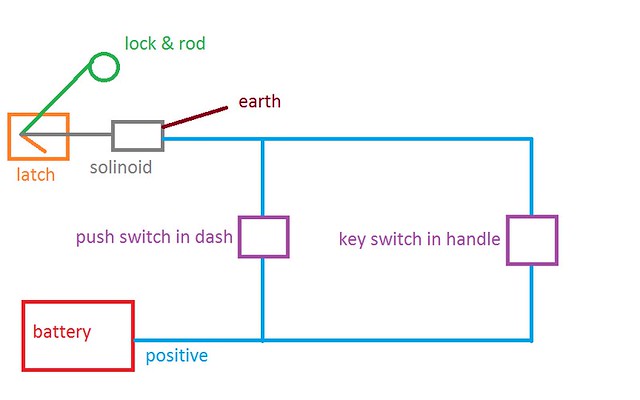

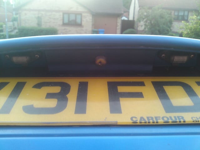

Yeah sure, it's quite easy and don't know why more people have done it, symmetry ftw. But this is what I did, I should have took pictures of the process but nevermind, got a couple from afterwards.

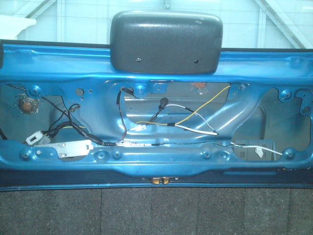

First thing was to remove the lock and connecting rod, which is pretty simple I forget how it comes off though.
Then before you close the tailgate!:
Fit a solinoid to the catch, I used a cheap ebay boot popper kit but throw the switch away as they're crap and will break. You'll need to run a 12v positive fused wire from the battery in to the tailgate, did it directly from the battery rather than cig lighter so I can open it without having a key in ignition. Trickiest part is getting the solinoid to pop the catch correctly.
You can make out where I put it here, as that's the mounting bracket bottom left.
But to open it from the outside, I installed a second wire from the battery (actually, a connection block from 1st wire in footwell) to a key switch, for security, that I positioned under the handle. But since I've installed remote central locking I just use the key fob instead.
Quick diagram of the wiring I used:
Then you've got to fibreglass or weld the hole, or holes as I did the wiper at same time. I used fibreglass, started with a couple of bigger bits from the inside then you can layer it on top from outside. Then it's filler, filler primer, primer, base coat, then laquer, with a hell of a lot of sanding in between!
