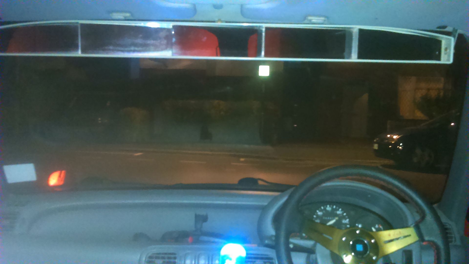

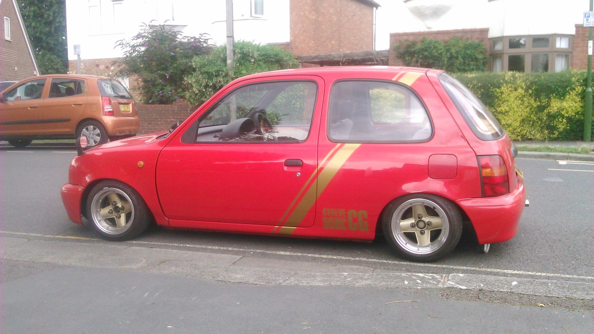

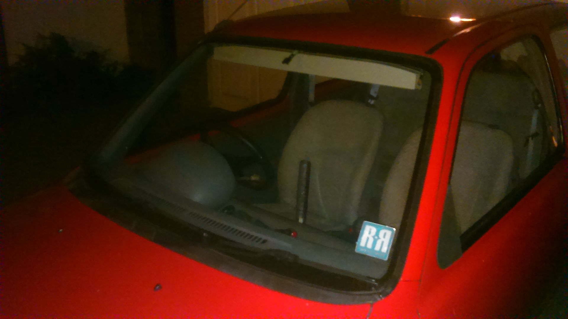

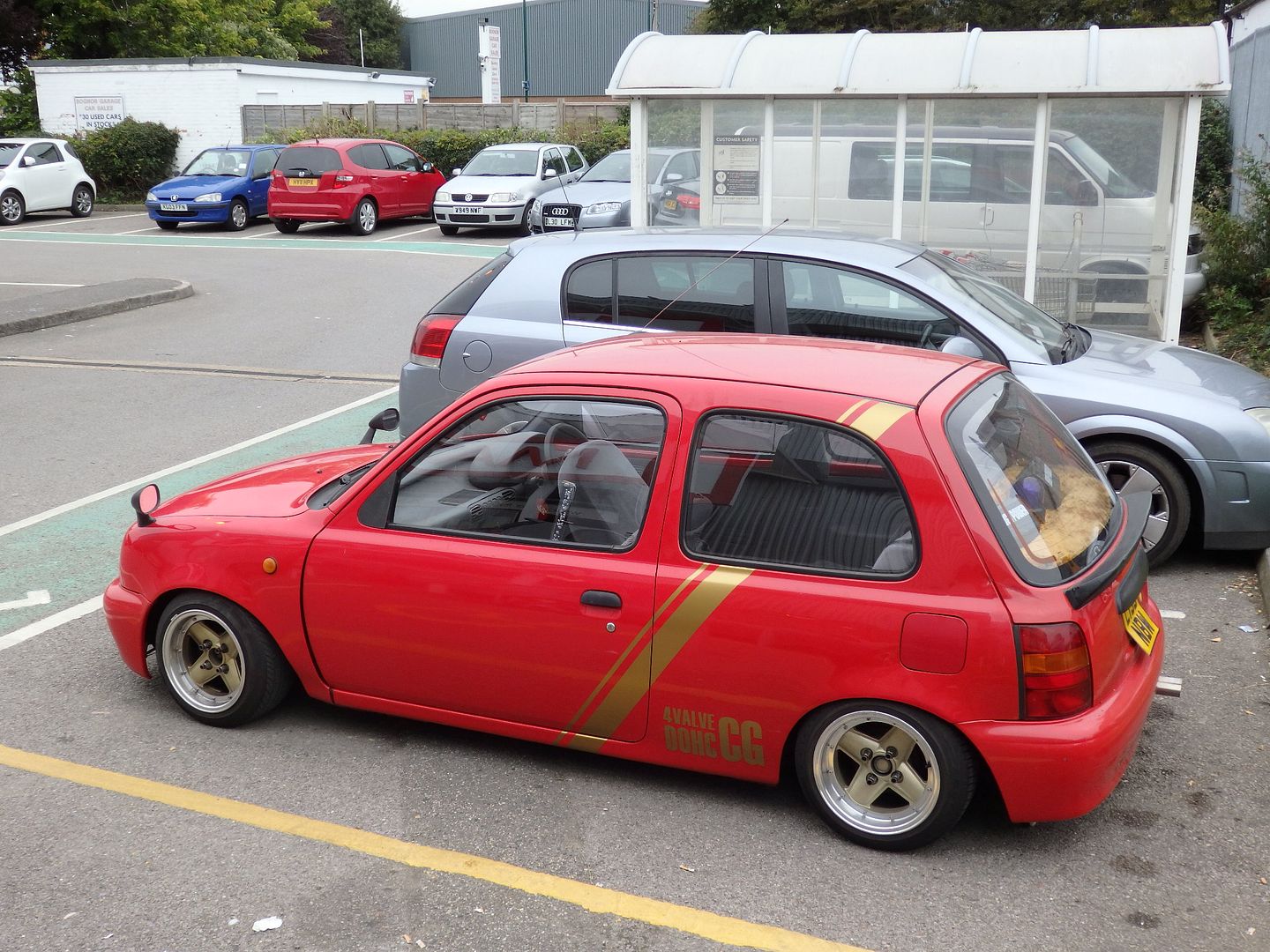

I finally got round to fitting the Suprascope panoramic safety mirror that I picked up at an autojumble in the spring. I made a few brackets that fit to the oem mirror mount, and each of the outer sun visior screws. It'll probably get a couple of stickers at some point.

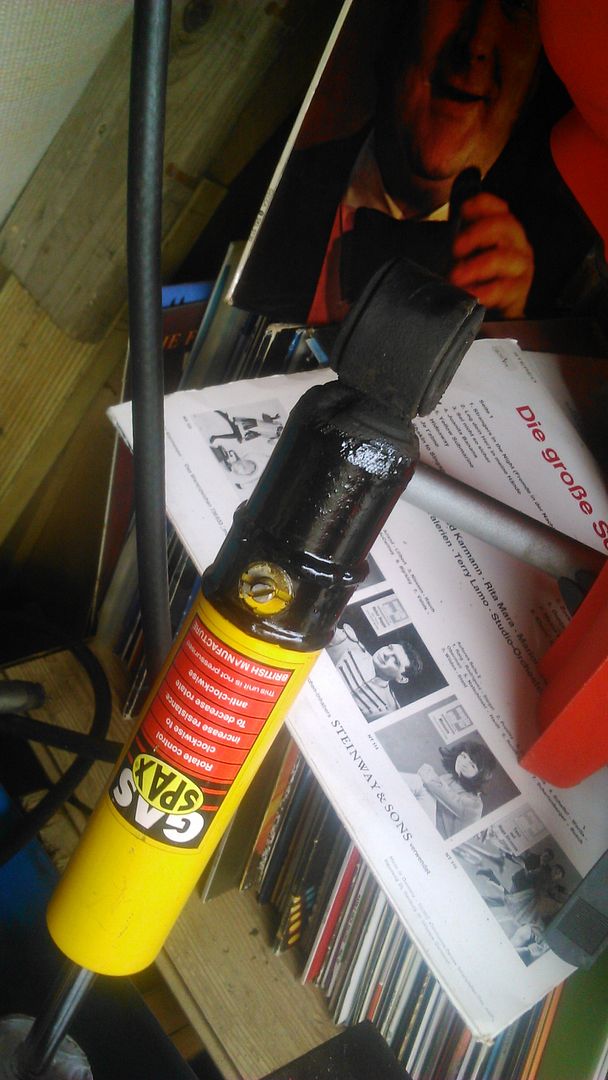

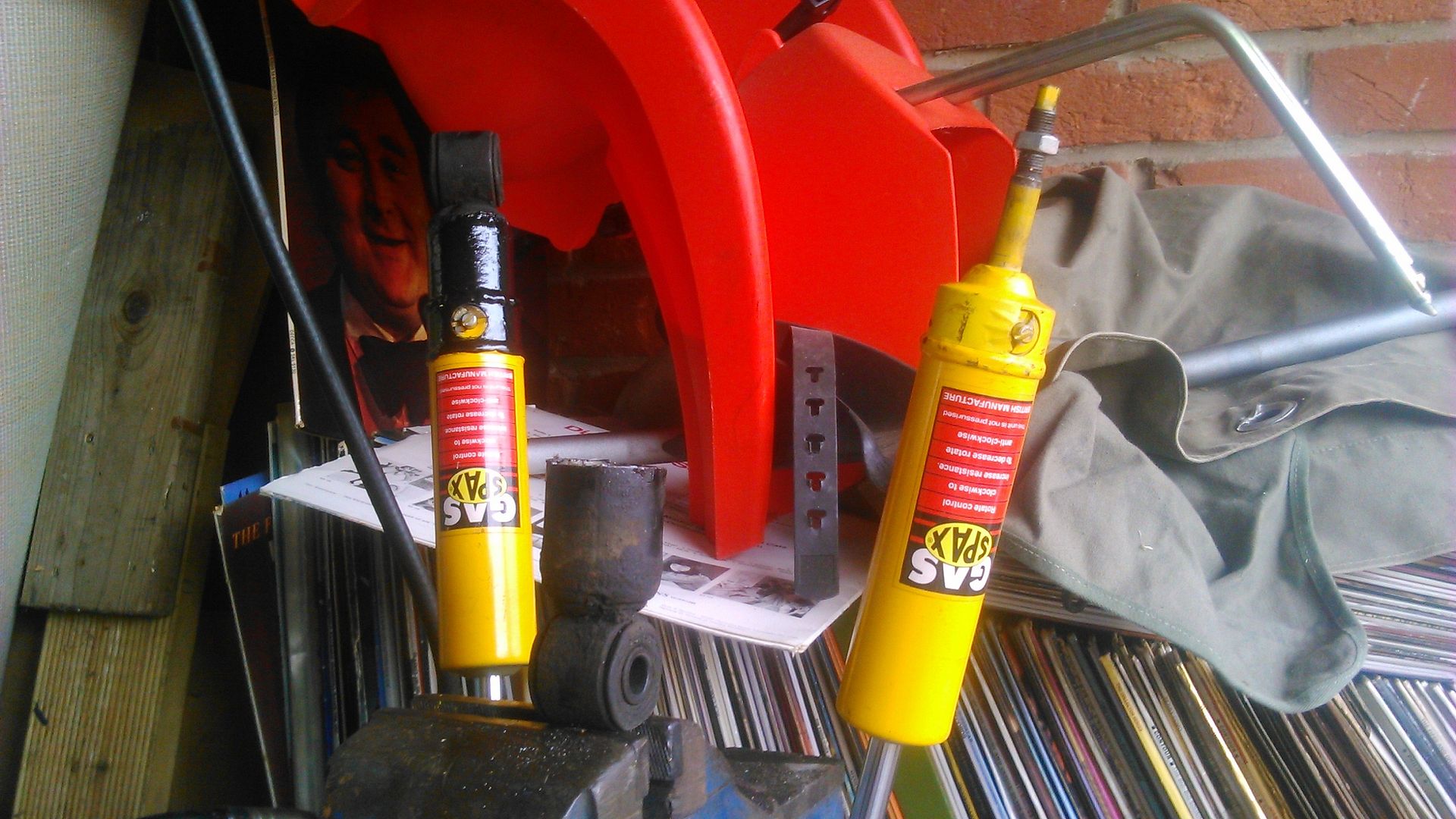

I bought a pair of spax adjustable shocks the other day, when I happened across them for cheaps on ebay. They were post mount at both ends so would need modding to fit.
Today was to be the day to find out what needed doing, so I removed the tired oem shocks, to find that I had been very much on the bumpstops fo the past few months. When I dropped it into the wheels it sat a good bit lower without the shocks in and would need some arch work and less spacing to get some tyre clearance back. So on with the shocks, these turned out to be a bit short to just weld an eye for a bush to, so I decided to cut 70mm off the oem shock body, and extend the shock too, all of which makes much more sense with this pic..
Welding to the spax shock was done in small bursts, with a bucket of water to hand to quench the shock and prevent the heat building up too much.

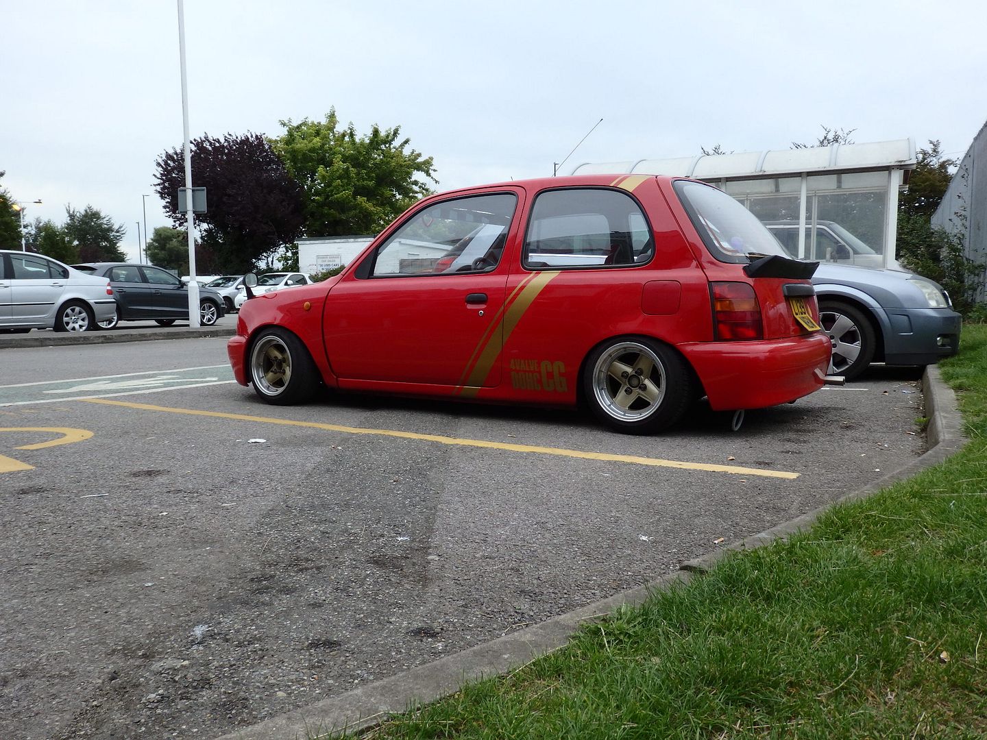

This afternoon it looks like this, measured to the sill it's about 5mm lower at the rear, - so I suppose I should wind the front down a little. And as a bonus I also have a bit of suspension travel at the back!
It's a bit odd, and feels too close to my eyes at the moment, but I'm sure that I'll get used to it- every time I get in at the moment my first thought is "put the sun visor up".
Haahaa love it :) not sure if it will reflect my interior to much and be a little annoying :)
I'll try pick up a cheap one and have a play :) xx

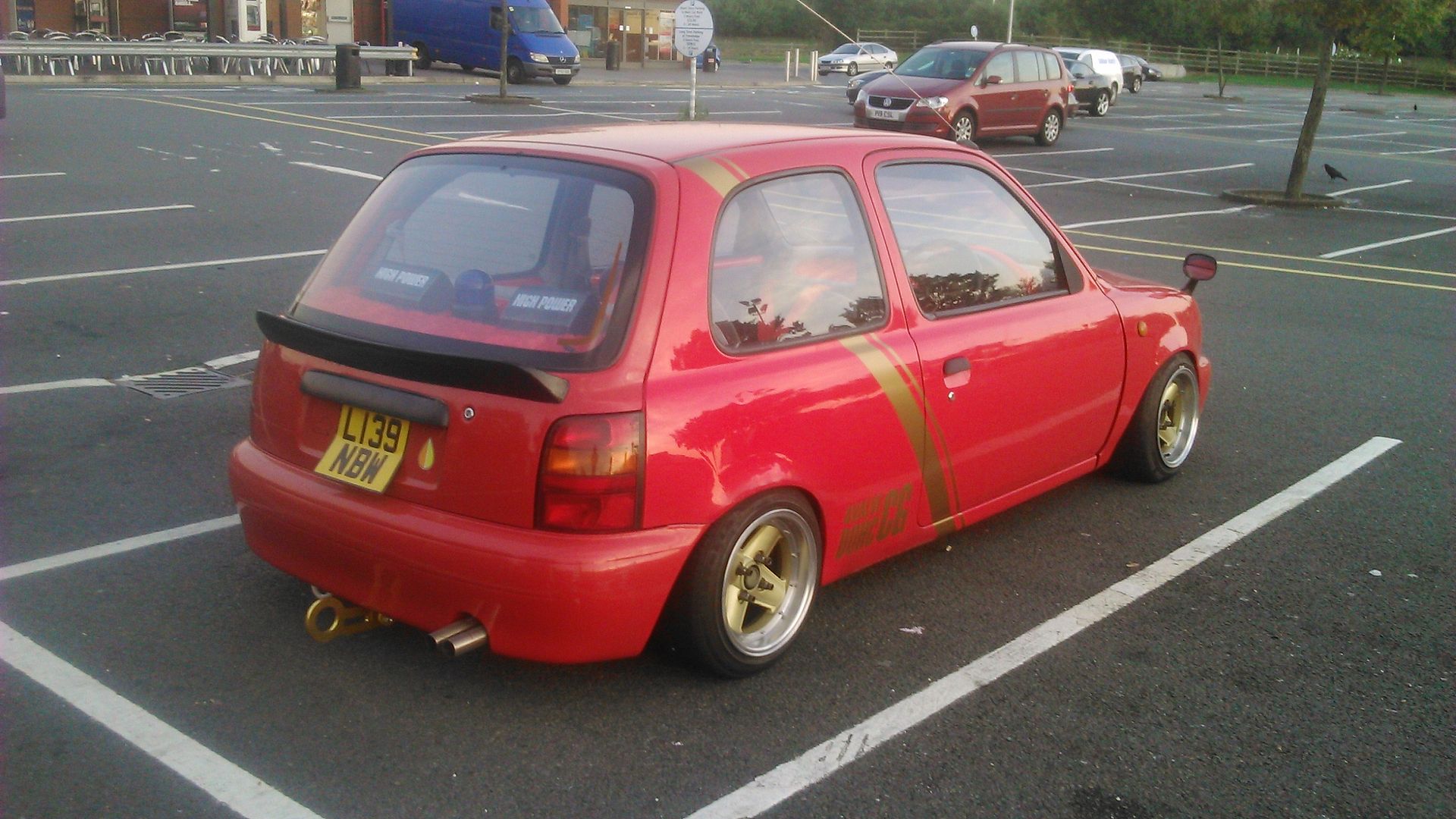

I managed to get all four wheels refurbed, though the off side are not nearly as good. I refured the shelf with red and sid the dash insert and dash pod to match. I've also fitted some red harnesses inside to keep the colour theme going.
Plenty of alternate angles up there, I've been meaning to do some pics, but have been distracted by the gearbag being borked, and just not getting time and sunshine coinciding.
Most of them have been on my instagram too, but be my guest, I took a couple more nice ones this morning that I'll stick up in a bit.
