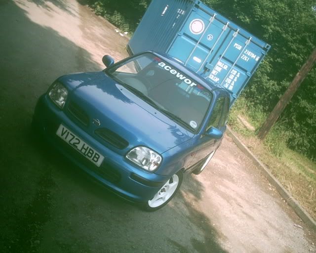

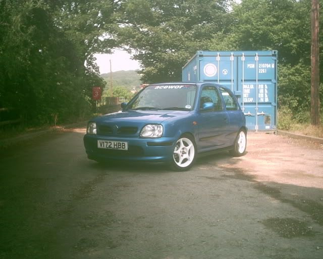

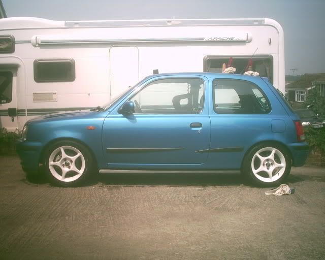

iv spent 3 1/2 hours cleaning today shame i havent got a decent camera but you can see it alright lol.. Tcut, Mequires polish and wax, tyres done side skirts were put on yesturday when i serviced her aswell... pint is glass smooth, the inside of the windows just needs doing now aanyway some pics :-
OH and its raining now!!! :mad: ahh well...
