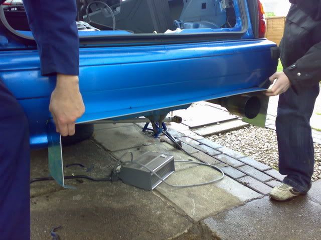

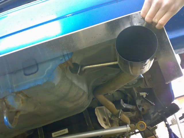

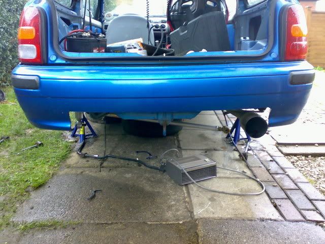

got abit more done today rear anti roll bar is on ther rear axle.. and looks good in silver and blue.. and we got the rear drop link of but the body panal is damaged where it bolts so we are going to have to fix it either make a new one up or weld the old one together.. also started on the rear diffuser got pritty far with it it needs attaching, some body work to make it neat.. some pics :-

i can get someone to make up a carbon one if you like?
speak to "hansell technologies" or www.carbon-fibre.com or fibre lite (same company) and theyle do anything you ask them to..
i might pinch that idea for mine, (although alter it slightly for my car..)
that exhaust must be realy noisy...
i mean, no back box... straight through?...
and im realy thinking about the diffuser..... if i get a facelift rear bumper and take the gray plastic bit out of the bottom, a diffuser simalar to yours should fit... all beit smaller..
so i would have a 1994 super S bumper in AJ4 for sale and wanting a 1.0 1998 onwards rear bumper in aj4 red....... but in just playing for now..

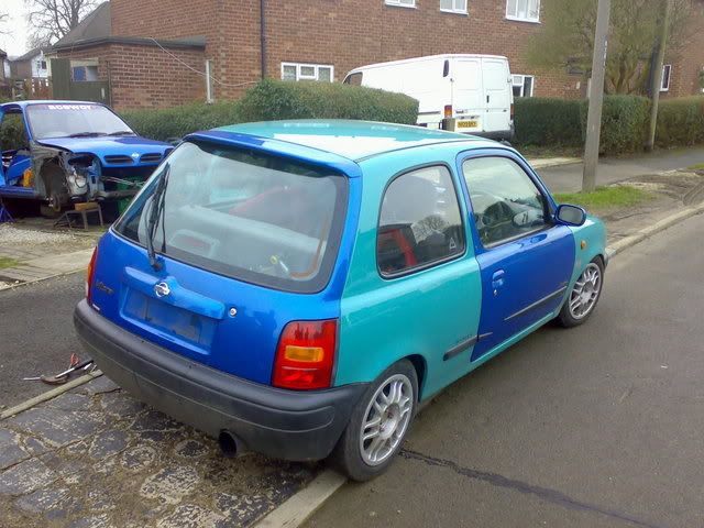

done some more work today thanks to the help of rich, shaun (swiper), and swipers brother gary (p11 SR20) we have put facelift doors with the colour coded mirrors and handels over as they didnt have any rust on them but with the pre facelift doorcards.. also facelift tailgate and lights and re-wired them to work properly car looks stupid but when it has the facelift lights blue bonnet bumper and wings im going to get it re-sprayed the sills done and a new front panal put on..

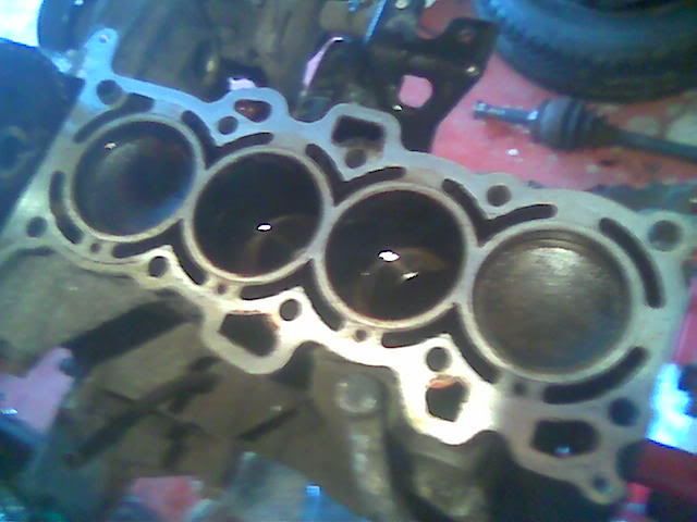

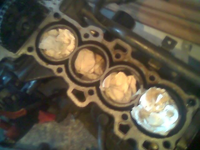

anyway poeple have been banging on about GC13 auto blocks being stronger than than non auto blocks so having got one of eachf or the enw build i striped them down and have conclusive proof of which is better if any...
manual CG13 :-
and now the auto block :-
as you can see there are aditional suports to the cylinder liner.. i was amazed when i took the gasget off andsaw it as i was goign to have the same thing done anyway but i got it for free lol so there is your proof auto blocks should be stronger than the manuals :D whilst its not a completly closed deck its better than notihng :D
