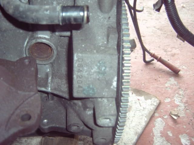

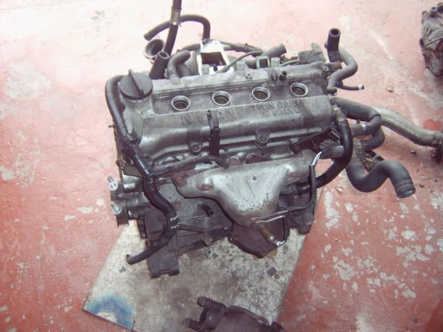

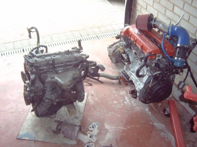

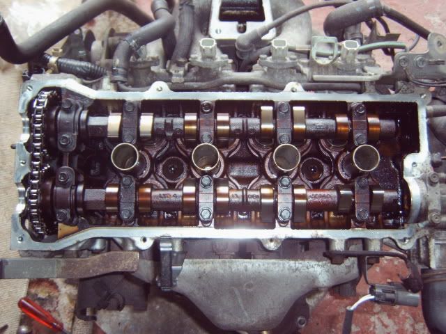

right a glimps into the raceworx engine shop (my nans) iv got hold of a CG13DE auto which is going to form the base of my CG13DET project.. as you can see i stil have the SR20 which is going to give me afew bits :D anyway to the pics :-
it looks like its not had an oil change for a fair bit but theres no wear on the cam lobes which is good :D

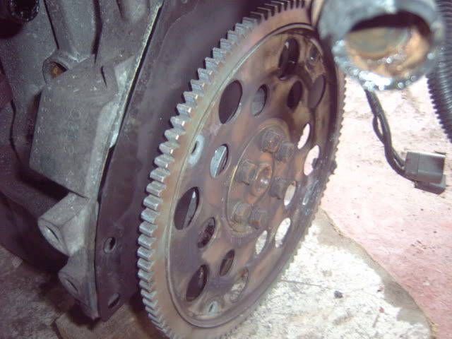

Nope its not a super light fly its proof its an auto with its starter gear :-

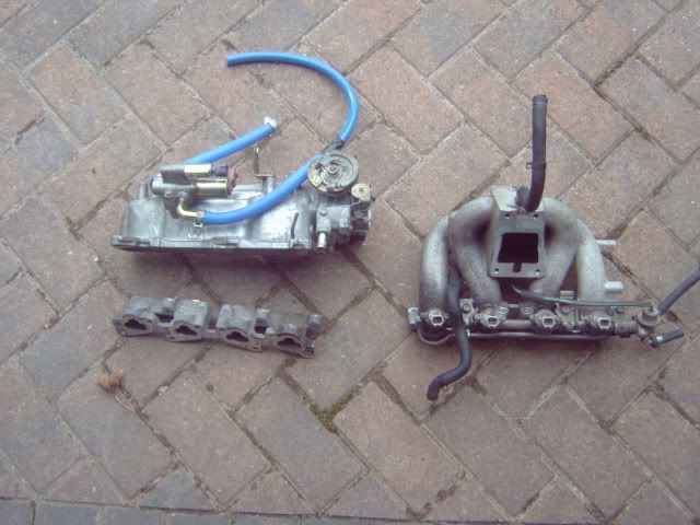

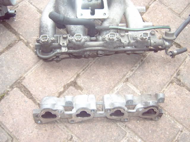

I took the inlet off but rememberd i had made a cutdown inlet for experimenting with a while ago!! :-

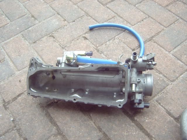

then glancing at the SR20 nkowing i wanted to use its throttle bodie i had a brain wave lol :-
i can use this top section as my inlet plenum all i need is some ram pipes welding to the cut down inlet a nice flat plate that bolts up and we have a side draught SR20 Thrttlebodied inlet :D
