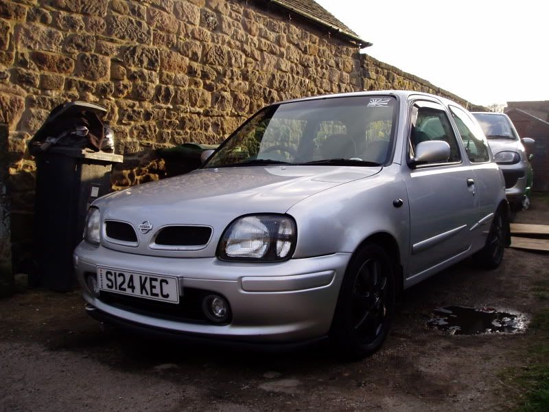

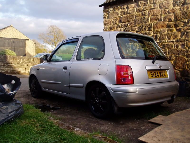

its been a while..
well, heres an update on the silver si...
its been lowerd agian
2001 spec rear lights
oem front fogs
2001 spec rear wiper
new rocker cover, painted in wrinkle black.
oem ronal wheels painted ford graphite grey
MOT agian soon :S carnt belive its been a year!
