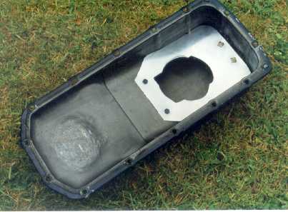

here's the stock oil pan with some baffle features. i wonder if it could be improved cos the 2 big corner gaps seem to let alot of oil slosh left up towards the crank when i'm turning a long fast right hander, potentially starving the pump and foaming the oil against the crank.
maybe some sorta one-way hinged flap or a loosely tethered bung on the lower side of those LH gaps?
so that normally the flap or bung allows oil spilling from the crank n block to flow down the LH shallow slope, through the LH baffle gaps and fill up the baffled lower sump around the pickup.
once i turn hard right, the oil tries to gush left, out through the LH gaps but that reversed flow pushes the hinged flap or bung to shut off the gap and keep most of the oil inside and close to the pickup.
when i straighten back up, the oil stops surging left against the flap or bung so they loosen and allow oil to flow back down the slope and into the sump
or another alternative is to seal off the 2 LH gaps? so the oil can't easily slosh out leftwards and during the straights or left turns, the returning oil is made to flow back in via the center hole around the pickup or the RH gaps.

thats the one i saw. ah tis a different engine and sump.
i still think patching up the LH corner gaps on the stock baffle is the way to go.
no, actually i think i'll be best off cutting the old baffle out and making a completely new sealed off horizontal baffle like this
the sump is mild steel eh? wonder if it's thick enough for my arc welder, meh i'll just pulse tack weld it in place like when i did my IC piping to keep heat down

We've baffled our sump but I don't have any photos to show......pretty similar to #2882 though. I'd love to dry sump for a few reasons but the engine build is already radical enough for me....

i'm not sure on how to design the new oil baffle.
of course leave the holes in the middle for the pickup and dipstick but dunno if I should:
1- seal up the edges to totally prevent the oil below from sloshing out to one side and hope that the returning oil will flow back into the chamber through the central pickup hole without any air blockage or
2- leave smaller gaps all round so the return oil can still seep back down through the edge slots but won't slosh out as fast as the big gaping baffle holes on a stock pan.
