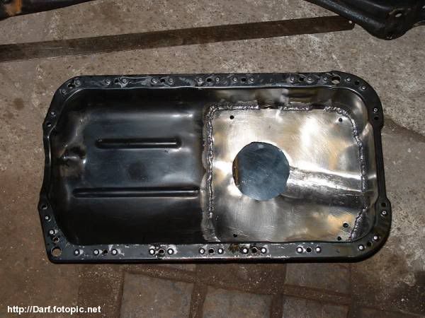

the oil baffle plate is 125mm from the top of the sump and holds 2ltrs
with 3L the level is 100mm from the top
and with 3.5L which i think is the dipstick max level its 90mm from the sump top and just level with the turbo drain plug
with the sump full of water i tested how the baffle controls the fluid. appears it doesn't do too well. oil just gushes easily past the 2 gaping holes so no surprise that the brief whiney PAS pump type noise i hear on trackdays when i turn hard right might well be the starved oil pump
to remove the baffle I tried grinding away the spot welds and chisel the flanges off but its just too noisy and dusty with little result
so instead i drill through the spot welds easy enough. will be plug welding the new baffle on anyway
the drain plug sticks up a fair bit, so a little amount of oily crap would actually be left at the very bottom near the oil pickup?
maybe I should weld a nut & bolt under the bottom of the sump to fully empty it? or would it stick out too much? i think the nut should be mig or tigged on by my local welder so it doesn't leak and is strong enough if it does get knocked
this is where the pickup goes, look at the massive gaps
I'll need to hoist up the spare engine and measure the position of the crankcase so i know how much space there is.
not sure at the moment how to layout the new baffle plate like:
oil pickup hole:
too large = oil could slosh out the hole,
too small = not enough oil allowed to flow down into the baffled cavity so it all pools up above the baffle plate, churning against the spinning crank and starving the pickup.
baffle plate edges:
sealed all round - thoroughly keeps the existing oil thats inside from sloshing out but may prevent returning oil from filling the baffled cavity up if the pickup hole is too small = churning oil & starved oil pickup.
small gaps all round - allows some oil to return into the cavity but allows the baffled oil to gradually leak out when turning a long fast right, still better than a stock baffle.
measured underneath the engine to get these dimensions
made a template from cardboard
with the measurements i initially cut a 60mm hole but seemed too tight for oil to return through and tricky guiding the pickup through during removal so enlarged it to 70mm
how the pickup relates to the baffle
in the sump
where the baffle is relative to the pickup and crankcase
test fitted the sump onto the block and looking through the turbo drain it seems ok
pickup support bracket touching the plate so needs trimming
refined template
new baffle vs stock, much less leaking gaps
