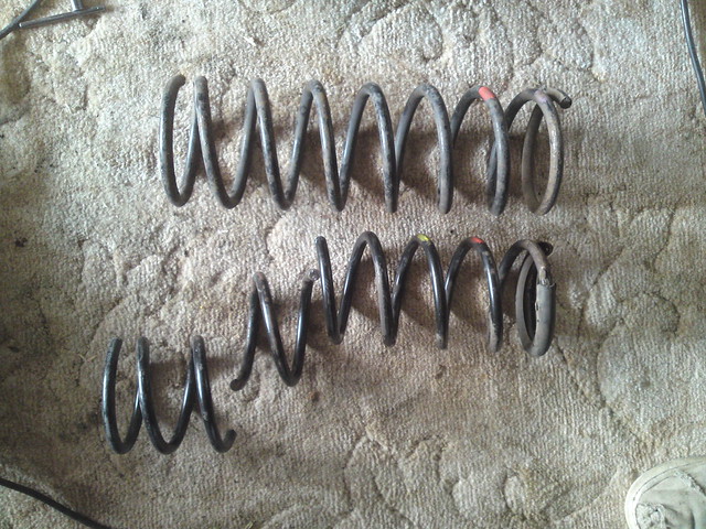

I've currently got cut springs on mine, they were just captive before, but now they make the car sit at it's highest, ie rear damper fully extended and it's very uncomfortable, I'll be cutting the springs in the morning so they should match the height of the front. Which should make it a bit better. Luggage/passenger wise I don't know yet, would asume it's better than stock dampers as the bumpstop will be lower and it won't extend as much, as the dampers are designed to work at that height.
Do civic springs fit the rear, i thought they fit the front of the matiz struts. I think whatever springs you put on they'll want cutting. I'm in the middle of doing mine now, cutting about 2/3rds off front micra springs -to go on the back:wasntme:

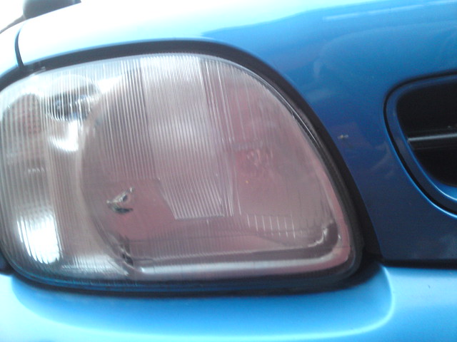

Broken headlight.
Noticed it the other day. Haven't got a clue what happened. Somethings pierced the lens, chipped off some glass, and stopped the bulb from working without braking the bulb:glare:
So I'm now looking for a replacement, or may even get the 2nd facelift headlights. Anyone got any they want to sell?

Thats so annoying haha, i have the opposite side and you could've had that for postage.... thats a shame...

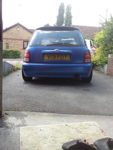

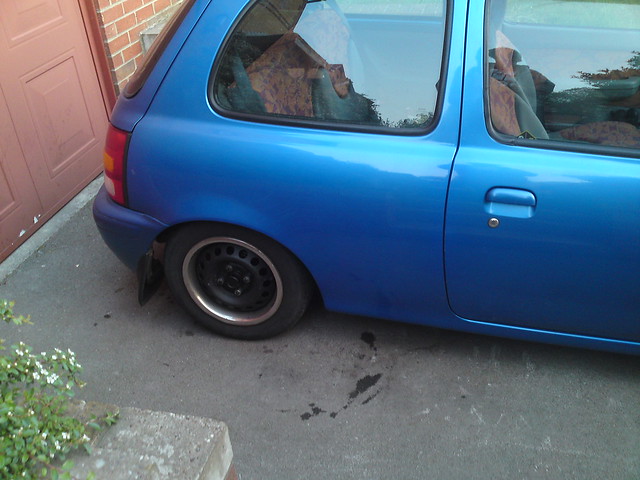

Lowered the rear further today, cut the spring as short as it will go without becoming uncaptive. But might come a little loose when jacked up, but remains in its seat, like they did before which passed the mot.
Lowered it about another 30mm on the allready -45mm or so cut springs:wasntme:
Still could do with going 15-25mm lower to match the front better, not sure what to do other than look for different springs. But it definately looks better than before.
I'm also going to pick up a pair of wheels tomorrow, need some work doing before they'll fit, and they'll be goin on the back for a little bit of poke, with the minilites upfront:D But will still be looking for more to replace the mini's.
awesome dude i believe its civiv rears as they are apparently stiffer! how come you didnt use the rear springs on the rear? as i dont currently have my front on the lowering kit which id much rather not tamper with obviously as i can sell it as one complete unit
Ah ok Will, Don't really want stiff springs though, want more spring but softer so it drops abit more. And I used the fronts initially as to keep the rear springs stock for mot time as I replaced the fronts for matiz springs. And the fronts are also longer, but compress about the same, so in my head lol, I thought you can cut more off than the rear while keeping it long enough to be captive, wheather that's true I don't know, but I passed mot with them cut for -40ish drop.
I've got 5mm spacers on rear scott, anymore and extended studs would be needed ideally. And I've been trying to put alloys on them since I've had the car so I shouldn't need spacers so no point buying them. But one year on and I'm still rollin stock steelies:wasntme:

:laugh: I've got corsa coilovers now yeah. But before then I had matiz springs on micra struts. So the front micra springs was spare, so I cut them to put on the rear and saved the micras rear springs for the mot. err I think that makes sense now lol.

Coilovers should be fine, just the rears a little tricky, cant have it too low(lower than pics above) else it'l be a fail for being uncaptive. Hope there's a fix as I love it this low, drove past a couple of very low vw's today, but mine was lower mwahaha, got a few evil glances from them:grinning:

well unless you can find a spring which is about 5inches in length then we can use it lol the reason we have to cut them for coilovers is to actually drop the rear but iot will stay perfectly captive...
its when they are uncaptive that its dangerous

Typically I'm with you on this, but it's only the rear springs, they're captive when jacked up, the sports dampers will/maybe(im unsure) help with the 'stress'. And the handling's perfect:p
For anyone struggling to go lower and keep the springs captive you need some runflat/helper springs http://www.dfaulknersprings.com/helpers.htm

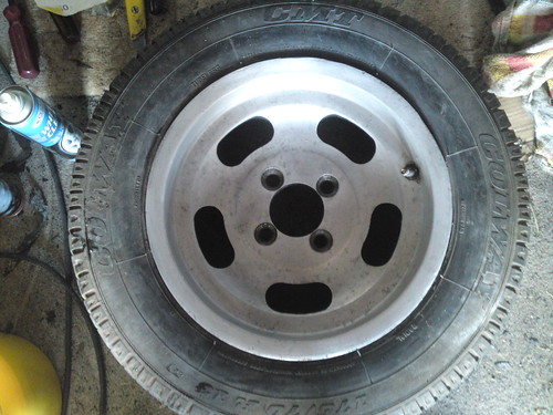

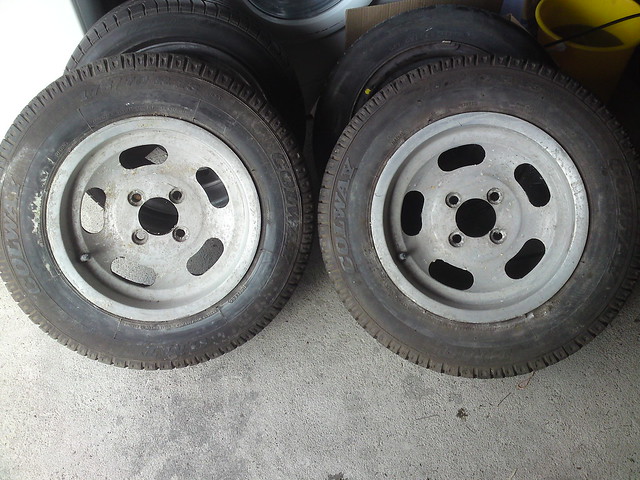

Picked up my new wheels today, 13"x6j cobra slotmags, think I might put them on the rear of the micra, need to be referbed, get some smalller tyres on them and adjust the holes from 4x4 to 4x100 if I want to fit them first:wasntme:
Unsure on what colour, but will paint the minilites the same. Might be black centre silver rim, gold centre silver rim, silver centre black rim, or gold centre black rim...

The stud holes are probably a large enough diameter to clear the micra studs, so you could do what I have for my rears which are 4x4". you need to go with spigot rings - get some ally ones made, then a taper to flat washer to suit the taper of the mags, again with a larger diameter hole than the studs so that it can sit eccentric to them, on top of that a flat washer that fits the studs and a flat nut on top, I've used stock micra nuts the wrong way round. No issues with wobble, or the wheels comming loose (these were on the back of the tourquise car for a bit as well as now on the red one.

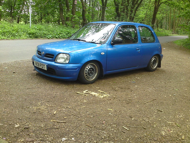

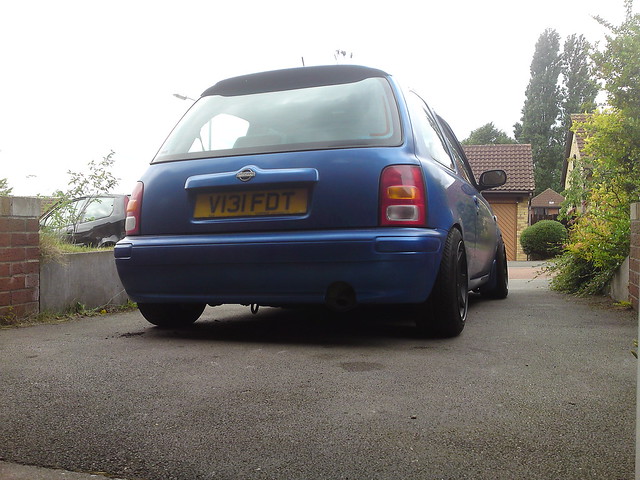

Coilovers, two week evaluation*geek*
So I've been running coilovers now for over 2 weeks, and I've got to say they are really fun. Ride comfort is better than before, a little bumpier on certain surfaces, but glides over most bumps rather than crashing and bouncing like before.
Scraping isn't as big an issue as I thought it would be, it can even get over some speed humps ok, only tried those long round smoother ones that stretch the width of the road and typically found near schools, the thinner hump ones and the jewel-shaped ones I'm not even going to attempt! Only major issue is going over uneven ground where the sump and gearbox can contact the road, but I've not had any problems just got to be sensible. But there's two things that I have know idea what they are for that are located towards the bottom of each end of the crossmember and stick out below the bumper, they scrape the most with being so far infront of the wheels and make quite a loud 'ching' that scares old women and makes kids shout 'oomm he crashed' ha, but other than that it's surprisingly fine.
Cornering, is excellent compared to before and I'm only on stock tyres. Not used anything wider than the 155s with coilovers yet. The additional camber also allows more cornering speed and is a lot less likely to understeer now. I could do with better seats now though as the lack of support from can become evident.
And the looks you get from 'dubbers' is absolutely priceless! Most of them are usually in polos or lupos and are alot taller and the few that arn't tall are about equaly low, and they all stare as they drive past, or some stop and stare, had a couple take photos too, some do shout ''it's a f#ckin micra'' or ''why the f#ck a micra'' or simply just ''c#nt'', which is nice to know my cheap car is affending others who've spent ££££s on chrome bbs splits and bonnet bras:laugh:

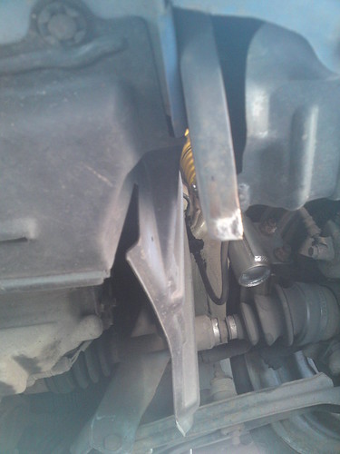

the unknown metal part that keeps scraping:
Slot Mags
Not much has happened with them, tried to remove the tyres myself but couldn't, didn't think I would but gave it a shot. So I gave them a good clean, but I've been too busy with work to get around to painting and fitting tyres. Will follow on with what Mark advised, and will fit eccentric tapered washers to fit them safely. Almost decided on a colour scheme, I'm thinking aluminium painted centre faces and dark grey/gun metal for the rest.
Good lord, that's low :eek:
It was lower, but I've highered it to a more suitable height for a daily:grinning:
Slot mags! like mine... lovely aren't they :D slightly different shape but still gorgeous!
Yep I do like 'em, I really wanted those that you bought from mark but they were on the top end of my budget. These ones are made by Cobra possibly for a Vauxhall not quite as iconic as the Wolfraces but they have the smoother rim that I prefer although they're scuffed to much to polish. Only have the pair, so im looking out for some more, or any other wheels possibly some compomotive cx's:grinning:
Would love to see a micra on compo cx's, and alley cats. I rather like the cobra slot shape, much closer to the Hailbrand kidneybean type wheels that influenced their design.
I might have a lead on a pair of 7x13 Cobra slots. I'll have a hunt back through my e-mails.
Not a fan of the silver centre idea, go fully polished, I think yours could pull it off.
Would go fully polished, or possibly black centres, but the rims are scuffed too much with a fairly large ding in one(the one above but cameras hid it). So I was thinking about a darker colour to hide it. And yeah if I can get hold of another pair of cobras that could be good. Yup missed out on a few cx's on ebay before, but still looking.

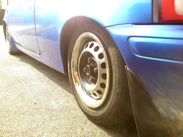

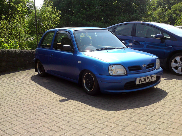

They're Ford Capri 13x7s with 165/55 tyres. Have had to raise the front coilovers about 10mm and put the rubbers back in on the rear and diy arch roll as there was alot of tyre rubbing, can just squeeze my fingers between the arch and tyres now, but might not be enough. Looks good though.
Broke one of studs for the centre caps (yep superls, they are soft aint they, any idea how to fix?) And I may need to get some longer wheel studs to be more confident the nuts won't come loose.

No not got any better pics as of yet, that was the best one as it's a tight space, and couldn't go anywhere else as I got blocked in on drive.
I parked a couple spaces down from another facelift last week, and I'm roughly half a foot lower(6"s) don't know what that is in mm as I can't count that high:D With the jack that comes with the car, I had to wind it to the bottom and slide it in down the sill from the rear to lift the car. But I've raised it a bit for these wheels as it was too low so don't have to do that anymore. It can go about 50mm higher or 20mm lower on the front coilovers more if I remove helper spring, but any lower than now and it wouldn't be very good as a daily for me.
:grinning:
Aye mark, I've removed them, just not in that pic, can see them at bottom of pic 2 though. Needed to be done, too long and wheels stuck out by 2"s, front ones will stay for now, spoiler might go next. But I think some sr mudflaps and spoiler might work well, but probably better with nothing at all.
I really like the alloys, was looking for something a bit subtle, without dish and chrome.
They're about 20 year old (someone will correct me) can also get 15" versions and a 13"x6 ones for the fiesta.
Capri, wheels also painted black:
And with them being ford there's some trickery being done to fit them, and at only 13"s it's easy to think they're trims at first glance, which I like too. Messing with peoples minds more:D

It just needs a little bit of negative rear camber and the stance will be spot on imo. Have thought about the badge, thought about just ford ones, nissan in the style of ford would be interesting, but will leave them blank for now.
