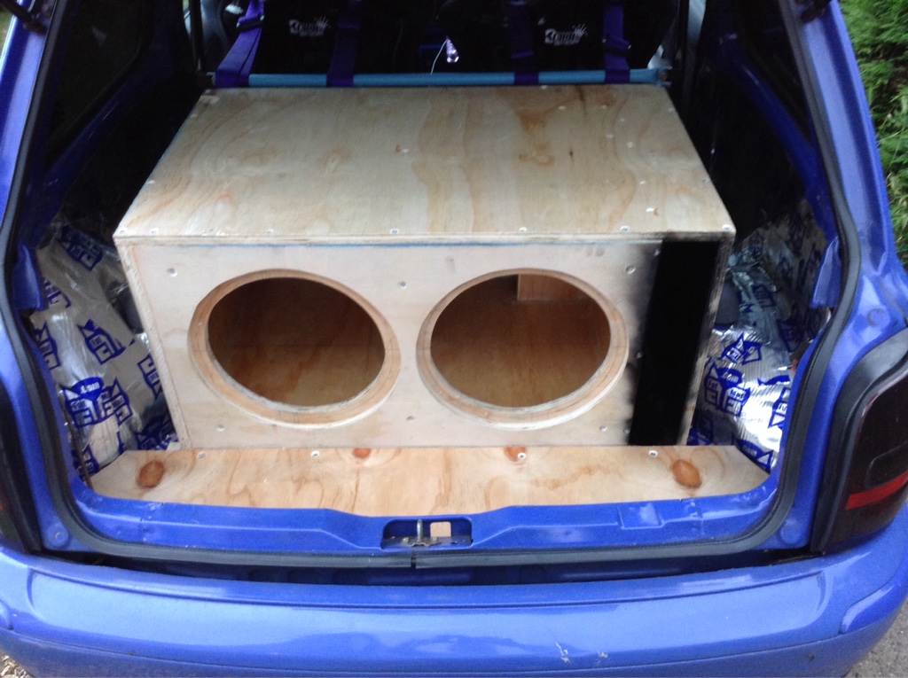

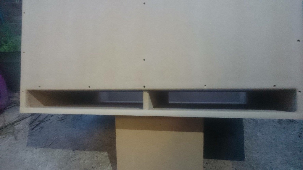

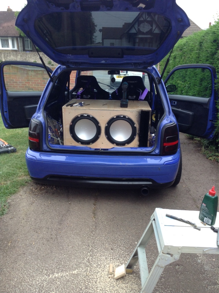

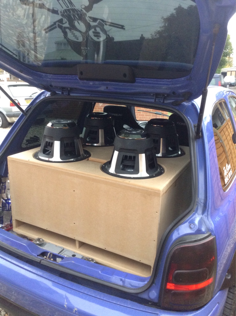

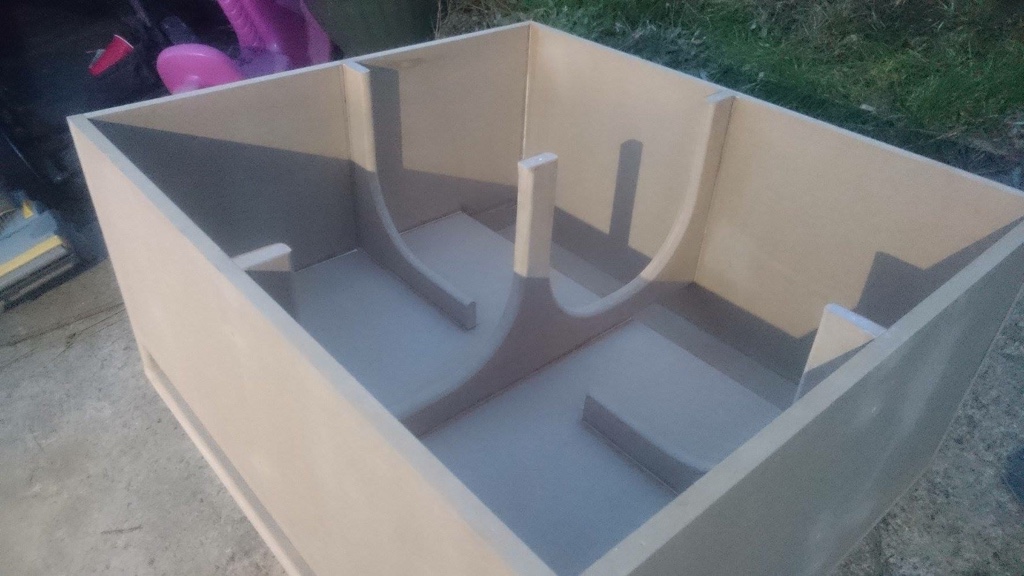

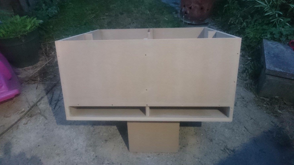

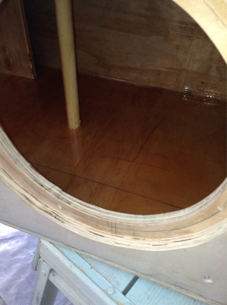

So to do the box took me roughly about a week to do managed to get it glued up and that then on the weekend done the resign

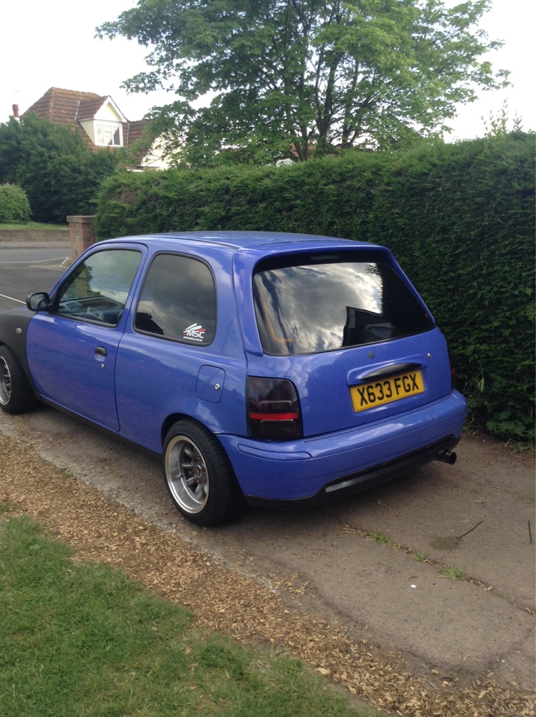

Decided to get my windows tinted whilst the box was out as don't want people to see what was in the back
Before:
After:

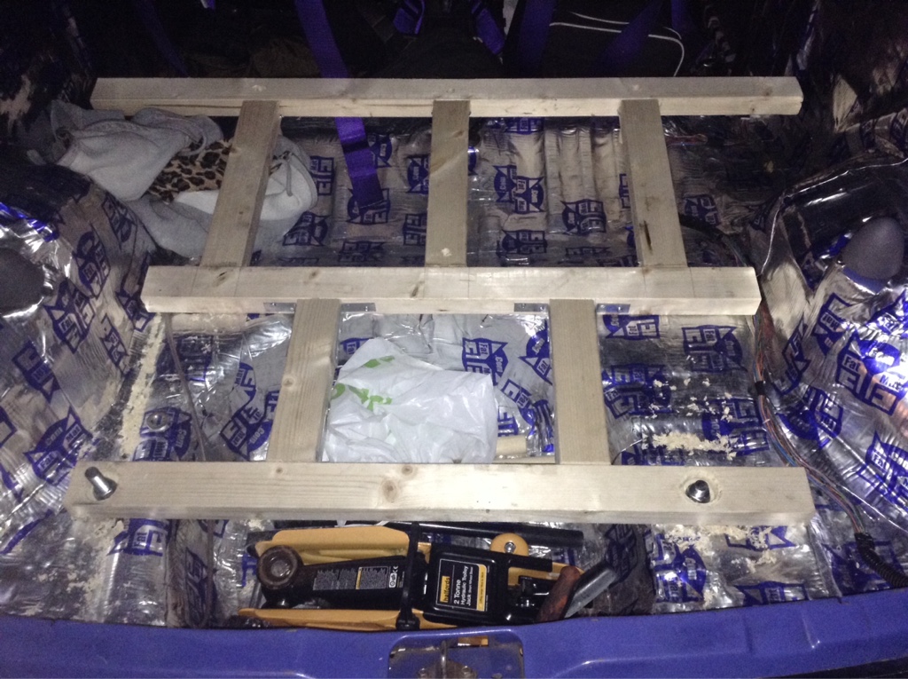

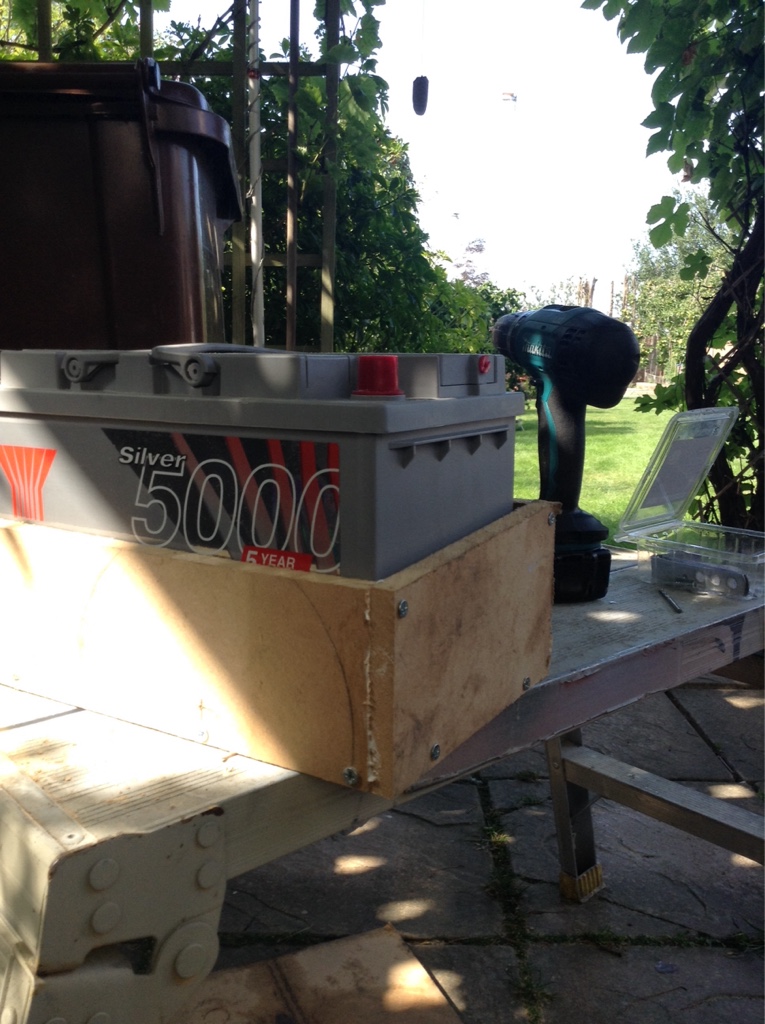

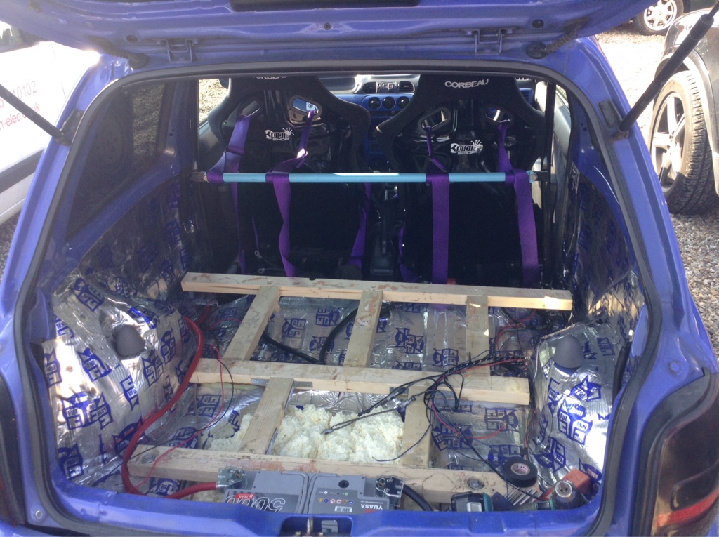

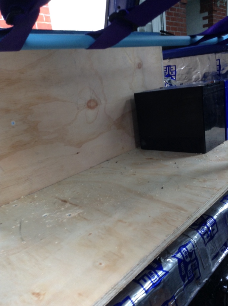

So after getting it all done started to build a frame which is bolted down with 16mm threaded bar going threw the bottom of the boot for the box to sit on

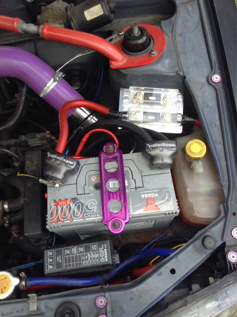

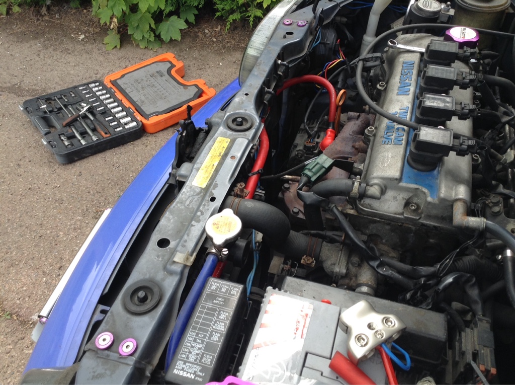

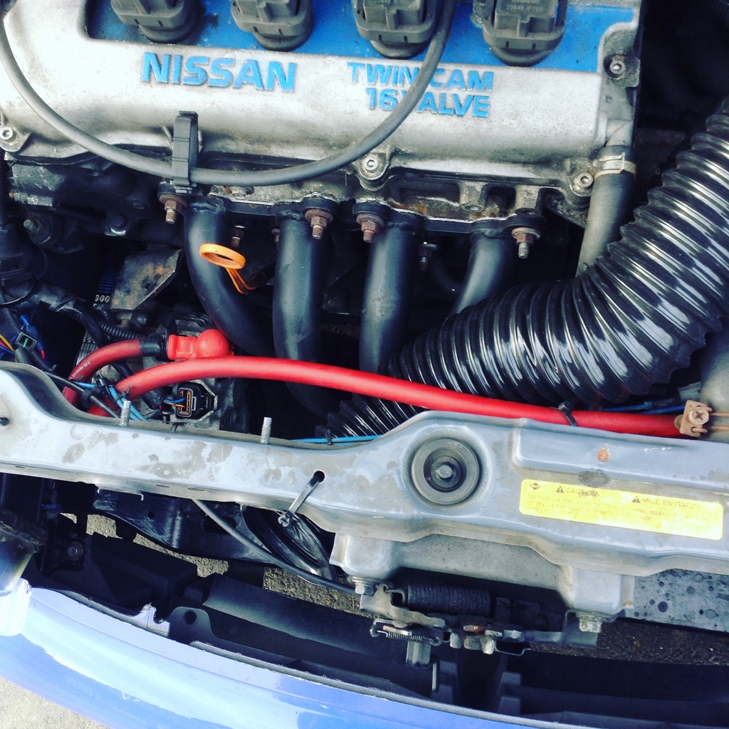

So on the Sunday also done the big 3 upgrade as I will need it to be running the system this big just helps get I think 25% better power to it took me a while also made up a bracket for the 300amp fuses trying to keep it nice and tidy rather than messy
So decided to then start to do a bit of the flooring so u can't see the frame
Sprayed the port hole black for now as well as when it gets covered didn't want it to look like ply still

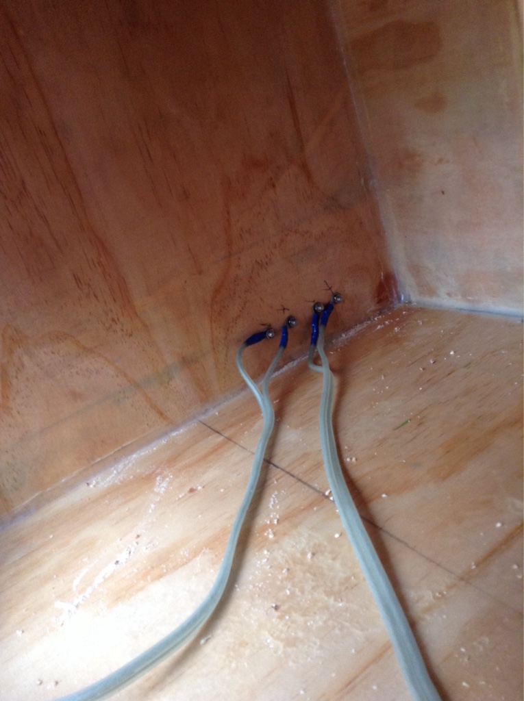

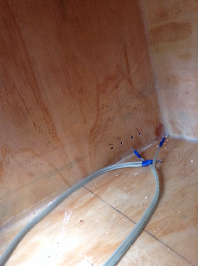

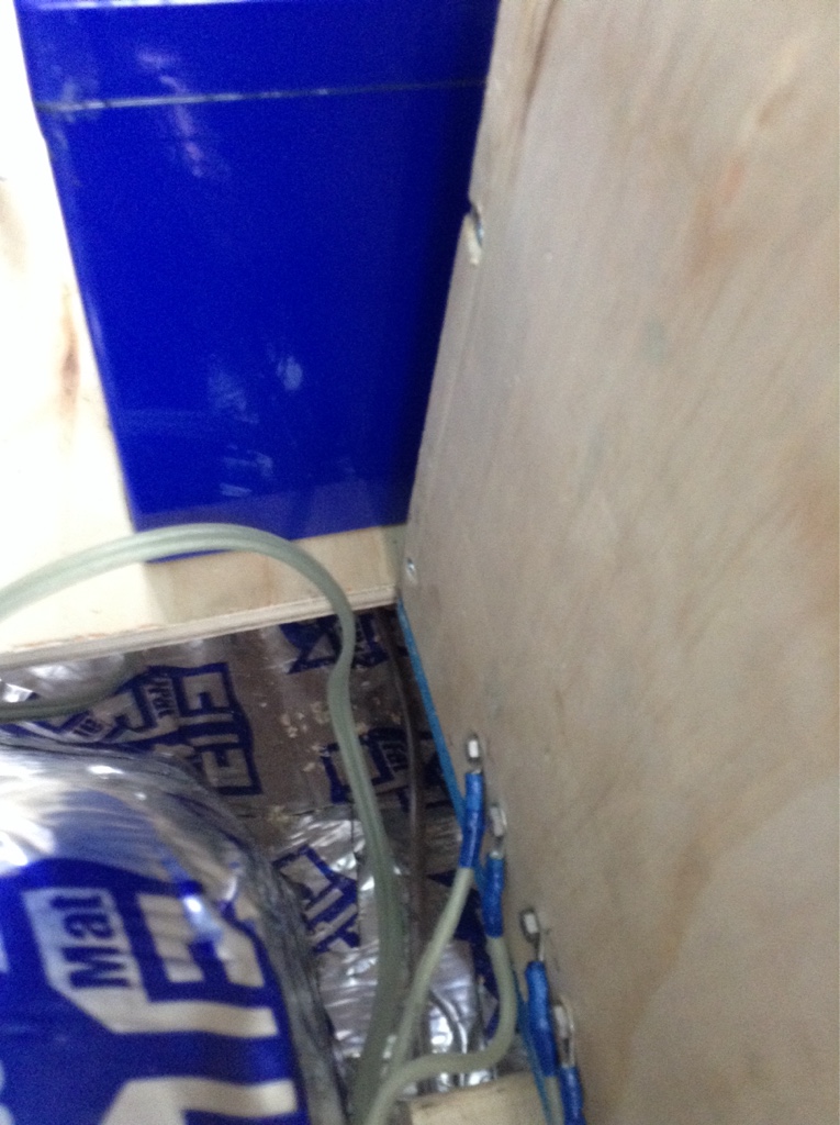

So next done the speaker terminals just drilled a hole to put a bolt threw and added ring terminals onto the speaker

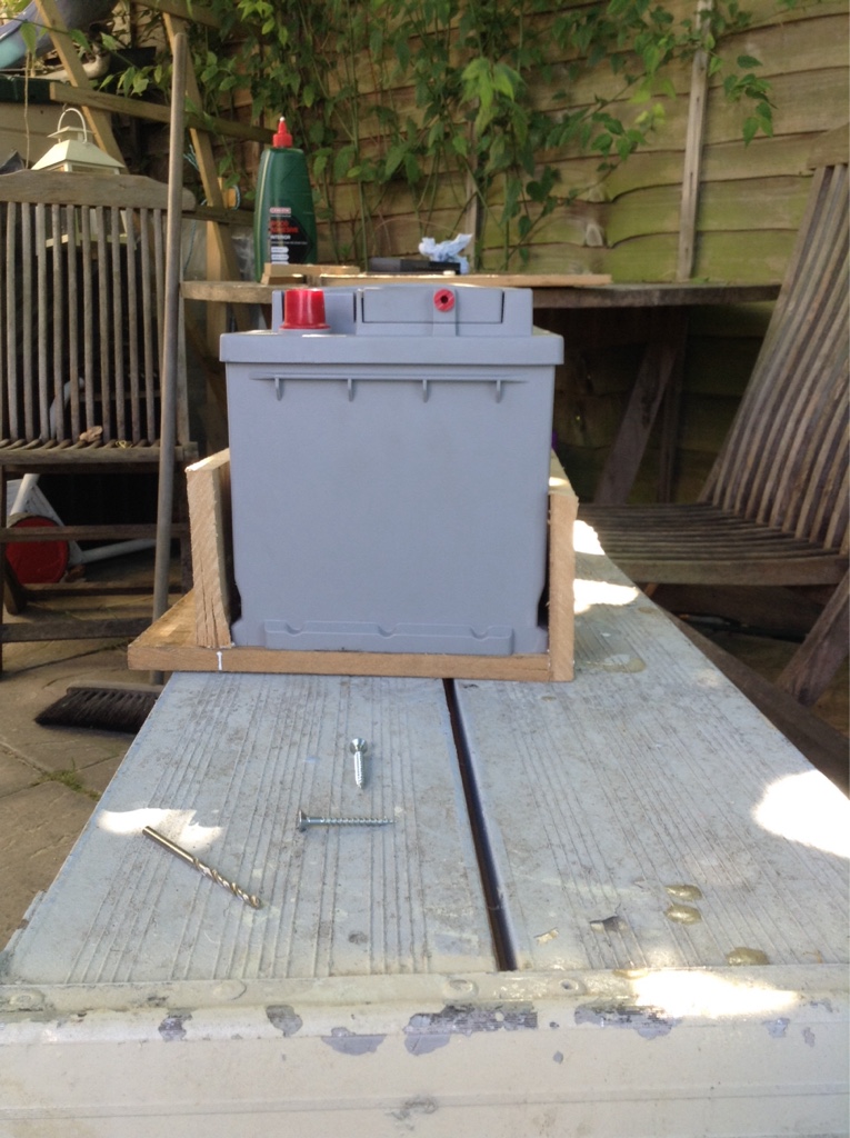

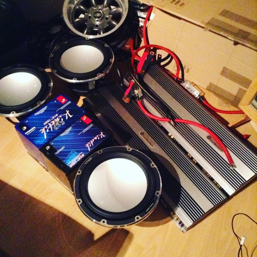

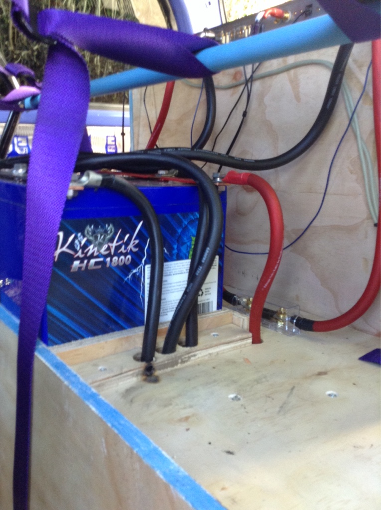

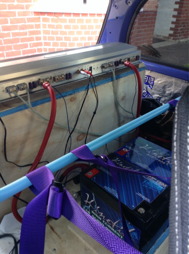

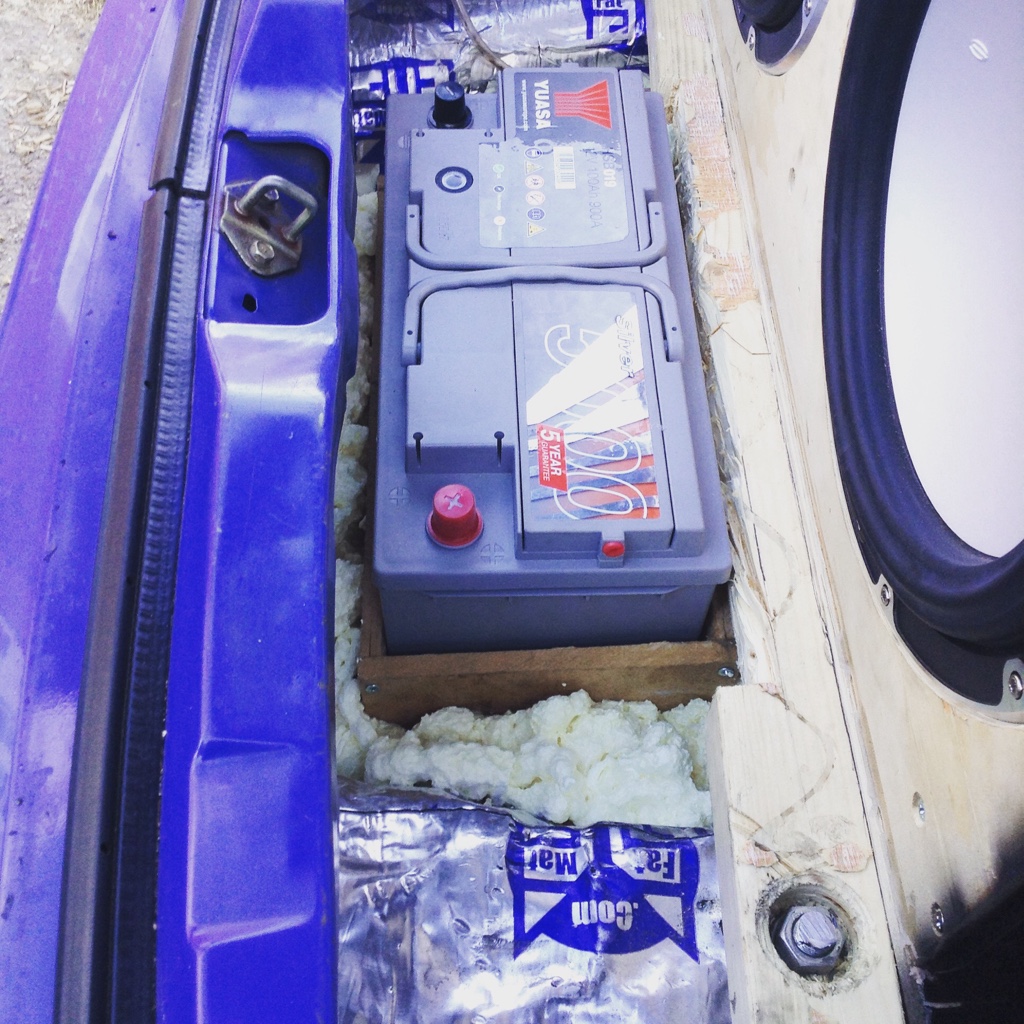

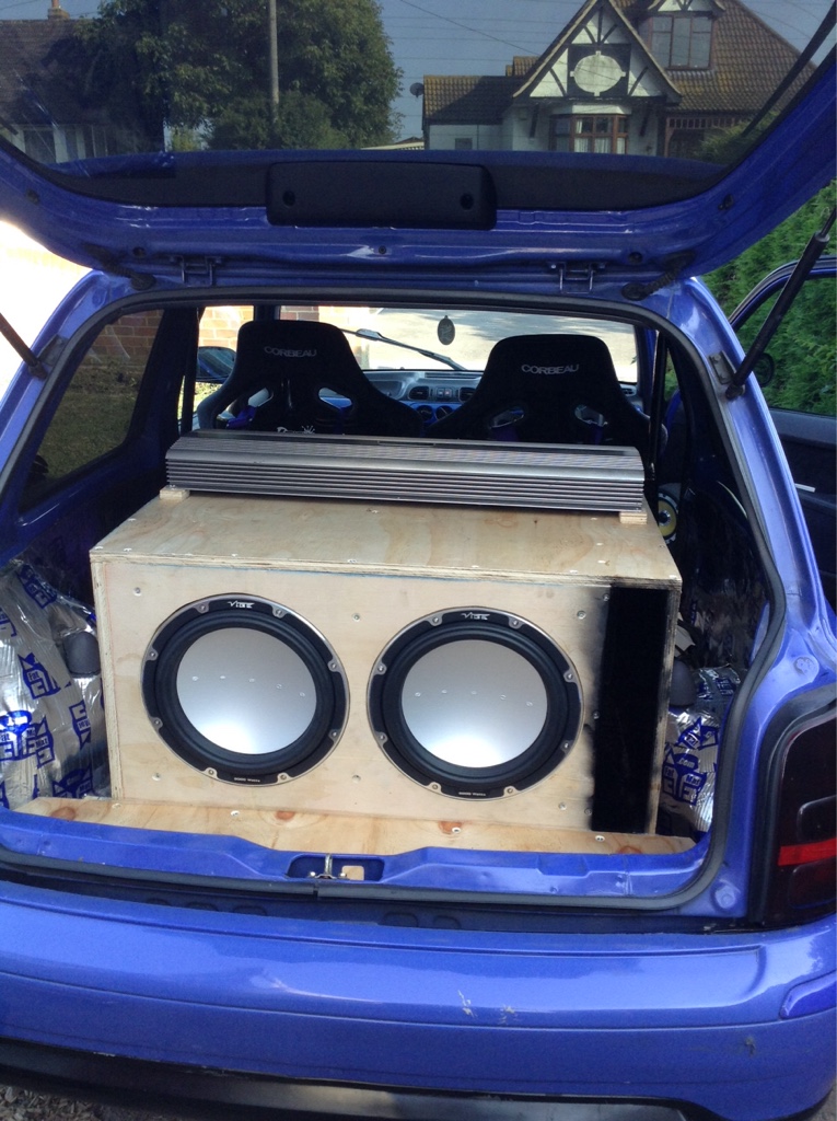

So after this started putting the amp and batteries in and mounted the amp temp for now so I could go to tunerfest at brands hatch and here's a video of the boot flexing
So now I have cleaned up some of the wires so it doesn't look as well

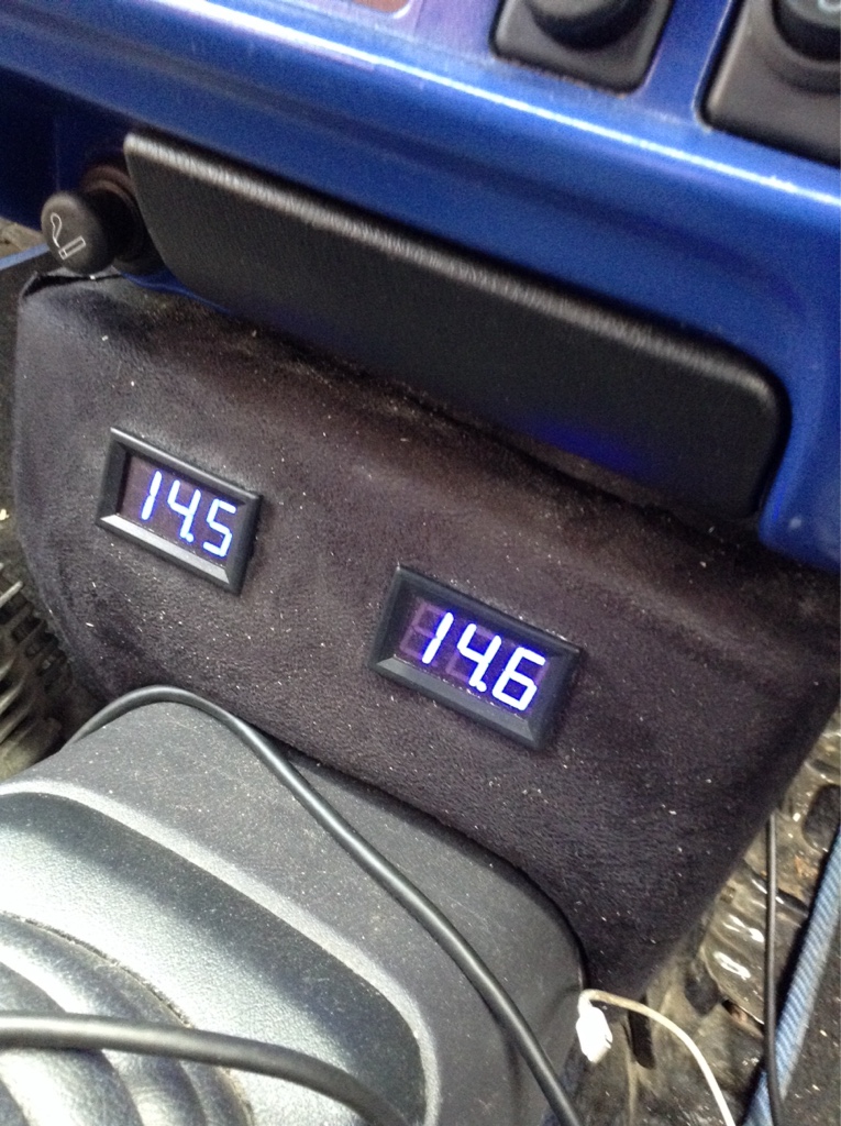

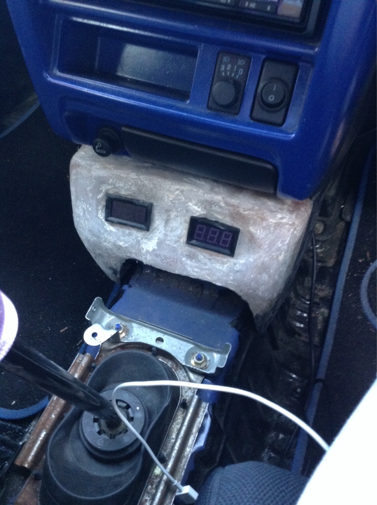

Also started building a pod for my volt meters well blanking off the pocket at the bottom of my centre console to put volt meters in

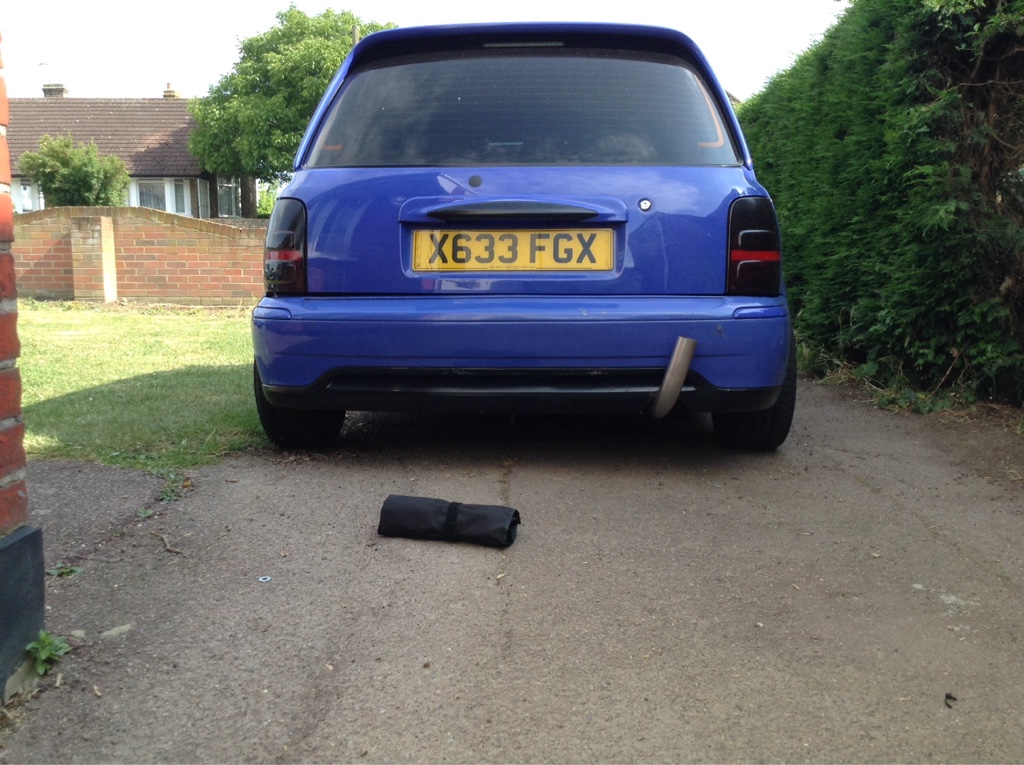

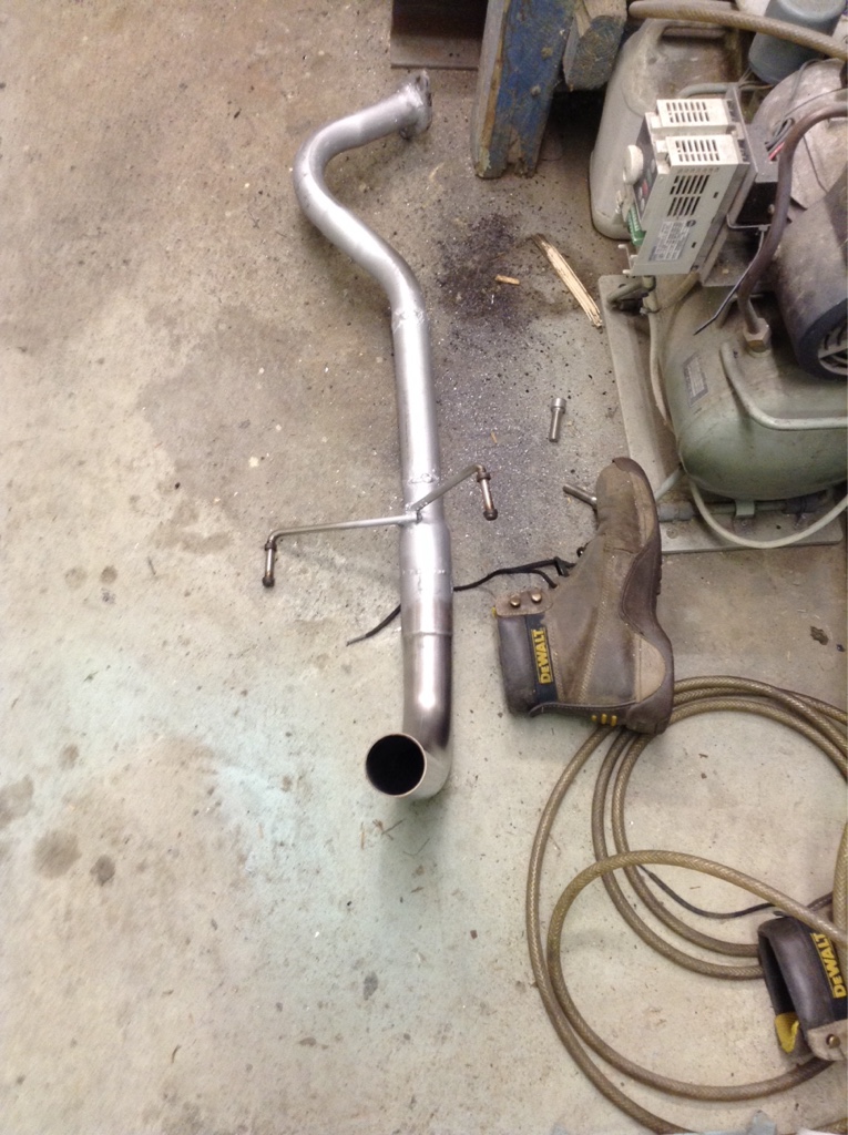

So yeah in the video of my boot flex I also had on my cumstom upswept exhaust
