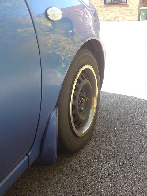

Wheels

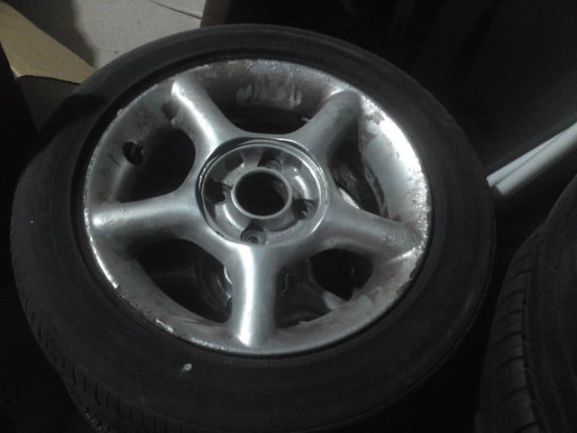

Got some new wheels a bit ago to use over the winter months. Bought mainly for the tyres as the old ones were going bare. They're 14" Wolfrace 5 spokes. Not put them on yet as the stock steelies are a lot of fun in this snowy weather we've had, a little slippy with some tail-out action too, but still very much controllable. Has put alot of sports-exec cars and white vans to shame passing them on hills and at junctions as they just sit there spinning thier wheels.
So these are getting a fresh lick of paint while the old tyres still have some use, then I'll put 'em on next week.
When I got them:
After sanding:
Painted, on car: next week maybe.

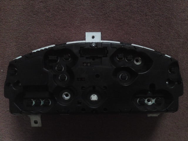

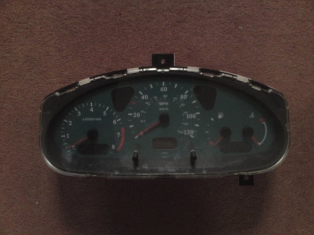

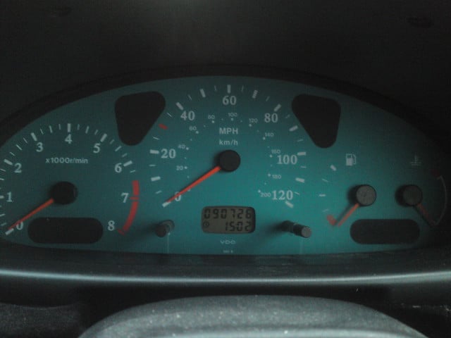

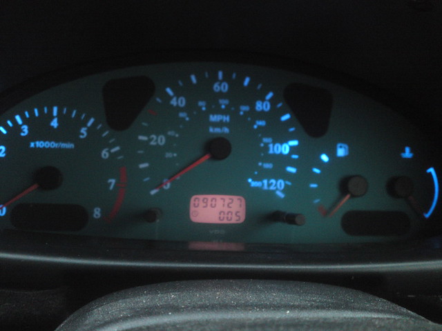

SI Dials
Another item I've been waiting ages for. Only seen about 4 SIs being broke for parts since spring, and either the dials have been sold or they're wanting £110+ for 'em. Thought sod paying that much, I'd rather go without the tacho or use an aftermarket one. But after an ebay search a couple of days ago I finally found a set, and got them with shipping for £15 -hell of a bargin imo. One tab was broken and a couple of bulbs were blown but other than that it was just a simple swap, no need for extra wires or anything. Only negative is that the displayed mileage has more than doubled:eek:, so I'm guessing it's the dial unit that stores the mileage as oppossed to the ecu which is what I've heard.
front:
back:
in car:
in car, lights on:

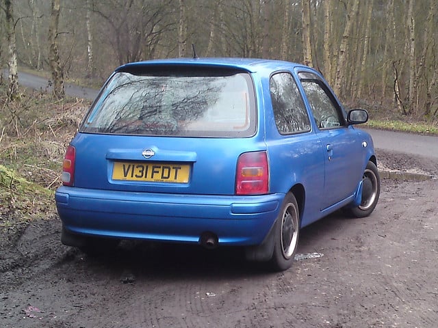

:eek: big update as my last posts didn't post :( Was nothing too interesting though so didn't bother to repost 'till now, bit of a copy'n'paste jobby too.

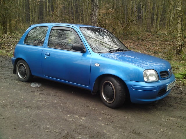

Pics of the car after xmas.
Quite like the height of the car now, I think it's sunk a bit since I put the springs on last year. Will have to remeasure but I estimate -50/55mm front with matiz rear springs, -40/45mm rear with cut front springs. Only on temperarly as corsa coilovers might be going on when I switch insurers, won't be 100% happy 'till the mudflaps scrape the ground :wasntme:
And a photoshop I did just to tease myself:

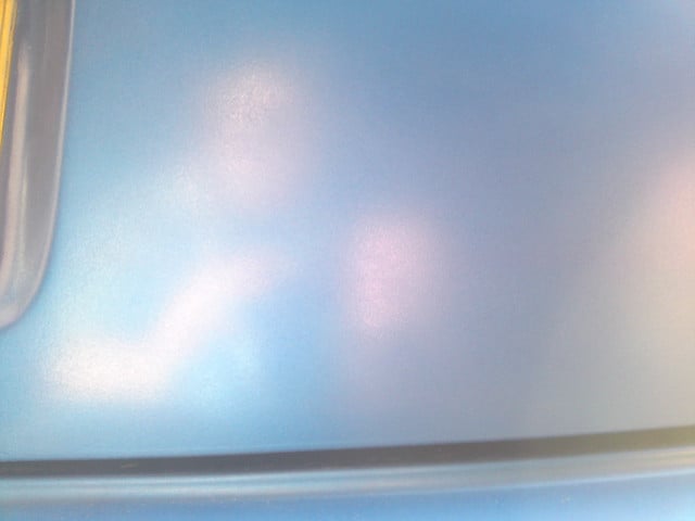

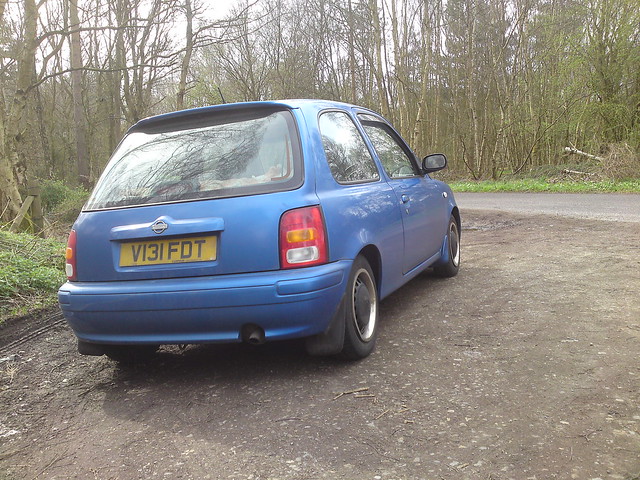

So anyway, winter hit the car quite badly, it's also the first one its seen as it usually goes into storage for a few months. So it resulted in some laquer peel under the rear window seal and since then it kept getting worse, I was never quite pleased with the rear as the smoothed wiper and lock wasn't quite as smooth as I'd like it and being a bit of a perfectionist I wanted to redo it, so I now had two excuses to repair the tailgate. Also colour-coded the original handle. It took a few days to finish and used rubbing compound and t-cut to bring up a mirror shine, it's nearly good enough, but it looks a lot better than before. Except I can't get the seal to go back in in one place :glare:
re-painted:
before rubbing down:
Also colour coded the front mudflaps with the rest of the paint from the boot. Going to remove the rears at some point, or possibly replace with some shorter ones, may even try and cut these longer ones as that wont cost anything. And I finaly painted the 3rd brake surround black to match the parcel shelf.

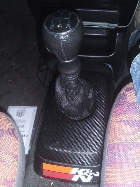

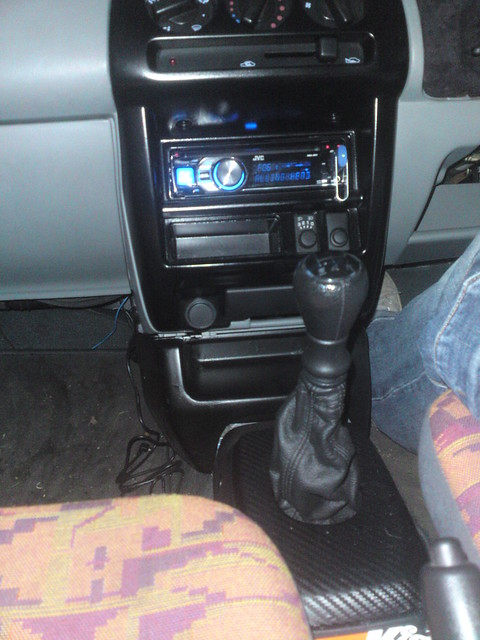

Have fitted a new knob, it came off a pug 406 and with it being leather-like it doesn't get cold like the old knob did. Fitted a leather gear gaiter too, and worked on the custom gear surround a bit more, got annoyed as there were still imperfections so I stuck some carbon-fibre vinyl over it that I got for 99p of ebay, looks alright for now imo. Might cut off an inch from the stick as I think it's a bit taller now, but I may get around to DIY'ing a short shifter. Also painted the centre console black too.
Would love to paint the rest of the interior black as well, but I don't have the time just yet, and it'll probably go wrong.

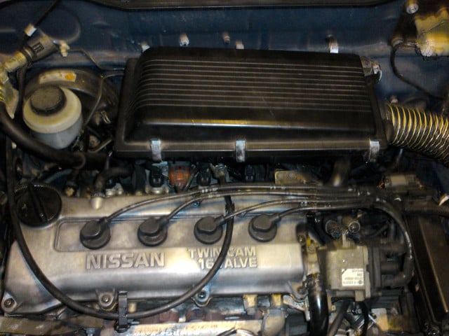

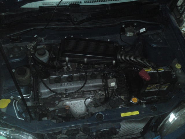

Over the last month I've been tidying and cleaning things, mainly the engine bay, but I did spend a couple of hours washing the body as it had been about 5 months since I last did it. What's ridiculous is that since then theres been zero bird crap on it, then within 24 hours of cleaning it, some birdy landed a massive one on the bonnet, happens every###in'time.

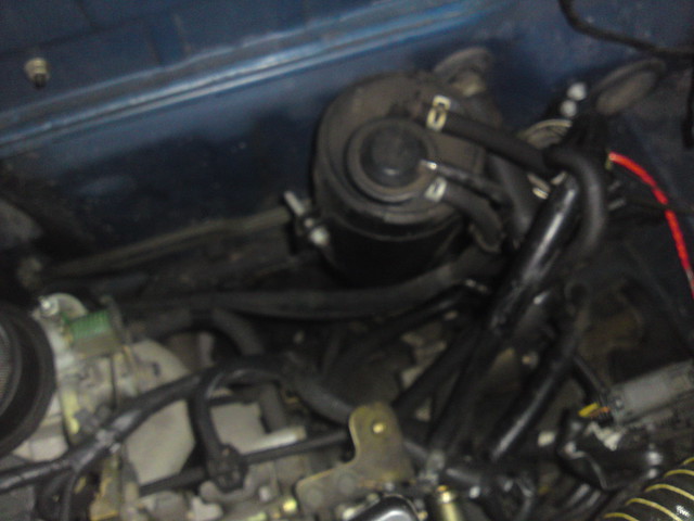

Anyway, there was a post not too long ago, but I can't find it now, about the carbon canister and how it's fairly unimportant, and with it in its original position it forces the ga16 airbox to one side. So I've removed its bracket and it's now hanging a little further down, it's still quite secure though as it can't go anywhere, but I may bend a piece of metal to be able to mount it before the MOT just in case, unless there's a way to remove it completely, only a couple of vacume pipes from the t/b to worry about by the looks of it.
carbon canister:
before:
after:

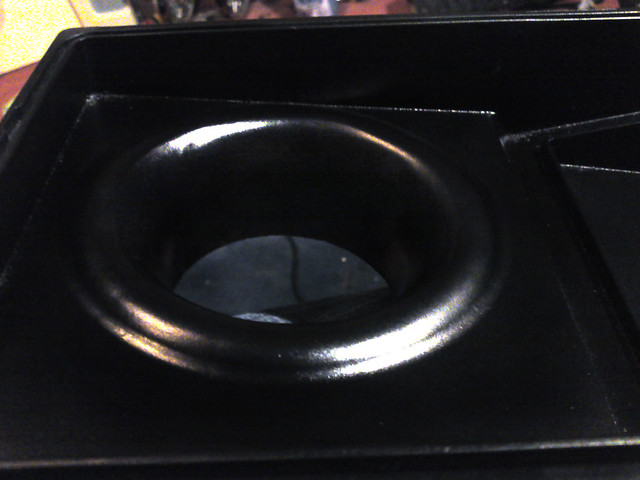

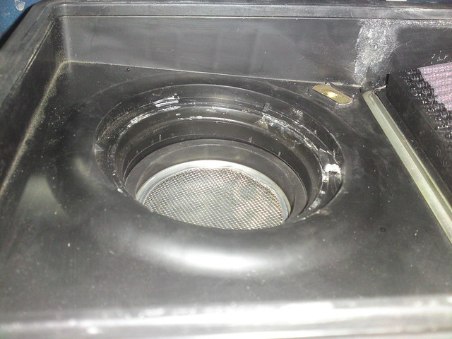

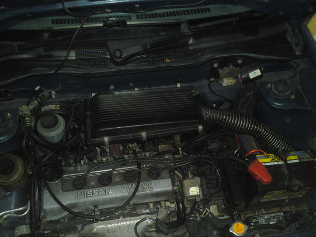

Also started some work on the ga16 airbox itself, as you can see it can't be a very effecient design at the minute especially as I snapped that curved ring that held the mesh on:
So I've dremeled it and smoothed it out, have also bored out the intake hole, filled in that small unused hole, removed the fins from the lid, I kept most of the baffle as that was too difficult to get rid of, trimmed down the pcb filter so it doesn't restrict flow through the air filter and removed the mounting hole which I may reposition to fit the stock mounting bracket.
after:
sanded off oxide crust from clips:
Result isn't bad, more responsive than before. But one problem I noticed with the ga16 box over cg10 box is that there feels like there's no overlap between torque and power, with the stock cg10 box I had on you could accelerate smoothly through the rev range, but with the ga16 box there feels like a reduction in power around 4-5krpm. I'm hoping it can be remedied with the use of a thinner and longer air feed or a stock ga16 pipe. But don't want to sacrifice too much high end power as an 8krpm limit is fun :wasntme:

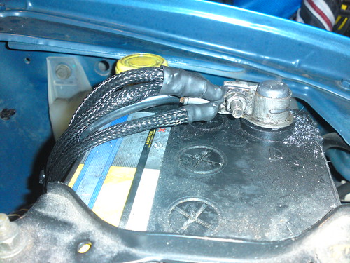

Have also tidyed up the power cables for the amp & central locking so it's just one insulated, covered and sleeved cable to a distribution box under the dash. Also wired up a couple of grounding cables attached from the battery to the dizzy and throttle body. All for no reason other than I was bored, had some extra wire, and was interested in if they'd be any affects with the better grounding.
Results weren't really noticeable.
Also wire brushed and cleaned the grubby-looking head cover and exhaust mani cover plate, oven cleaner worked well. Will polish them up a bit if I get time.

So this is how it's looking now:
Pics were taken a few weeks back but I've still not got around to finishing the rubbing down of the tailgate. And does still need a good wash. So it still looks the same, but I'll give it a good going over when I've got a day off sometime.

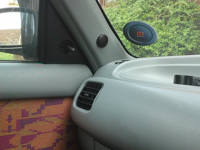

Future plans, I guess, for the next couple of months, are to relocate the tweeters that are currently tucked in behind the carpet to the A-pillars, fitting an almera cup holder(depending on price) and the sportier-looking Si/2ndfacelift clock surround and a wraparound spoiler if I can find any.

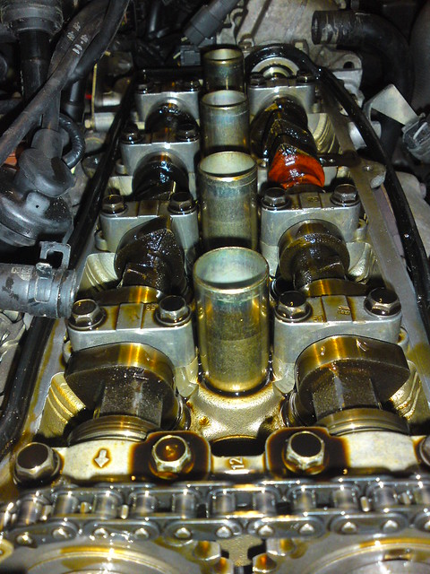

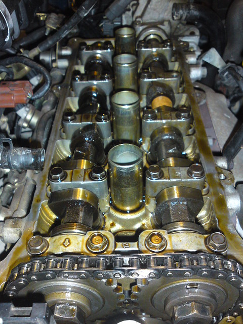

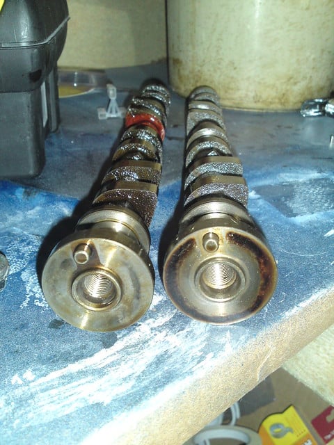

Have now re-fitted the 1.0 exhaust cam, trying to squeeze some more mid-range power n torque from the engine, has worked well. Runs a lot smoother and doesn't need to be revved as much to pick up speed, will happily get up to 60mph faster than most people tend to do, without exceeding 4krpm. Bad points are that it seems to stop incresing in power above 6krpm, which is a compremise that's fine for commuting I guess. Fuel economy seems a little better too over last few days, due to needing less revs but will see at end of this tank.
1.3 left, 1.0 right
1.3 in, 1.3 ex
1.3 in, 1.0 ex

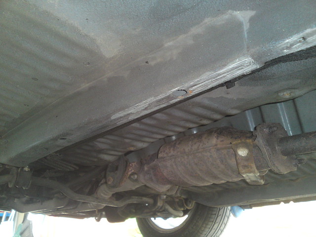

It's MOT time, nearly. Coming up in the next couple of weeks, and I'm a little worried:

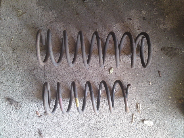

1. Rear suspension might not be MOT'able, I measured how small I can cut the springs before they become uncaptive and added an inch, but didn't take into account just how much the springs sink/compress, so now when jacked up there's a bit of play, so will have to return it to stock. But then the rear will be stock and the front will be lower, which may play with the headlight projection a bit too much.
2. Emissions, last year it scraped by, failed the first test and passed the second, and since I put in the 1.3 cams there's been a petrol smell from the exhaust within the first 10-20mins of running. Should be alright if I give it a run around before hand and it's not sitting too long before the test.
3. Tyres, I've got 4 sets of wheels, but not 1 complete set that will fit&have enough tread to definately pass. Might have to run odd sized tyres front and back, if thats ok? 2x 195/45/16 on front, 2x 165/60/14 on rear. But hey, it might just balance out problem number 1 lol.

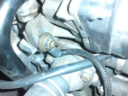

4. Carbon canister is loose, as I haven't been able to mount it, nor worked out how to remove it. Should I block off the throttle body vaccum pipes, remove them, or join 'em together. And what about the other pipe wherever that goes. Someone must have done this before, but search function's not working well enough.
Apart from that it should be ok:down:
mine was loose for it aswell, they dont care.
have you got the GA snorkle tho guys ? i think you get the same flatspots that you can get with induction kits, without it
No, I keep searching ebay for 1 to pop up but never seen 1, n I don't do breakers. But some universal ducting should be alright I would have thought, just got to get the width and length right size?? The 1 I have's too wide n too short maybe.
Oh, that's alright then, don't have to worry about it so much. I would have thought it would be a fail. Would still like to remove it mind, seeing as it's doing pretty much nothing apart from hanging there.

Result on the 1.0 exhaust cam is pretty good. With both 1.3 cams in I used to average around 30/40 mpg depending on the time(rush hour). On the same journey with the same driving style, but with the 1.0 exhaust cam I seem to be averaging around 35 in rush hour, and 50 when not. Which is pretty good I think. But I still might put the 1.3 back in, but retard it a notch maybe, I need a little bit more power:wasntme:

In prep for the mot I removed the carbon canister which was hanging without its bracket due to the larger ga16 airbox. So I joined together the two hoses that went from the throttle body to c/c. The one hose from the gearbox/gearbox area I left open near that existing open-ended hose clipped to the airbox, and the bottom hoses I just removed. All seems fine to me. I also forgot to refit the breather hose from head cover to airbox, so that was left open, but heard nothing about it.

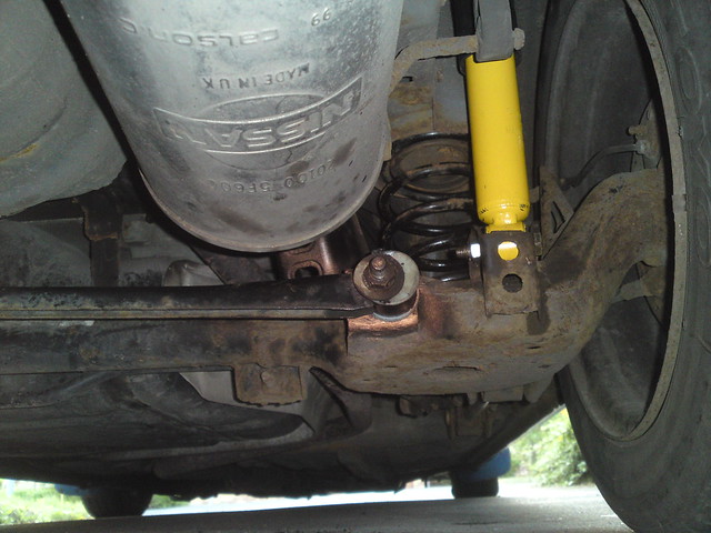

Left the cut springs on the rear as I couldn't get the stock(uncut) springs back on - too long! But still passed ok, got an advisory for them as they apparently become unseated when jacked-up, but they only become unseated for me when jacked-up and I lever them out with a big screwdriver though. But hey, they passed!
Here's a pic of the cut front spring against the stock rear.
So while I had the car jacked-up I checked out the damage caused by the lowering. It's nothing major just the sound-proofing/rust-protection stuff being being scraped off, couple of dents on the cat bracket and flange, and tufts of grass and twigs lodged near the downpipe. Mechanic also mentioned about the gearbox had been hit, or is close to being hit though which is a little worrying.
Doesn't look too bad in the photos.

And I have now relocated the tweeters to the A-pillars, just popped the trim out and cut a 30mm hole in each and glued the tweeters in from behind. And threaded the wires down to the component connection boxes in the kickpanels.

did u really see an improvement with the 1.0 exh cam? as i have one sitting about which i could make use of?
I wouldn't say it was an improvement, just it made the power band a little lower and smoother. With both 1.3s in I had to really rag it to accelerate to keep it in power, with just the 1.3 inlent and stock exhaust cam(as I have a 1.0 engine) theres just no need to rev above 6krpm, and will happily drive at 30mph in 5th.
So it's a bit of a compremise, sacfrifice a bit of top-end for fuel economy and comfort. Think i'm averaging around 40mpg, which isn't bad to say it's drinking like a 1.3 due to the 1.3 inlet cam.
But I think you could get a similar effect by retarding the exhaust cam, so I might put the 1.3 ex cam back in but 1 notch out, so hopefully have more power, but still get a smoother power band, but I don't know if that will work out too well to do it yet!
Got kinda bored with the 1.0 exhaust cam, it was good in a way but I missed revving it and it was slightly more difficult to overtake too, so out it went and I put the 1.3 back in. Which has got my 0-60 down to a much better level and overtaking is alot easier too. Doesn't quite have the pulling power though, drove it fully laden with a full tank and three passangers and just thought it would have been smoother and better with the 1.0 ex cam.

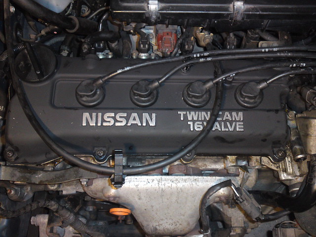

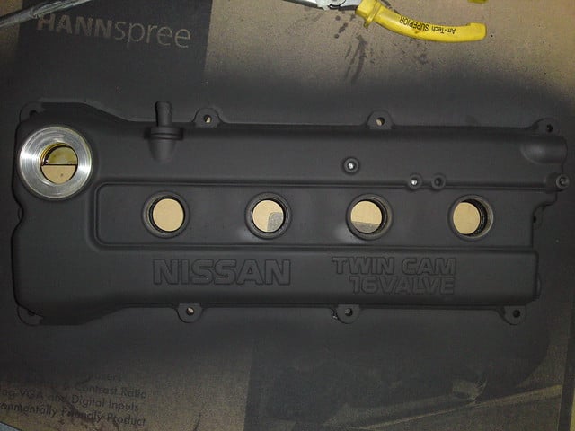

So while I was re-installing the exhaust cam I painted my rocker/cam cover. Just out of bordem and curiosity really. Painted with a high temp black spray paint, nice n subtle.
Removed 'L' pipes for breather hoses, and unscrewed black ignition-lead clips. Used a lid cap to cover the oil filler cap area, and golfballs to cover the spark plug holes, only masking tape was on the black plastic hose connector I couldn't remove.
Dried a little paler and to a matt finish.
Removed paint from the letters with a screwdriver and installed.
Wanted to paint the exhaust heat shield too but one bolt is rounded and won't budge.

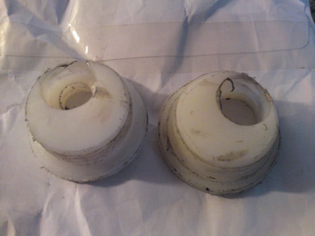

Franks offset panhard rod bushes, thanks Frank(Y)
Not fitted them yet, planning on going a little lower first.

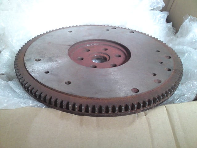

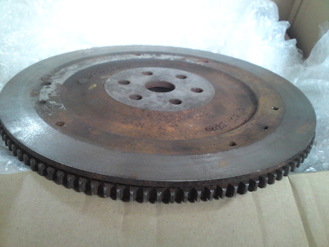

Hooded Reepers light weight flywheel, thanks Hooded(Y)
Weighs in a 4.5kg, apparently. I make it almost 5kg, but I'll assume I'm wrong 'till I try something better than 10year old kitchen scales:laugh:

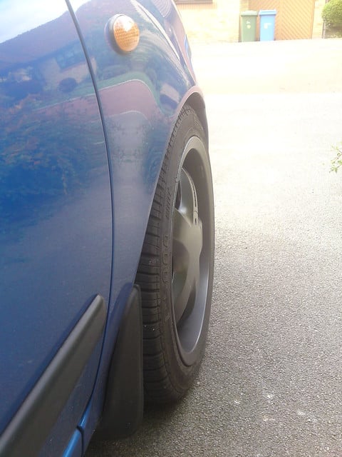

Adjustable, so I can lower it so low its undriveable! but I settled for a little higher than that:p But it's still quite low and would scrape the curb driving off and onto the drive, as well as every other mound in the road and I even had a flipflop get stuck under the front bumper driving home, so I've settled at the ride height above. Although it may have a sunk a little bit since.
So now the top of arch is about 30mm above the rim on the stock 13"s steelies. But with them being tucked in so far you can still turn like regular. Corners now don't exist as there's very little to no body roll, so that's fun! Ride comfort at the minute is bad as the springs on the rear are far too long and the shock sits at it's highest. Comfort from just the front coilovers alone is really good, not bouncy as it was on stock shocks as there's little movement, but it's still soft and glides over most bumps. I'll be cutting the rear springs in about half, they should still be captive and should lower to about the same as the front hopefully.

The rear dampers took a little longer, and again, neede to remove stock one for parts first.
Corsa damper from coilover kit.
Add the plastic disc it came with.
With the rubber cover and built-in bush, over the top.
Metal washer supplied.
Micra top.
One half of corsa bush.
Second half replaces micra bush within the boot. I'll be replacing the nuts with nyloc ones soon.
Damper extension.
But before I can fit them , the metal edges on the lower bush needed to be filed flat, and the m12 bolt replaced with a m10.
But now three wheels lift off the ground while jacking up one corner:laugh:
All of this above is not a diy guide, the corsa coilovers I have and the stock dampers I have can and do differ to other peoples, so I do not recommend you copy the above, but I thought it would be atleast a bit more educational to those thinking of doing something similar. :blues:
Fitted Franks Panhard Rod offset bushes, thanks again Frank(Y)
Original bush was a ballache to get off, ended up having to use a drill to mess up the rubber while spraying wd40 in it, then refitted it without the washer so the bush was stuck behind the nut, then with a big tug it started to move then popped completely off, which caused me to scrape my arm on the exhaust which was nasty.
Hope I got it on the right way:wasntme:
Good stuff. Thats fapping low.
Tuck is indeed the new poke*. narrow high offset 15's or 16's with tiny tyres might look rather good up in the arches like that.
It could have a kind of narrowed beam air-cooled look to it,
*I've never been very fashionable
Don't put anymore ideas in my head mark:p Do like those pics though, but don't think it would work with my micra, have you got a pic of a micra like that? might suit a primer finished one for a half assed, half finished look.
:laugh: mini heart-attack over, was not looking forward to redoing that. And I picked up on the edit so I copied and pasted it in for our amusement:p
