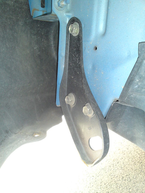

Got a better photo of this thing, no idea what it is, there's one on each end of the crossmember, it's what scrapes the ground the most. Safe to remove?
Yeah guessed it would be but I have an ordinary toe eye and I've not seen them on any other k11s on here before. May remove them next time I'm under there, I'll still have the toe eye so I should be fine.
Yeah mckenziecz had the same troublesome things on his SR... gives me an idea to remove them off of it now before i get it back to lowness (Y)

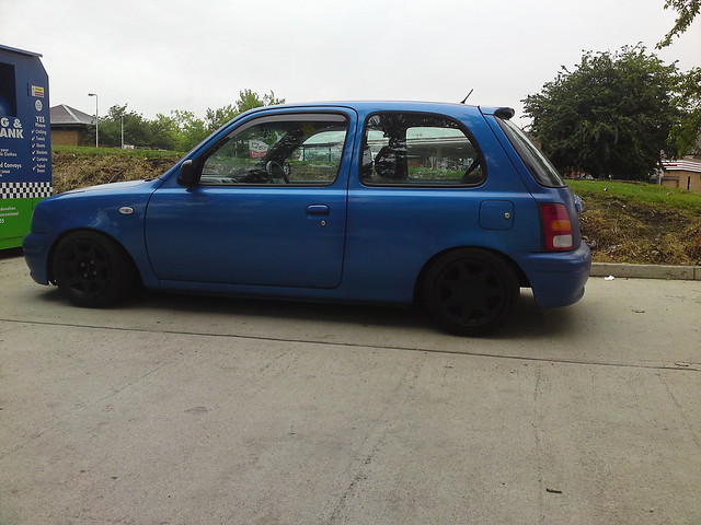

Went shopping today and loaded the boot up with a weeks worth of groceries, and the rear wheels scrubbed alot, almost all the way home for the rear n/s. Also drove with a passenger in and rear n/s again was scrubbing alot. On my own and they're not bad only scrub on bumps while cornering. But something needs to be done as I've obviously made it less of a 'daily', than I wanted. Got the option of DIY flaring, and or spring assistors, or tougher springs. I think either of them would solve the scrubbing and make it a much better daily car. I like it low, but needs to be more useable:wasntme:
Turbo build is coming along nicely, nothing new yet, but got a few things in the post and lined-up. May try and get it running at very low boost sooner than I thought, but certainly not going to rush it.
if its scrubbing on one side i would suggest thats the panhard not set correctly! also them tow bits you removed id keep them on as when they hit the floor you know nothing else is like your sump, bumper etc.... i have grooves in my floor from the college speed bumps
Going against the grain here but isn't the slammed look rather outdated now? Reminds me of the US Civic ricer croud owned primarily by Mexican's, (not a racial slur!).
The sacrifice in terms of handling is a blatant burden, plus all the scrapages that it brings, especially with aftermarket wheels and tyres. I won't even get into the details but I would bet that would be an absolute pig to drive if you were pushing it. Good handling in a K11 is quite a long way from where people think it should be...
If you really do want to run that low you will need an adjustable panhard rod to cater for the lateral rear axle movement. A set of adjustable trailing arms would also help to put the rear wheels back in place and to stop the rear wheels from potentially hitting the front of the arch under extreme loads, (maybe still ok with 15" wheels though). Also it would be good to invest in a castor/camber kit for the front to help put the front back towards where it should be.
Panhard rod is about as good is it can get, the little amount of poke I have is equal on both sides. Typically it's the o/s that scrubs when it's lowered and not corrected. It's the whole rear suspension setup that's not suited to that drop or tyre-arch gap. I've not removed the tow brackets, and can only remove the one really. And they only scrape because they're so far infront of the wheels, and they're not going to protect the rest of the car. How big are your speed bumpsfwn I don't even have grooves in my floor, some soundproofing scrapped off on a couple of big ones though:wasntme:
Being low is not a trend *that's a bumper sticker idea right there eh* it's just personal taste, maybe, form over function.
I know what you're trying to say about the handling. But it is just your assuption and you've not drove my car, clearly, as it really isn't true in my case. The handeling is much MUCH better than stock, I'm not even close to the limit it will take, I've not understeered with the coilovers on once even when I've tried too, body roll pretty much doesn't exist compared to stock and the twitchy feeling with wind resistence has gone too. I'll admit it's not going to be the best and its certainly no race car but its not intended to be one, nor do I use it like one, it's just supposed to be low and nippy around bends without sacraficing too much comfort-which I haven't, which is perfect for me:) Scrapages due to ground clearance only happen if you're going over bumps or uneven ground but is nothing severe, got to be sensible though. Tyre scrapages have only really become apparent with a heavy load or passengers yeasterday, which I do need to get around to fixing before I go shopping again, beer is heavy.
I really can't imagine the rear wheels hitting the front of the arch, if anything the trailing arms would be shorter to stop them from hitting the rear? Not arguing with you mind, you know more about suspension than me, I'm just thinking logically. It does appear they're further forwards in the pic above, but that would be due to the mudflaps that I've removed and which come as standard which the designers would have accounted for I'd have thought. Fronts are about right, they do have more negative camber than stock which inadvertently brings some toe-in, but for road use is fine, and tyre wear is fairly even.

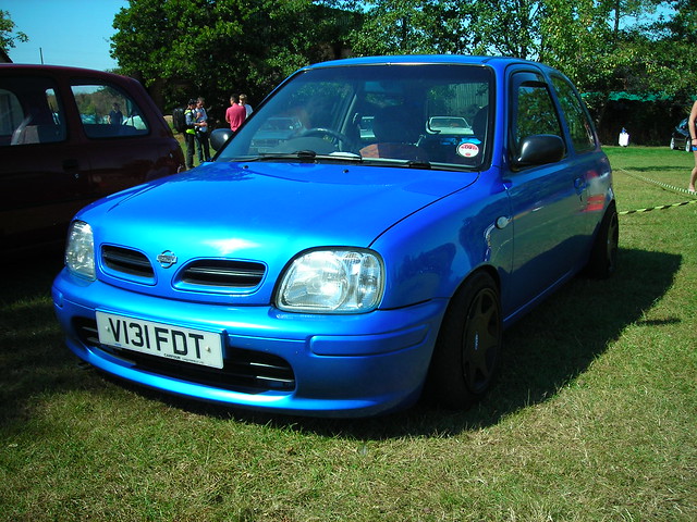

Here's a couple of pics of it at the Retro Rides Gathering.
More of my pics of RRG in the RRG thread here.
It managed to get some attention even amongst some very cool retro cars. Mostly pointing at the rims. I think all our micras got some attention for our wheels. Frank on his reversed steel rims, shaun on slot mags, jessy on starmags and will with his minilites albeit in his boot. Was a very nice collection.

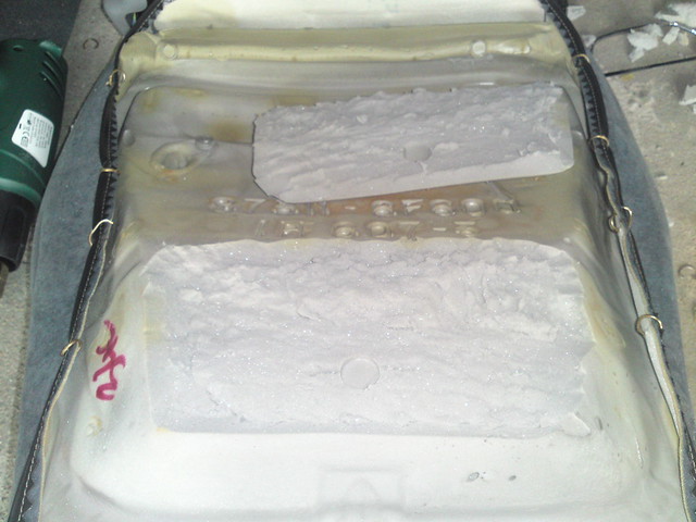

Today though I've done some work to the seats. While they're quite comfortable on straights I feel perched ontop of them rather than sat in them, which is not so good in the corners. Plans were to by some supers/sr seats, got offered some for £30 quid but that was the car that got scrapped before I could get them, and I hate paying more than what's been offered before.
So I've taken the drivers seat out and removed some of the foam from the base to help me sit lower and more 'in' the seat rather than on it.
I've also bent the wings to help raise the bolster. Also did a slightly milder bend on the passengers seat too. after / before
And I've added strips of old car carpet between the frame and the foam to build up the bolsters on the side and shoulders of the back.
Result is pretty good, just how they should be imo. I could make them more bucket style by removing more foam but I'll see what the comfort is like on longer trips in these first.

Have taken the drivers seat out again since the previous update. When I curled the wings before, it raised the bolster but there was too much foam and it raised me up a little.
So last week I used a heat gun and a hammer to curl up the wings further and push them outwards. I've added carpet too to extend and soften those wings. I've also removed more foam to make it lower and replaced some with used carpet to firm up the bolsters too.
Result is pretty good, it has still retained it's comfort but is much more surportive now. The passengers side is still the same as before and it shows when cornering hard:)
