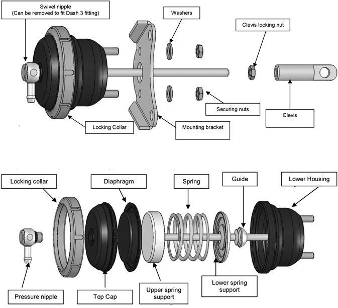

Right so that spring then is putting force on diaphragm towards the boost pipe at top. If I put a weaker spring in mine I can reduce the boost levels. Can I not adjust anything for now?
Where would I get springs from? How would I know what would fit?
yes, the spring is pulling the rod fully back, and the boost pushes the rod outwards, the extra spring assists the boost pressure in pushing the rod outwards.
you can use some scales to measure how strong a spring you need
What try an pull the rod out with luggage scales on the end and me holding the other trying to pull apart from each other. Like this? Well same principle. Except person in middle is actuator and the two pulling are my hands haha

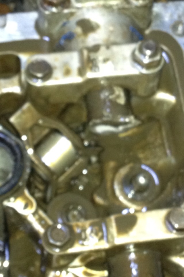

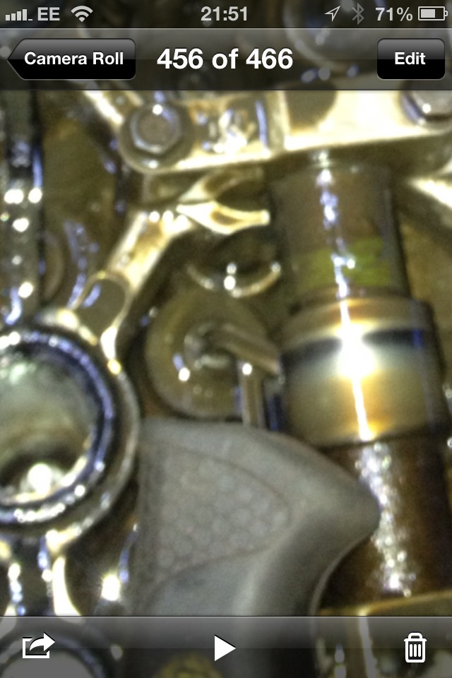

What are the metal things that sit onto of valve springs under rocker arm??
God knows. Basically got valve spring and metal battery size sits in middle one facing up and the other valve one faves down. See pic above. The rocker arm is then placed ontop of it
Sure you don't mean hydraulic lifters?
That engine is not looking very well. I'd seriously just replace it with another one.
Those are shims. One is keyed one is just a flat tablet shape. Get them on the wrong way round and they snap, rockers then fall off and all hell can break loose. Still think your on a hiding to nothing long term with this - sorry to say.
is that why my cam snapped?
i prob am and ive got spare engine and gearbox in almera but want to see if i can salvage this tbh. Ive bought a cam anyhow should be here friday and just need two shims now but dunno what size they are and what order they go in!
It doesn't matter, it has hydraulic lifters. But you need to make sure you get them right, you can tell by looking closely.
The variances are tiny. Nothing like that at all. You need to read/get the sr20 service manual.

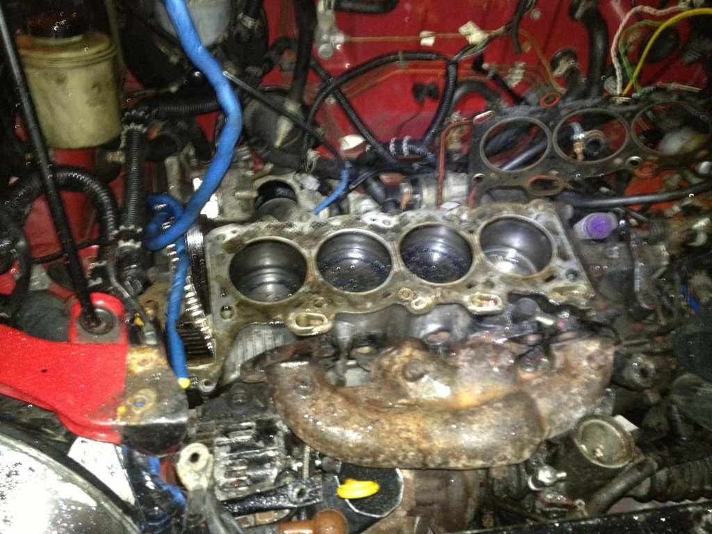

Gonna try this repair over weekend and if it blows again ill be swapping engines over and getting the Ecu to Ed and when it's fitted back in ill be driving it down to Ed for fine tuning and dyno!! It will prob be very soon this though haha!! Worth a go though trying to fix it

Back up and running perfectly again thanks to previous owner who came from stoke to repair it! Had full service too! New spark plugs, new oil flush then drained and new oil filter then proper oil in
No bent valves. We had some spares just incase.
They have had this setup in for 6 years no problems. Been in a Almera, a primera and this micra.
Cam went due to shims being fitted in wrong sides. The rocker arms have thinner bits on one side so it sits perfectly. When we fitted ours we basically forced the rocker in the shim causin it to crack and come off and hit cam and snap it! Replaced rocker arms, few shims and the whole cam. Had to retime it all too

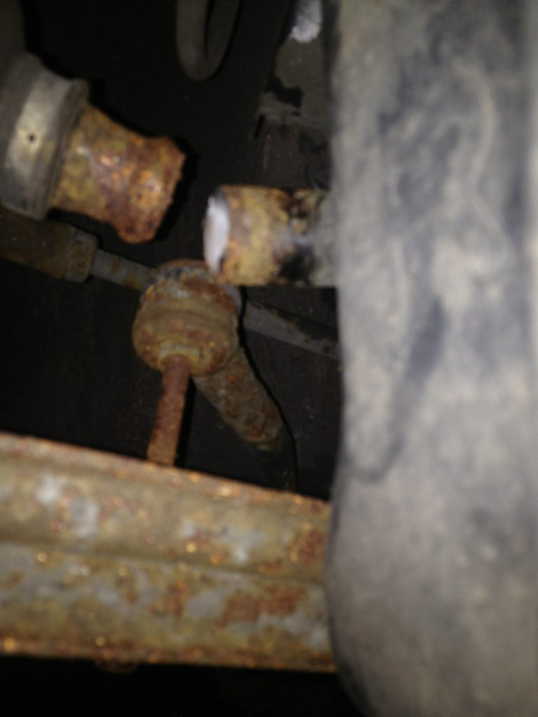

Drove it tonight. Bit of boost and snap goes drivers driveshaft. Grrrrrrr
