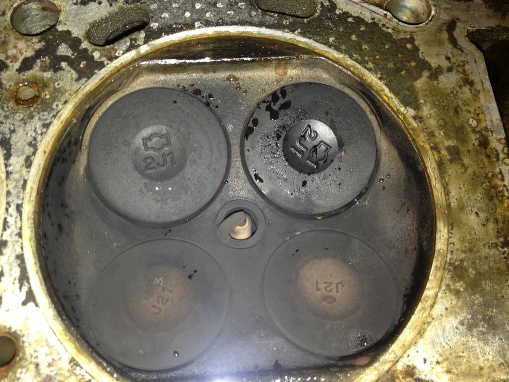

That's the cylinder where I had the head gasket leak. Cleaner than the others!
2nd pic is the one of the other cylinders

After much debate after speaking to Ed. I've decided to get head skimmed and get a new head gasket for it. I was going to replace the whole engine out of my Almera which I still have and then get it down to ed for remapping an dyno but I cannot afford that much as I going Australia for a month in October so need to save a few grand for that. If it goes pop again then ill just have to keep it off the road until I can save up for it to be remapped and done properly.
