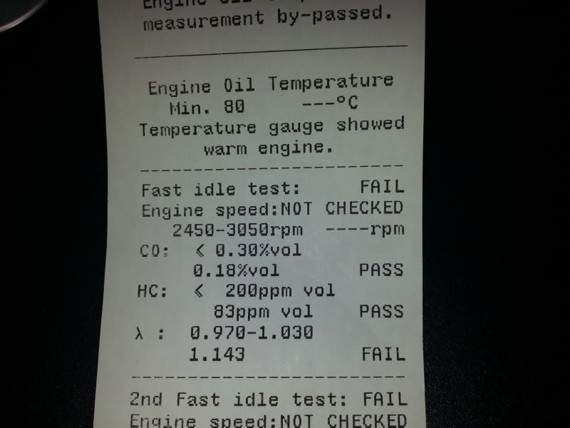

Well i convinced the old boy to buy a emissions tester so i can play around with mapping to see how it affects it and managed to get the following
Was speaking to stani and he had the idea to rescale the injectors as the cars runningn lean to bring the lambda into line

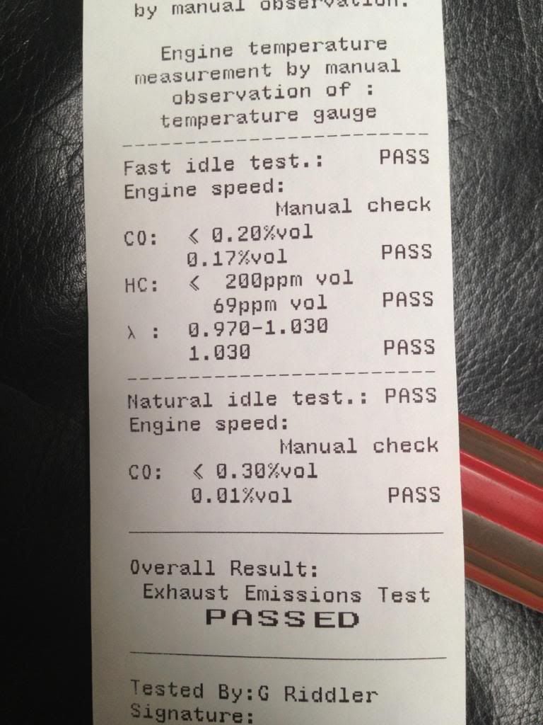

well I bought a P10 egt non nats Ecu off of eBay and swapped the pins on this and it ran great.
I then pulled the loom apart and found the Lambda wiring and got that all wired back in as I had cut it off by accident before.
After tidying everything up in the engine bay and making sure the radiator fan was working properly I can happily say the cars emissions are great now
co = 0.21%
HC = 44ppm
lambda = 1.020
so there is a few things left to tidy up for the MOT then it should fly through!
