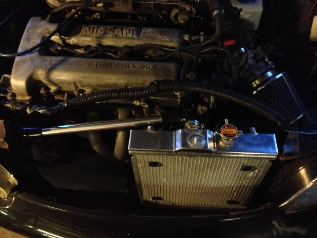

What and how you fix the radiator?

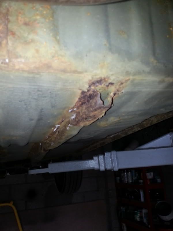

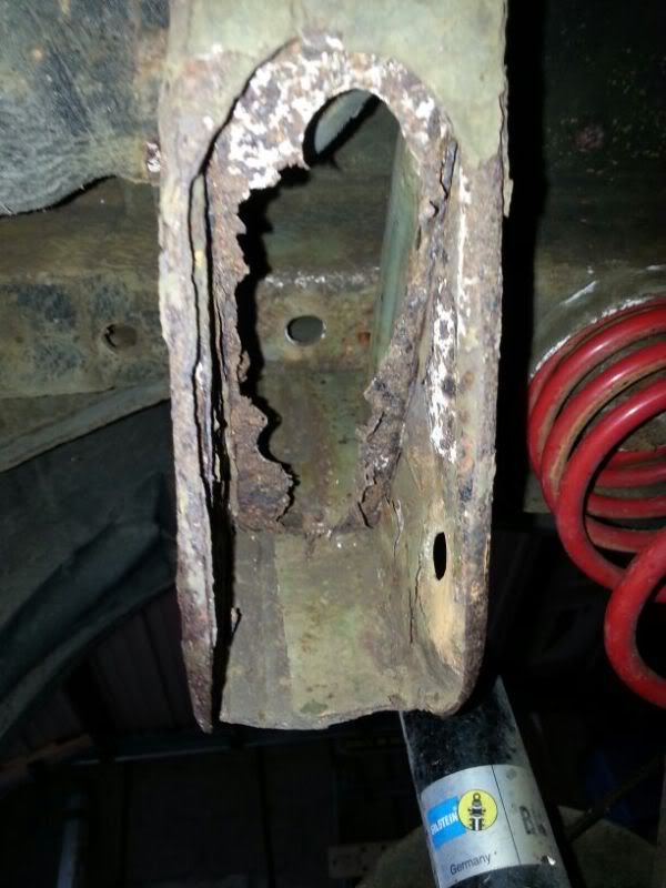

Getting there man. Ah you got the rust bug tooWell got the car on the ramp and had a good look at the car and only found a few of the issues i cant seem to find the issues with the rear suspension mouning points excessivly corroded.

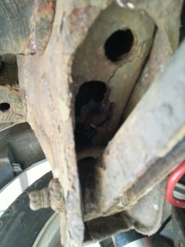

So here is the rear panhard rod mounting bracket issue.

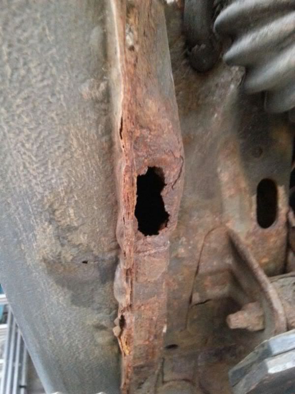

Found a hole in the passangers side rear sill
I wonder if the chassi rails might have been the suspension mounting problems
One side
Other side

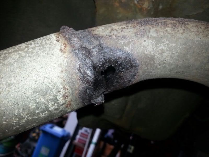

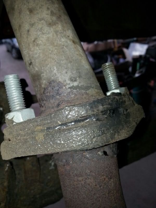

And found a few holes in the exhaust so need to weld them up
So if i sort the holes in the exhaust then the emissions should be fine
And welding up the rusty bits isnt that difficult either so should be on the road soon
