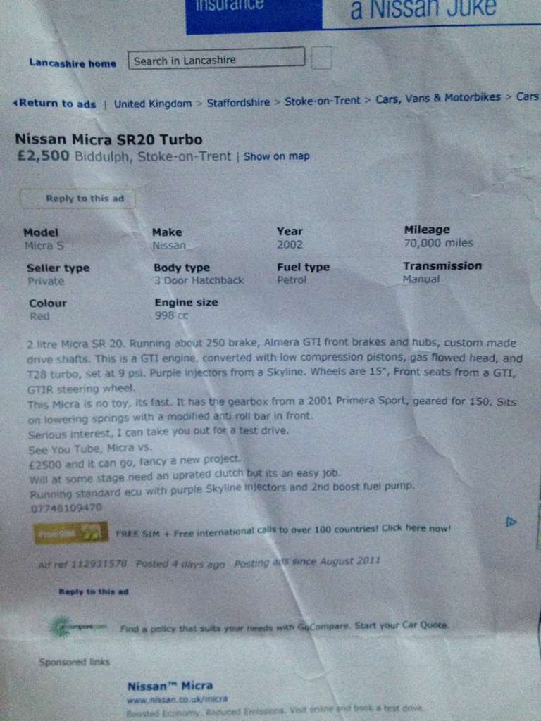

what engine management is it running andy ?
Standard Ecu Apparently
2nd boost fuel pump , unusual approach eh o_O
a dyno run would shed some light on whether is running safely eh (det free)
Dunno about 2nd boost fuel pump. What does it do?
I want to dyno it but with the clutch slipping it will just give false readings.
Need to uprate the clutch but I don't know what to get! It's a primera sport gearbox 2001 and the guy says any almera Gti clutch will fit
i,m guessing he has plumbed in a 2nd fuelpump that kicks in via a boost sensitive switch (a new one on me !)
and the slipping clutch has been doing you a favour imo, i can watch my boost needle drop when my front wheels loose traction (you would think that it would do the opposite, but its because the engine load falls away when the wheels spin)
you have to bear in mind that our cylinder peak pressure soon after top dead centre is about 1000 psi, and det can double that figure (ringland/headgasket busting pressures :) )
there is a switch by the throttle cable when on full throttle it touches it and activates it.. i pressed it when it was idle and it bogged down and if i held it on it stalled.. so i guess ur right and its throwing more fuel in on full throttle!
i have a boost gauge but its in kPa and i aint a clue what that is in bar or PSI. apparently its running 9psi but the max ive had the boost gauge show is 70kPa
<--- click that and look next to throttle cable. thats the switch
100kPa = 1bar, so 70kPa would be 0.7bar or 10.15psi
ah right cool! i think it was 70kPa or might of been 60kPa. to be honest im looking at the road at full boost haha i darent take my eyes off the road tbh haha
heh, thats even cruder than my ghetto setup :D what were you racing when it blew andy :) ?
