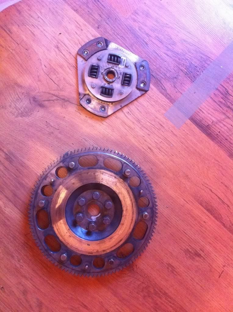

i hope so frank, if only i knew that theres a free group a airbox under my dash eh!? i forgot to mention my flywheel that went on a diet will be fitted aswell (3.4kg's) also helix clutch, blue sfs engine hoses, oil filter relocator aswell. i do plan to add up the costs of this whole micra as ive kept most reciepts.

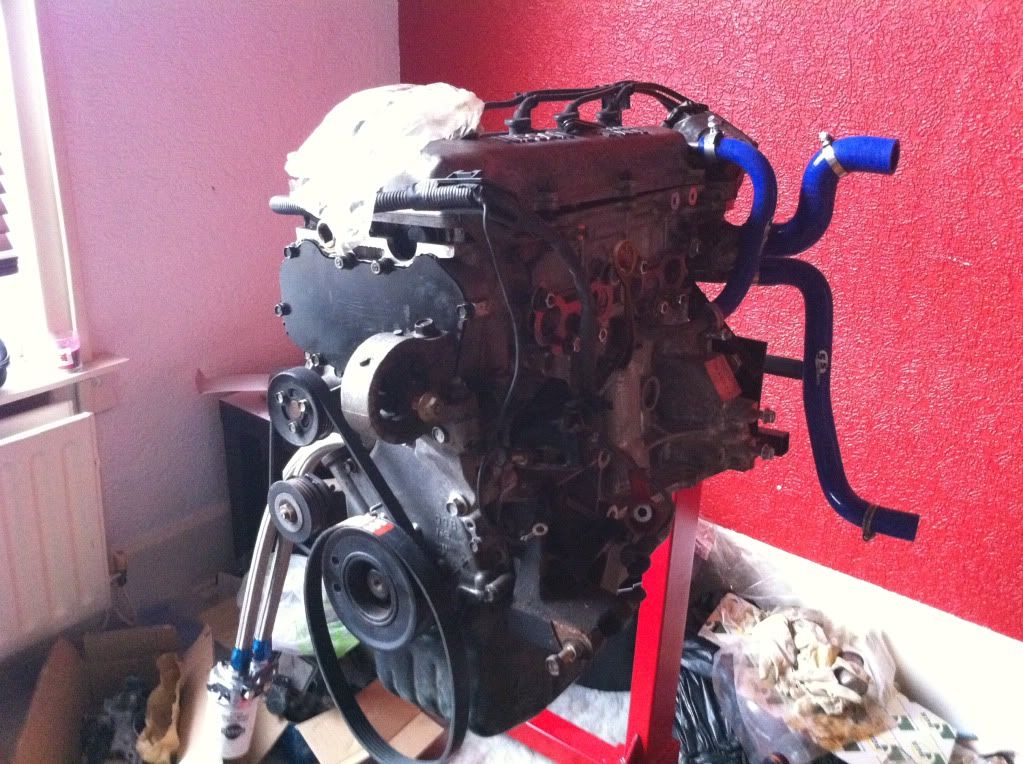

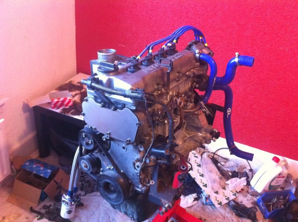

here are some pictures:

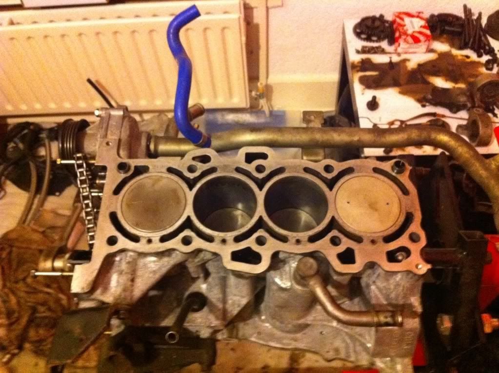

1.0ltr pistons, new rings, bores honed

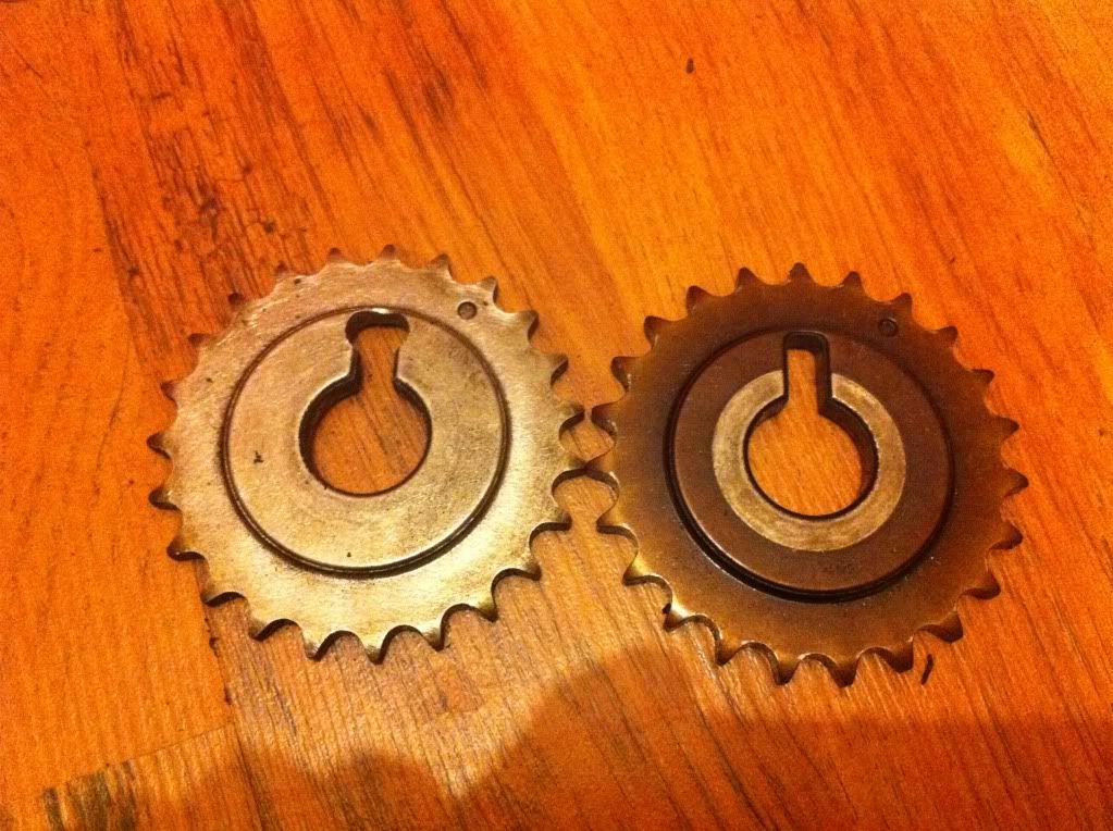

DIY cam pulleys LOL

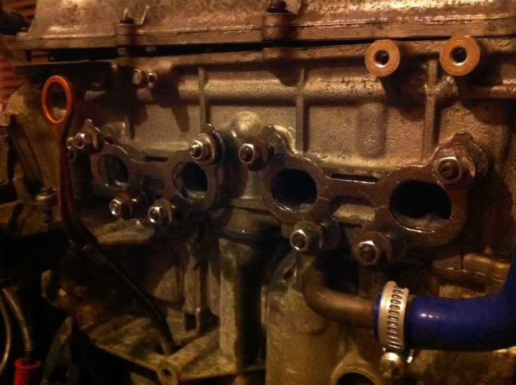

new gaskets/nuts/cleaned ports

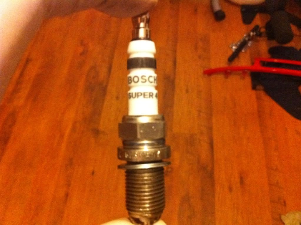

super 4's (might make the gaps larger)

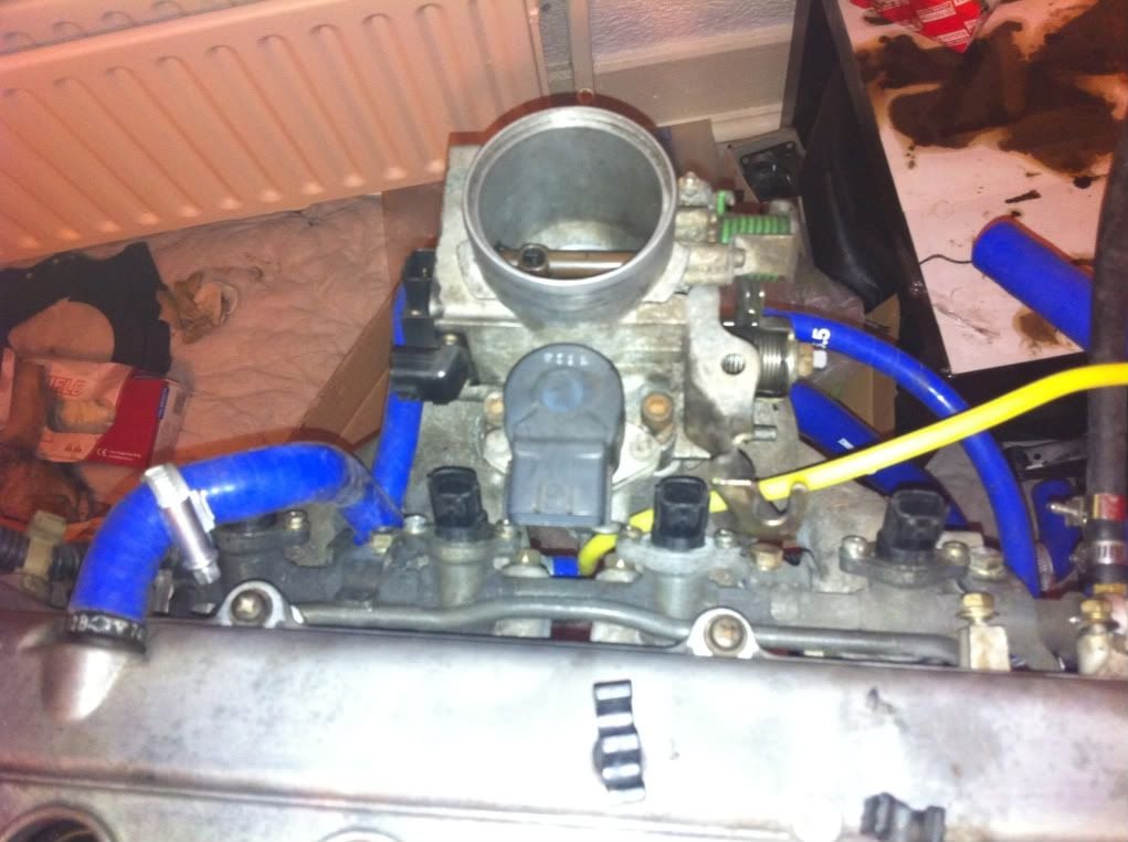

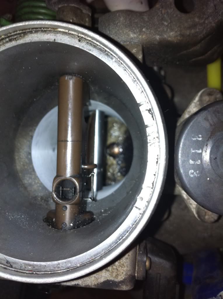

modded TB/1.6 injectors/FPR adapter

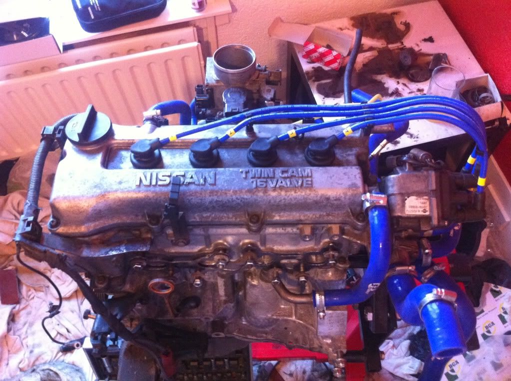

built

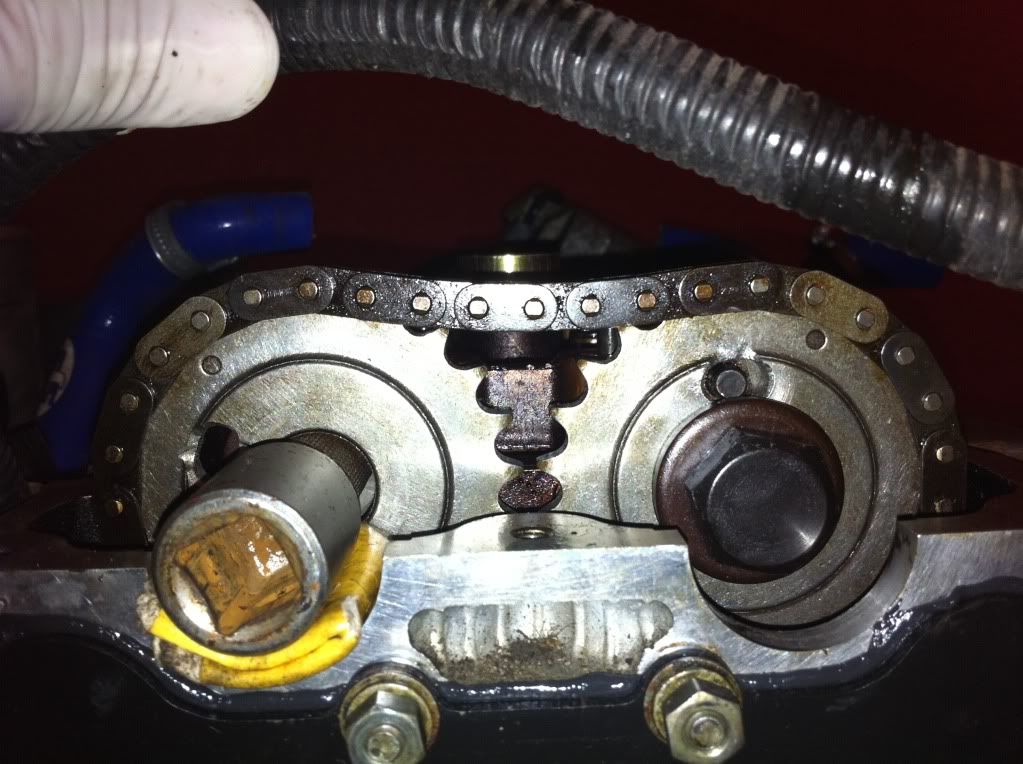

right i got my autosprint inlet cam on thursday night then it was a matter of fitting the under bucket shim and doing all the clearances which is a bigger of a job! all done now and the engine is ready to be fitted possibly next weekend :) some pics
inlet cam fitted
3.4kg flywheel and helix clutch
done

Is the inlet cam retarded a few degrees? or is it just the pic / my eyes. :)

Solarice- the chain wasnt on at that point, ive set the pulleys to standard at the mo and once its running/driving ill afjust them as with the FPR and distributor

right well the engine is fitted full system on too and the cars been started. if you missed my other thread i had a shim pop out but frank to the rescue rustled me up some shimless buckets and theyre on there way, things to do are:
finish off inlet cam buckets/shim mess
sort out the vacuum pipes behind TB/inlet manifold
finish off airbox fitment
rebuild front end
tax and insure it

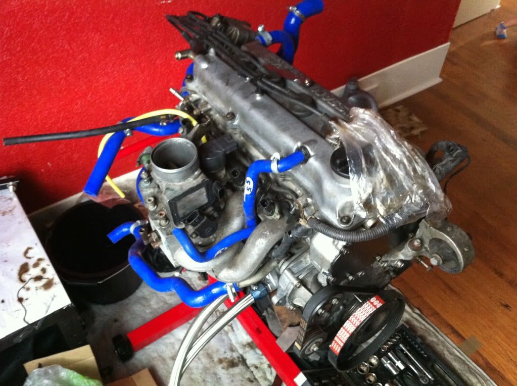

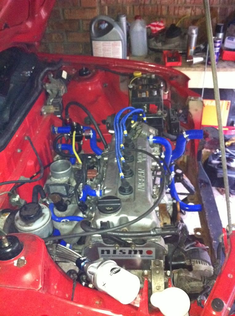

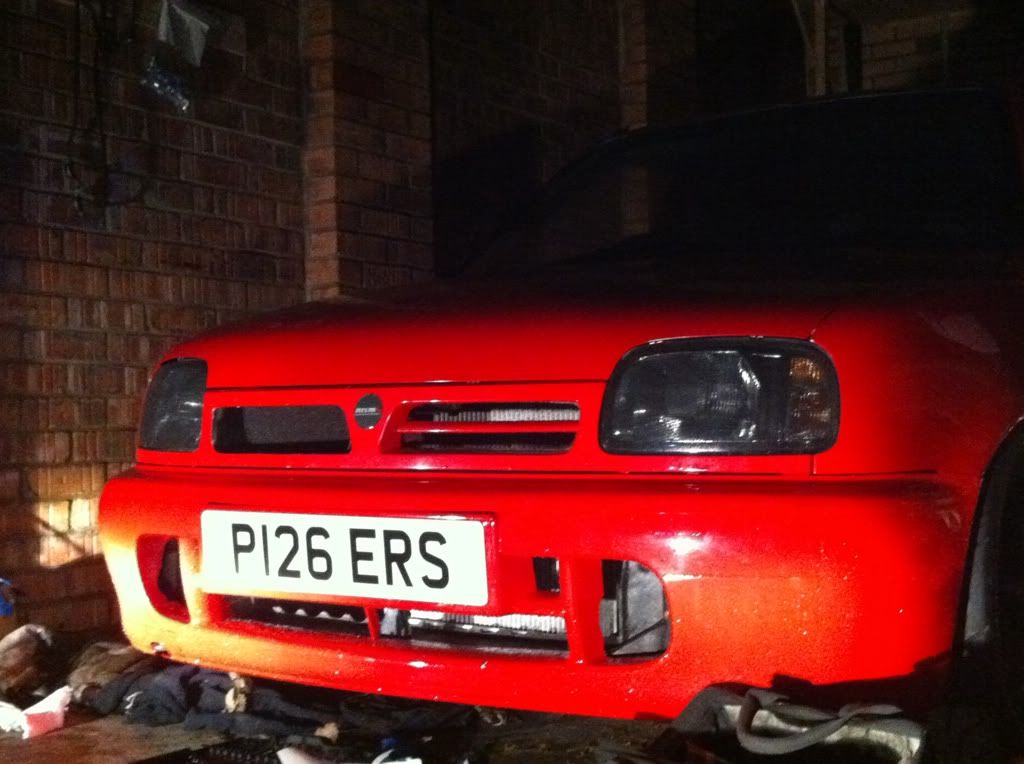

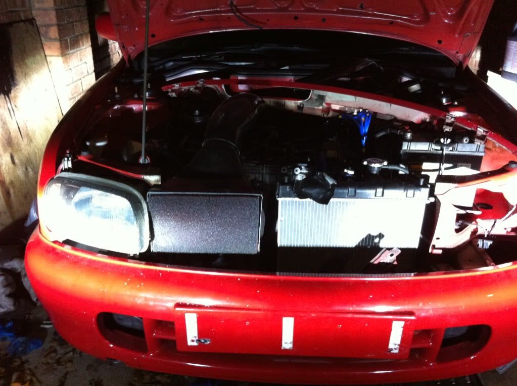

Some Pictures
Looks good stani shame about the shim, but hey ho at least it got sorted quickly

will- yes it is my oil filter, its a greddy oil filter relocator. also gives you plenty points for things like oil gauges/coolers etc :) £120 from US i think
It's been relocated. When I had a 1.4 K11, the oil filter was in the most pain in the arse position ever. Possibly why it's been moved :grinning:.

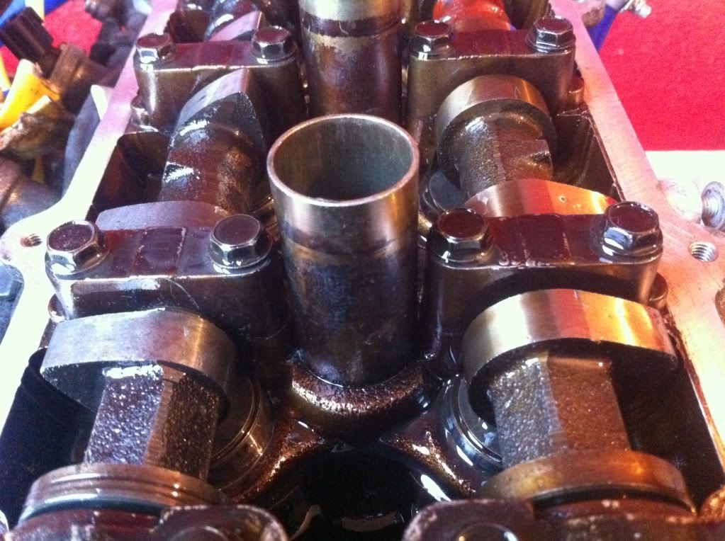

yeh a tablespoon of engine oil down each plughole eh, and can you do a pic at tdc like this :)
ok frank ill do it, first ill do the oil down the bores and comp test it, ill resolder the tb as i think thats whats causing it to hesitate so much and die etc. ill put on standard injectors/FPR and check the cam sprockets havent moved. will be a wee while before i do this though :(
