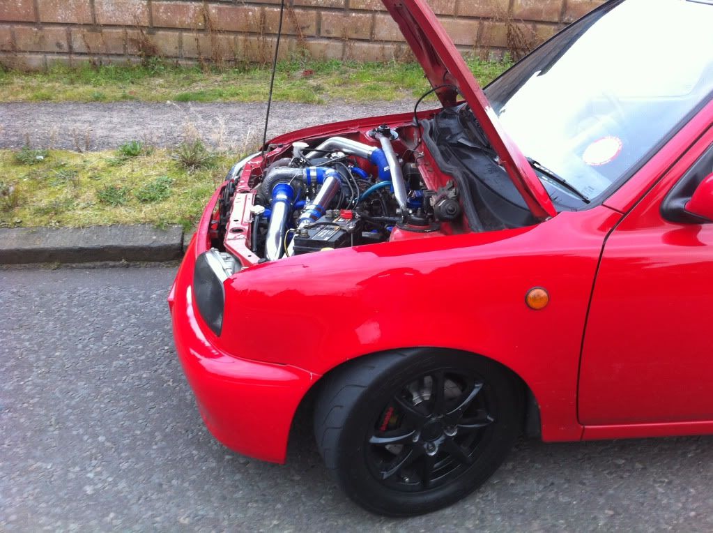

Well done mate! looking the business now! I probably shouldnt say this but have you considered rotating the compressor housing so that you can run the IC piping straight down? might be a shorter and more direct route?
Have you got the OMEX installed yet? what your plans for that?
Looking awesome Stani. If that's Mikey off here who's helping you it saves the cost of an engine hoist, huh :laugh:? Been looking at all your vid's on YouTube - some class cars you trashed (Y).
I reckon he could have gotten at least another few feet of piping in there somewhere :p
not being funny but if you look at it closely thats the only way the piping can be done, even if i did turn the compressor housing around then if would point at the radiator/fan then where would i go from there?? as for the omex it will be going away to get it fitted soon if i sort the running issues.

No harm meant mate, just thought it might be an option (i think thats what that new 1.6T that ed just did is running and was my plan when i finaly get my finger out).

If you look at the 1.6t ed is doing then there turbo isn't top mounted and they've put the radiator on it's side to get the pipes around. I've done it the easiest way I could with everything in there positions. About the fuel I have a spare pump that I'll put in to drain the tank. I really can't be bothered removing the tank after the weekend I've had. Also Frank the car won't idle so I can't leave it ticking over. I'm looking to get this done asap as I was planning on taking the car to a.v.a this weekend which isn't going to happen now. And noddie if the cars working spot on and you change something. the problem has to be what you made that change too??

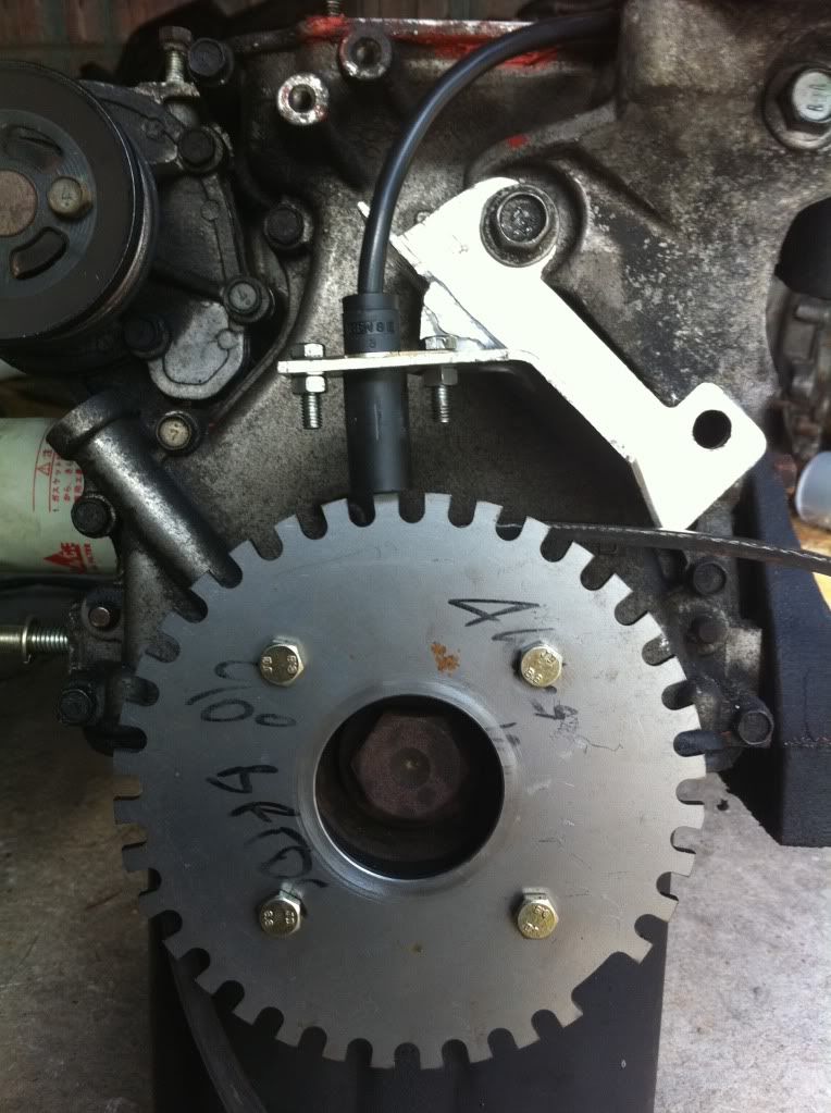

cheers guys, im not actually driving the car now due to the pure noise of the thing. when it goes away to get mapped i think ill get a silencer fitted somewhere as its actually ridiculous! another small update i got my crank wheel fitted to the crank pulley and bracket for the crank sensor made :D i now have everything for mapping woo hoo!!
its gotta be 0.5mm away from it which it is. and if the guys who are fitting it want it further a washer wouldnt go a miss :)
im following the omex instructions so it must be right. heres the only video there will be of my micra until its setup

P.s on the gapping thing, i work with vibration probes doing pretty much the same thing and they are gapped to 1mm, i trust your doing just fine with your build and hope all is well on the mapping phase :D
Trigger Wheel
If installing a trigger wheel of missing tooth type,
• Accurately mark TDC.
• Turn the engine to approximately 90o BTDC.
Mount your crank position sensor (CPS) anywhere around the perimeter of the timing wheel pointing towards the centre of the wheel with a sensor to wheel gap of approximately 0.5mm.
• Mount the trigger wheel with the missing tooth pointing at the sensor.
If machining a trigger pattern into the front pulley then it is usually easiest to machine all of the teeth in, mount the front pulley, and then remove the tooth pointing at the sensor at 90o BTDC
