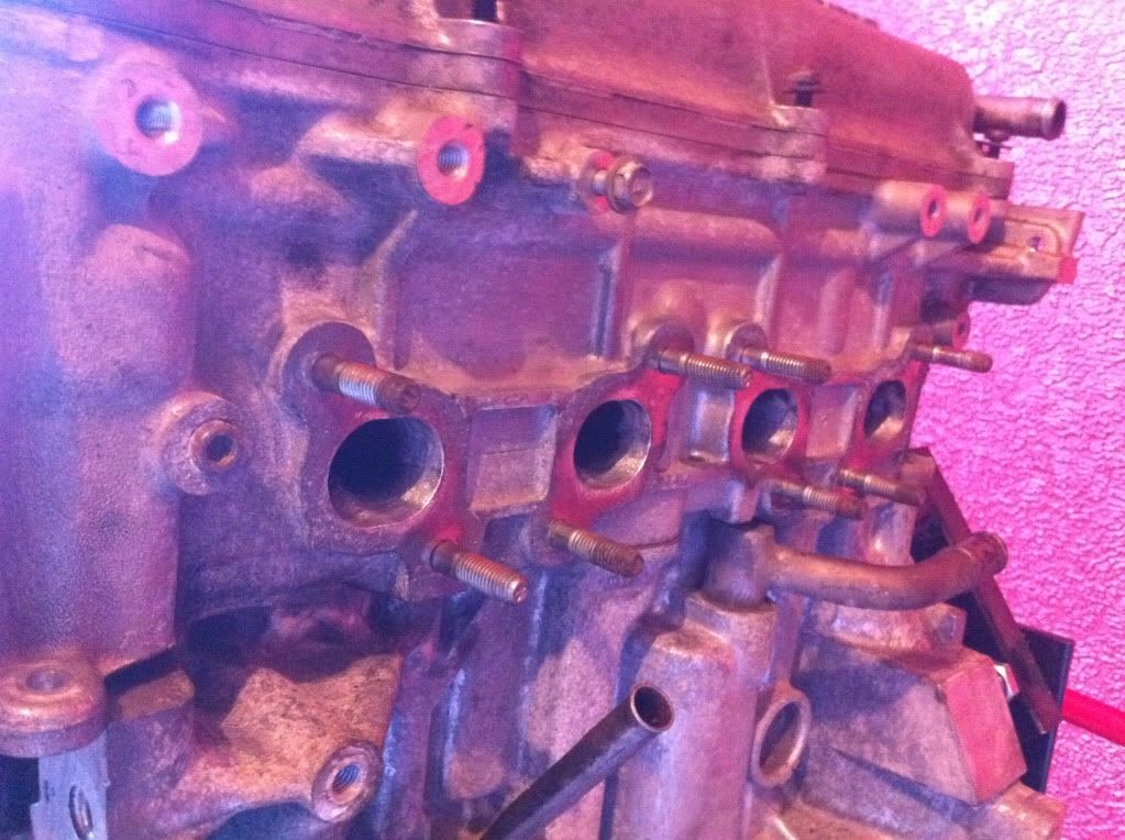

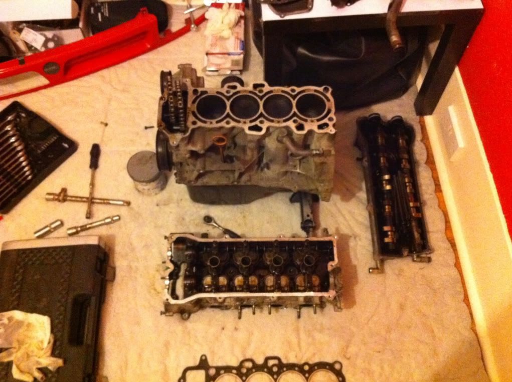

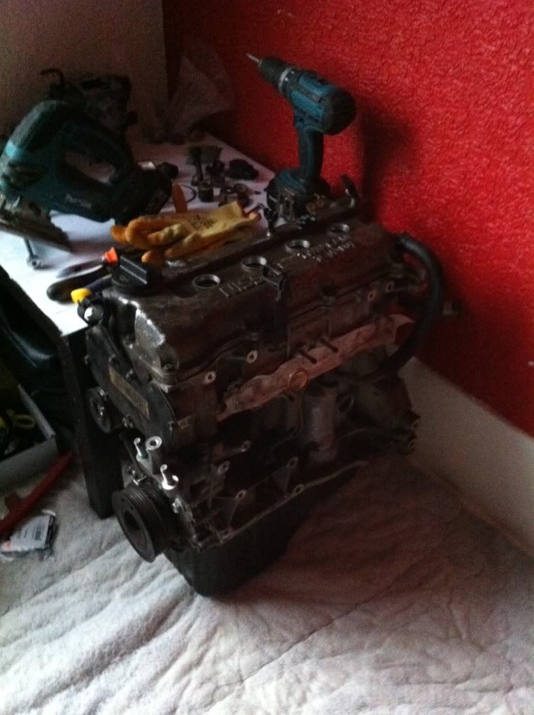

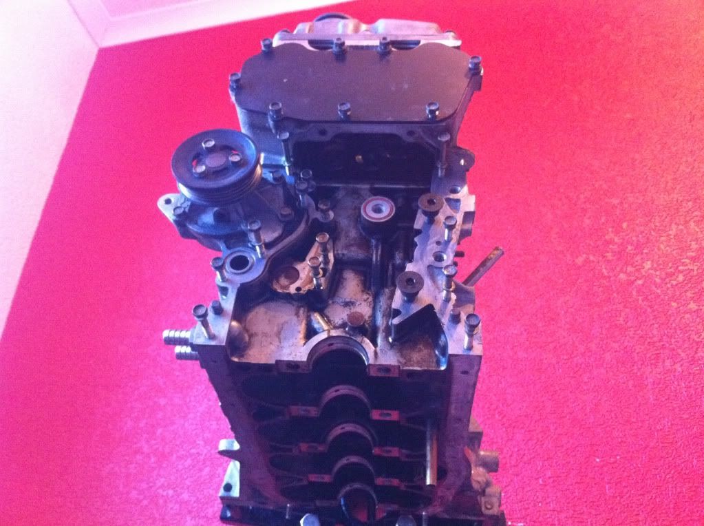

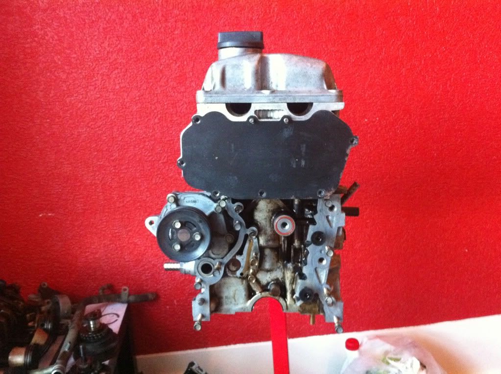

so i got my 1.3 engine from wrighty today thanks mate. straight away i got it into my spare room and took off the head. waiting on my engine stand to be delivered before i take the bottom end apart as ill get oil everywhere without it! here are some pictures :)

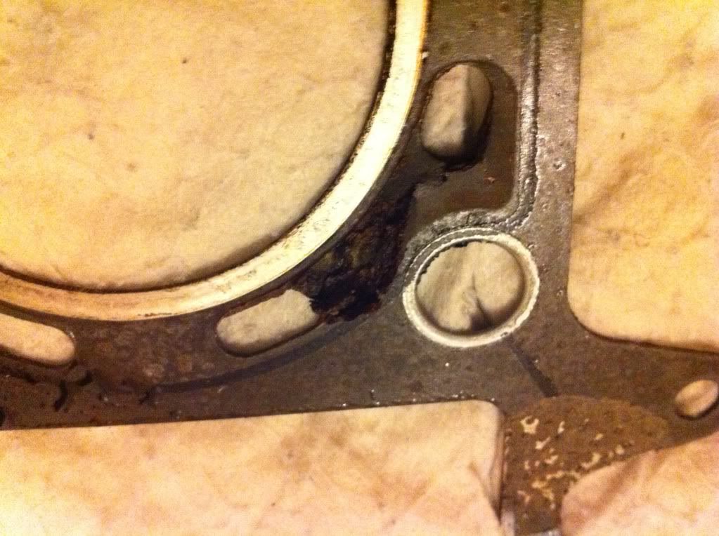

headgaskets got the typical bubbling, was getting replaced no matter what anyway. and as you can see from the pictures ive got a re-inforced block. :)

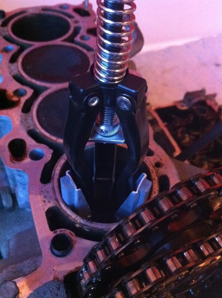

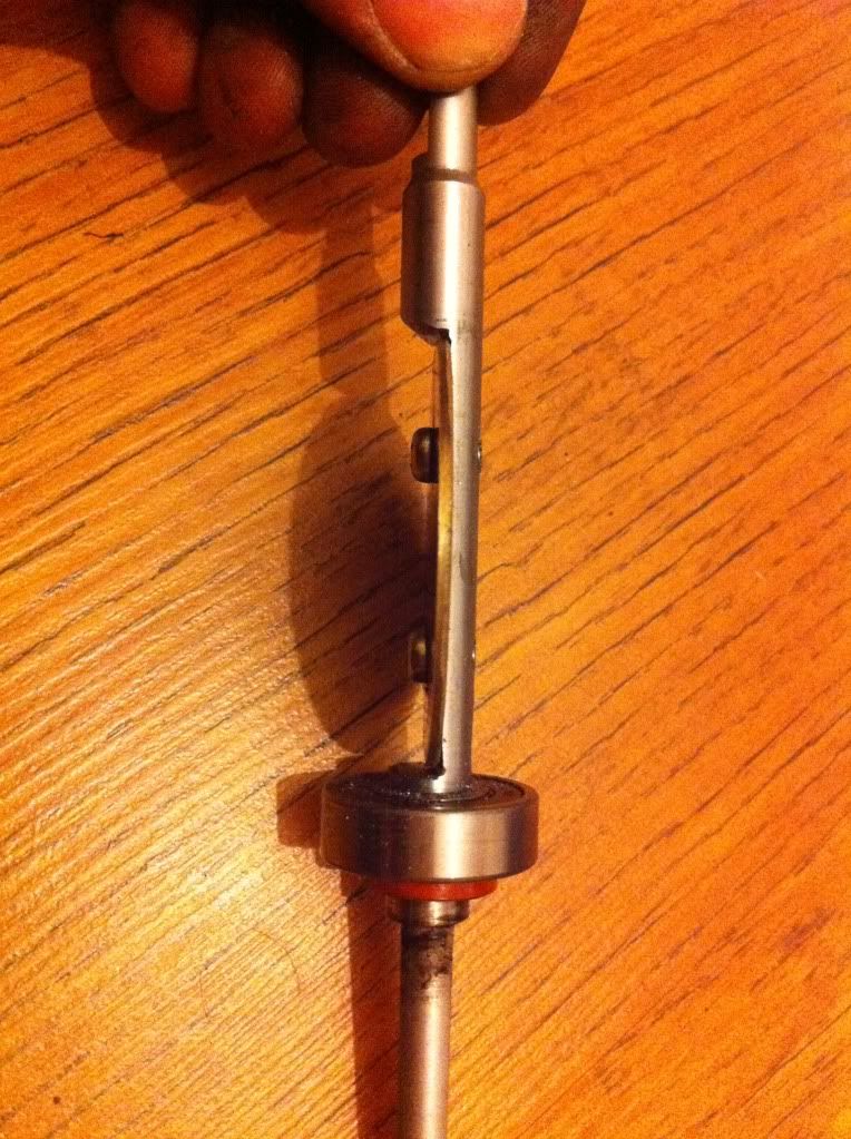

I guess its a tool for honing the cylinders. Save some money doing it yourself rather than getting a machine shop to do it for you
i will hopefully be at crail the opening day, well i will just maybe not in this lol it is a cylinder honing tool. was that or a bit of sand paper. anyone got ideas for swapping pistons, i just cant do it and engine resource who i use all the time are panicking about breaking them and estimated £100 to swap, id rather buy a press for a wee bit more

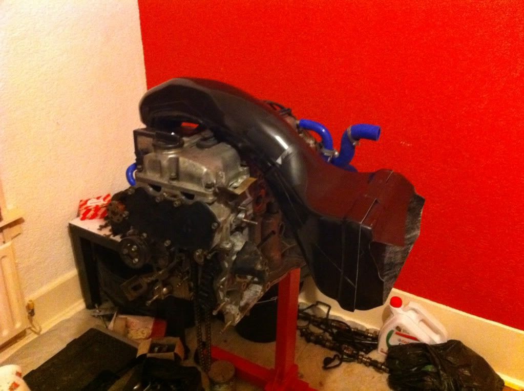

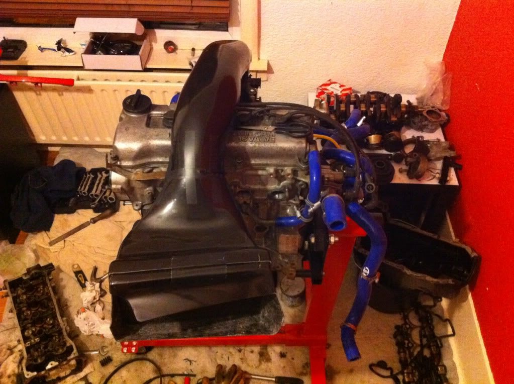

ok some more progress :)

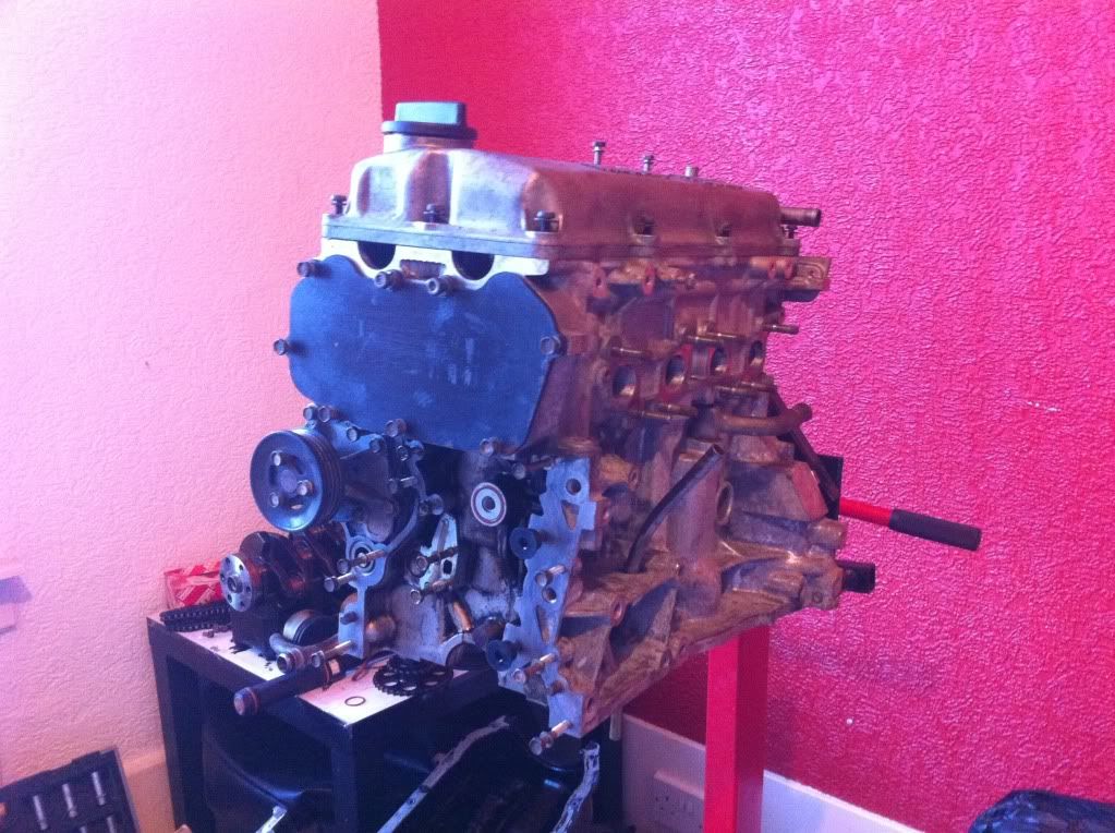

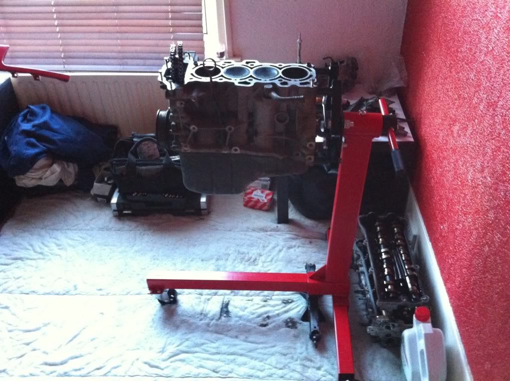

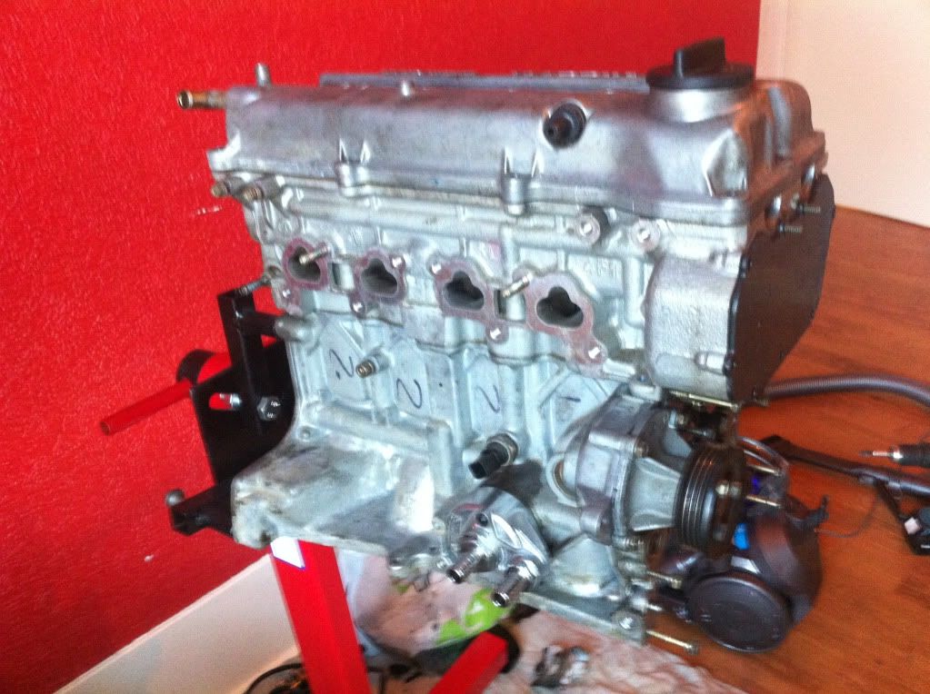

engine stand

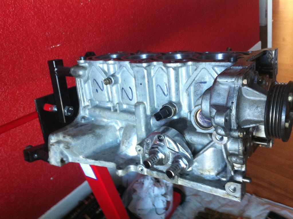

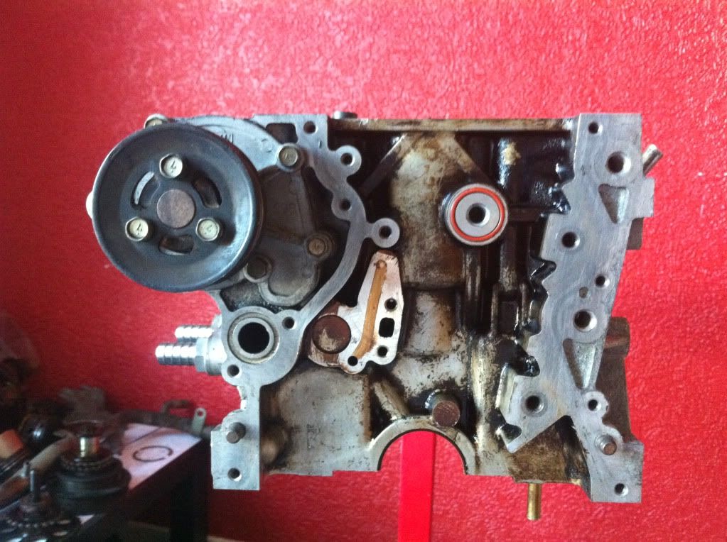

engine stripped, water pump removed and refitted, surfaces cleaned up

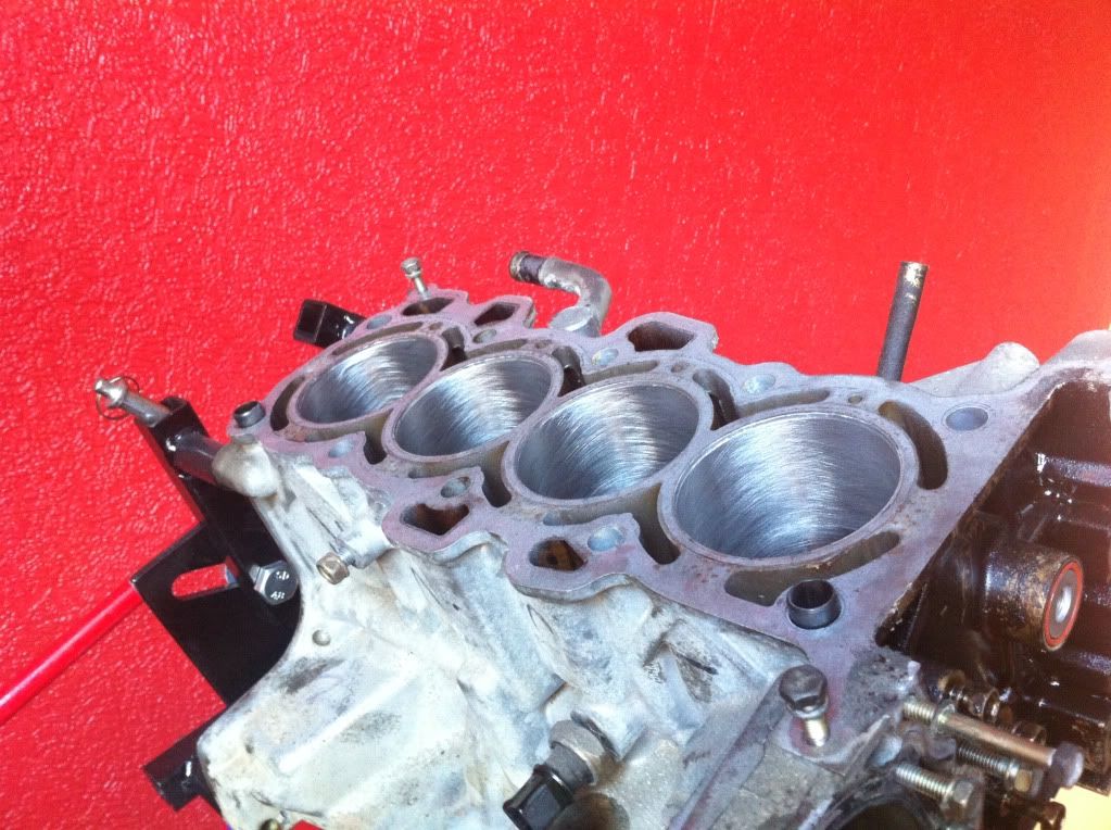

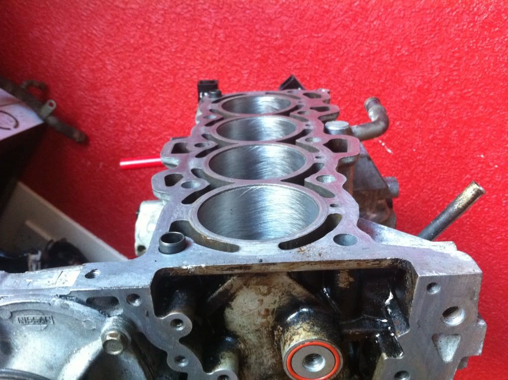

bores honed
oil filter relocator fitting on

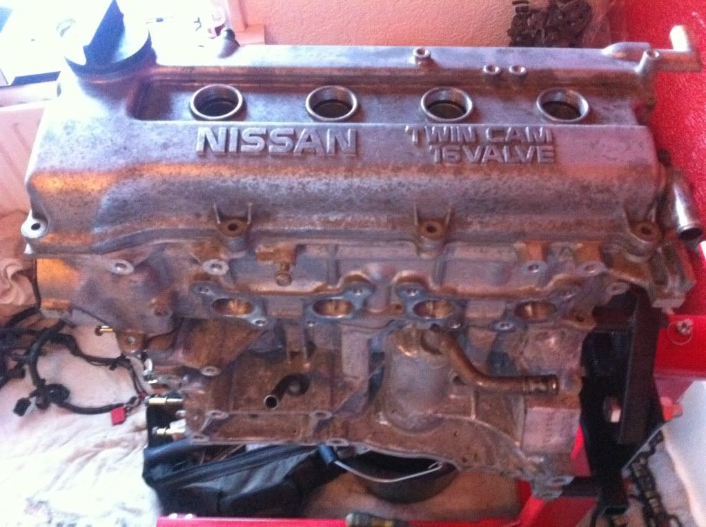

head sat on

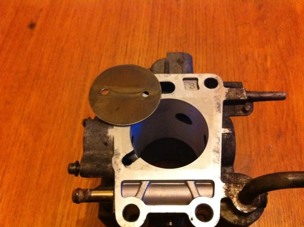

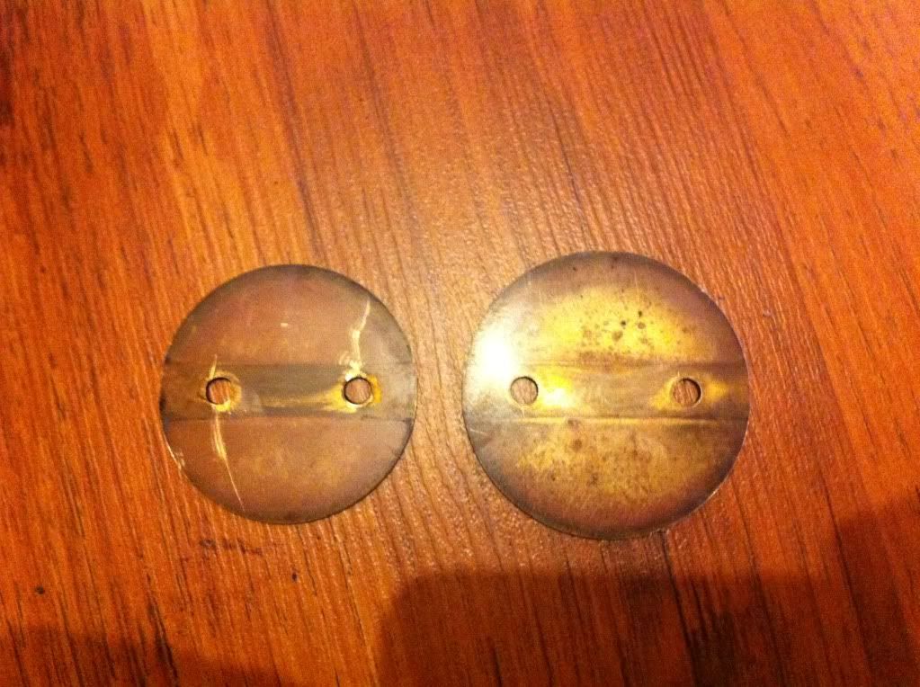

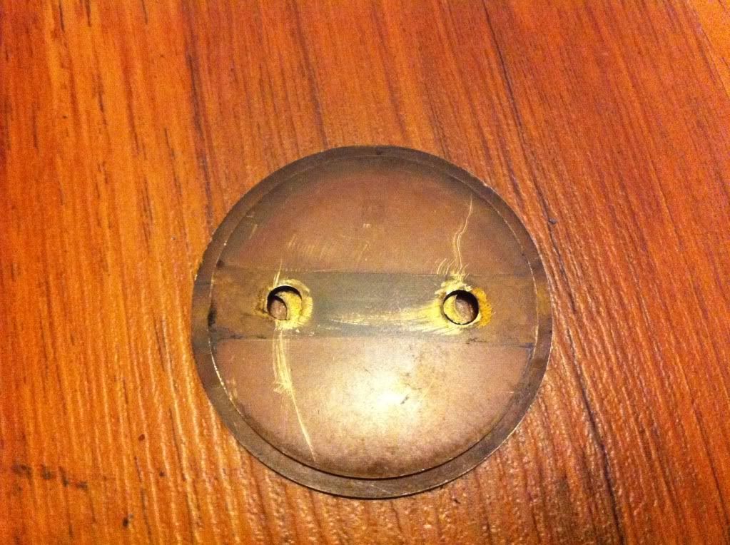

got my throttle body back after a small bit of work. cg and ga butterfly
cg butterfly fitted

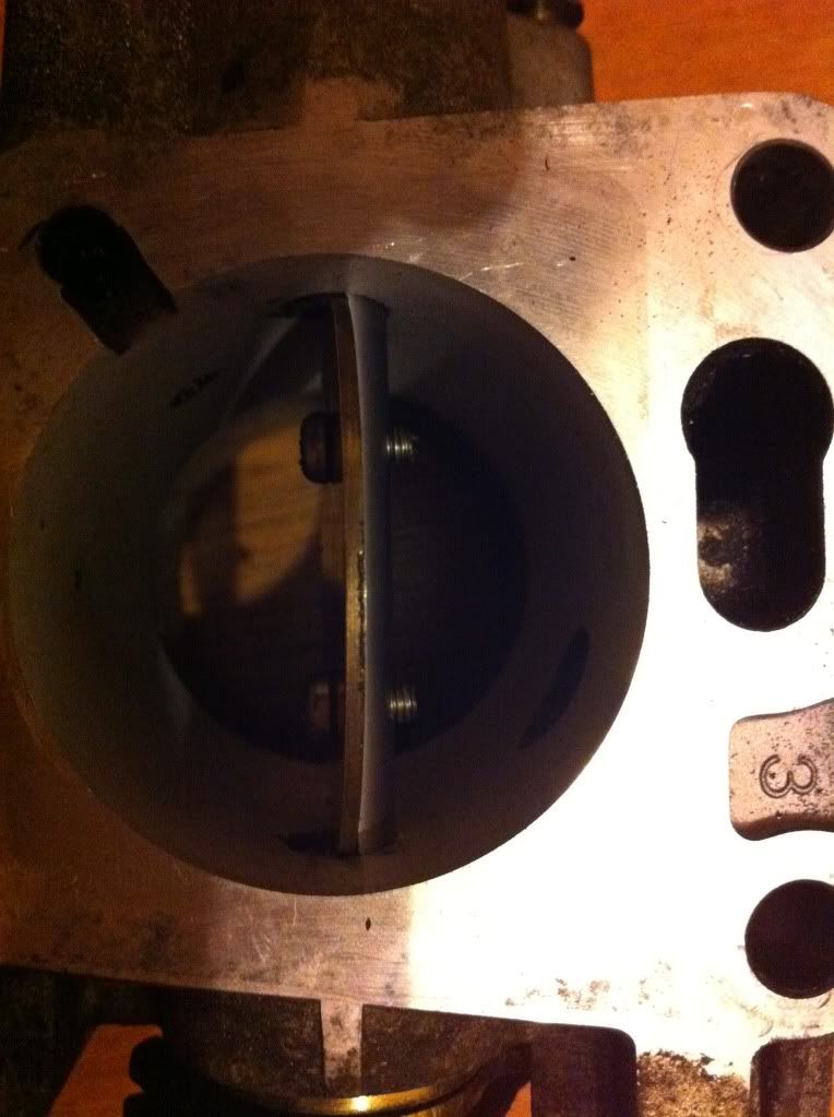

ga butterfly fitted but not closing full
a little file and it closes perfect

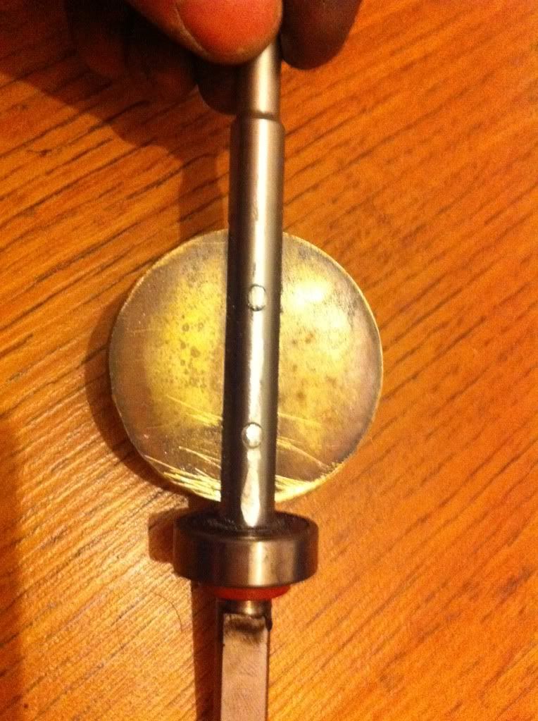

now that i cut half the shaft off the screws stick out a bit
out they come to be filed

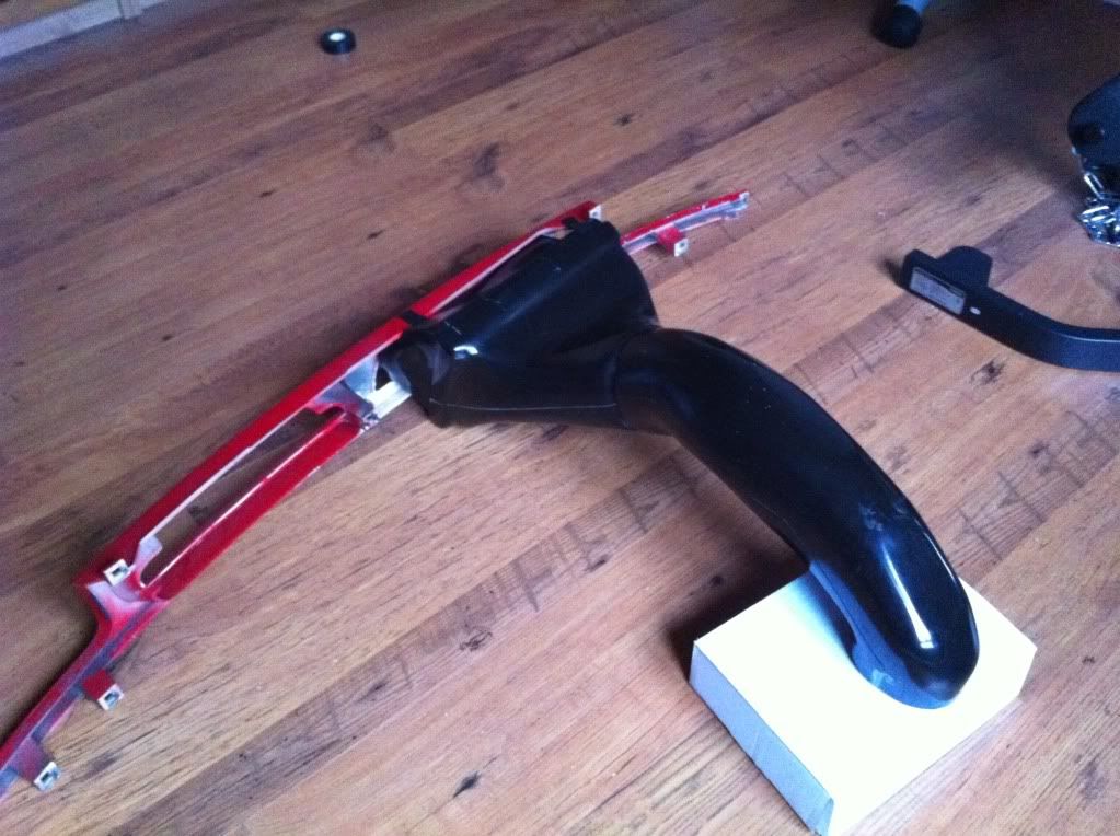

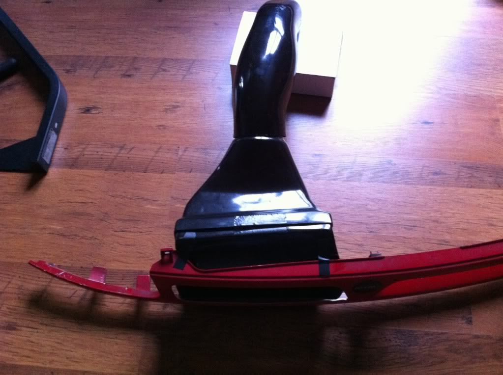

air box sat on
next is to swap pistons and begin the rebuild :grinning:
