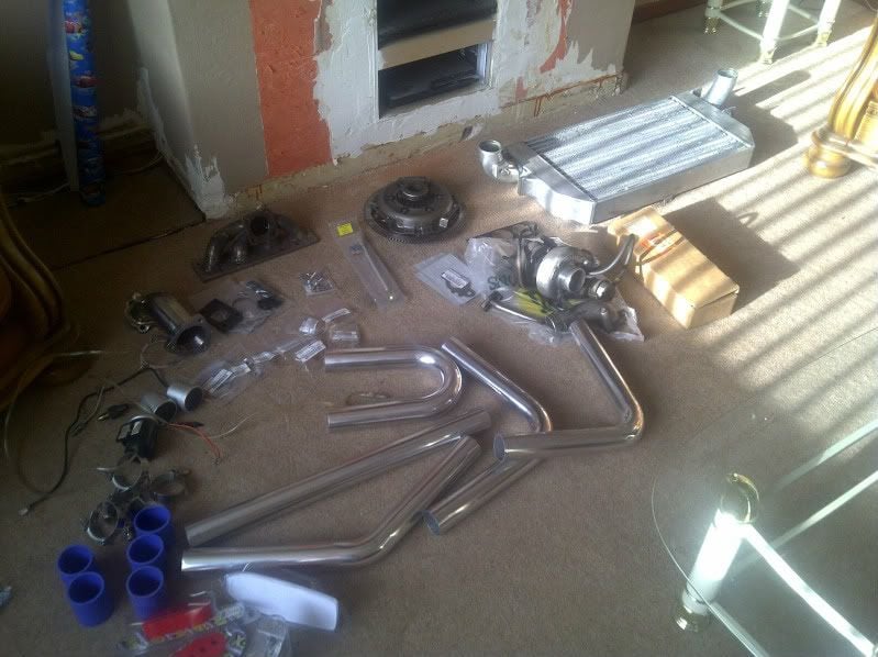

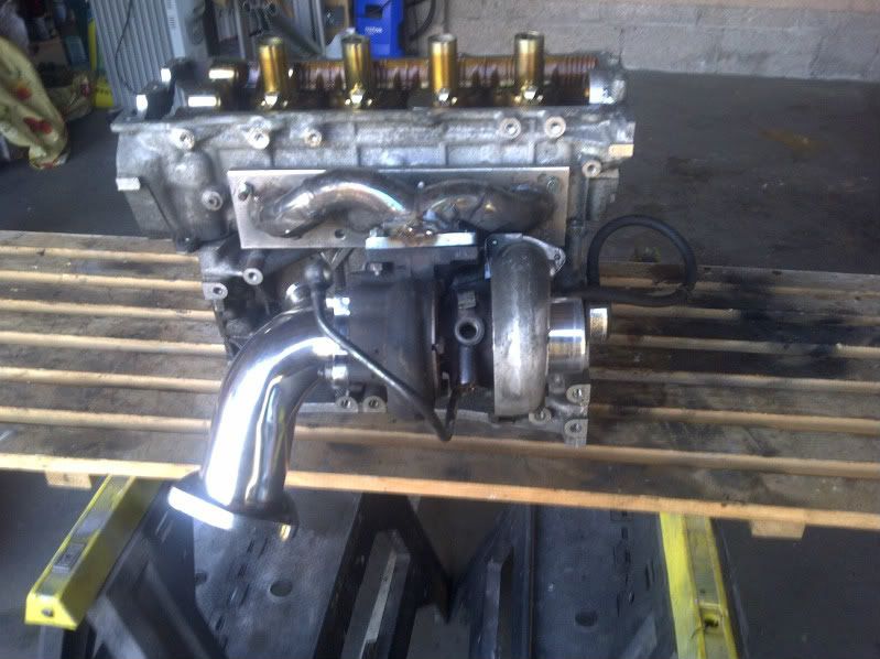

the turbo is upside-down.... the oil feed is going in the bottom.... the core needs rotating 180 degrees........... i do have a turbo kit sat here with a micra turbo manifold, down pipe, 5psi actuator, oil lines and intercooler for sale just 5 mins down the road, and my stuffs all brand spankers new...
