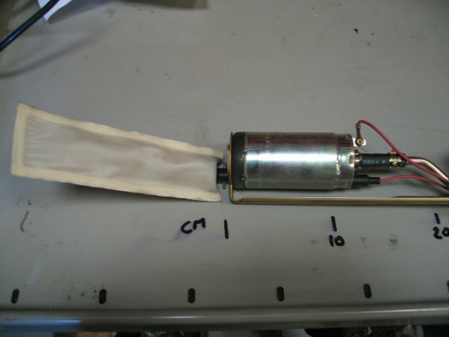

Awesome what's the lph rating Paul? Not long now eh mate![]()
