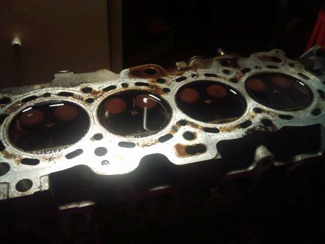

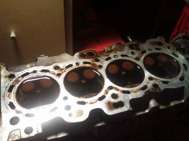

but luckily all the vavles seal well as each held white spirit for about 20mins and didnt drop

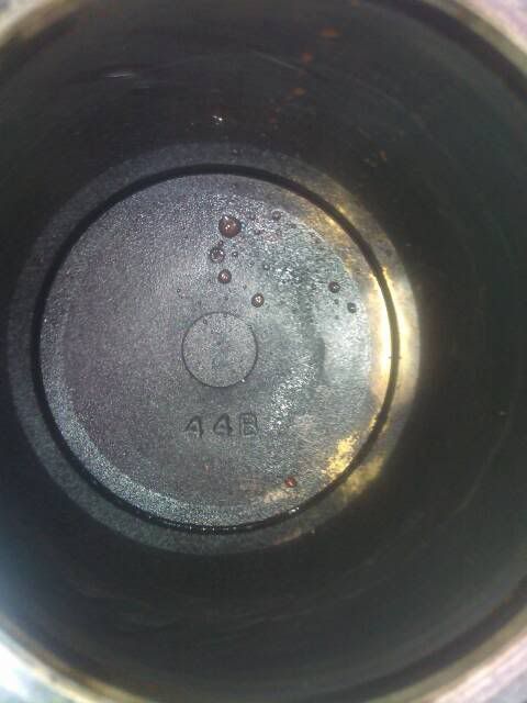

heres a pic of the piston which the valve didnt hit!

pic from when i done my valve leakage test on old head and all is spiffing!
