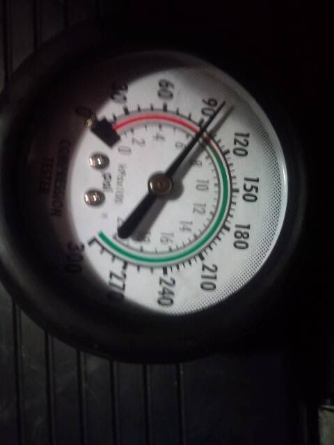

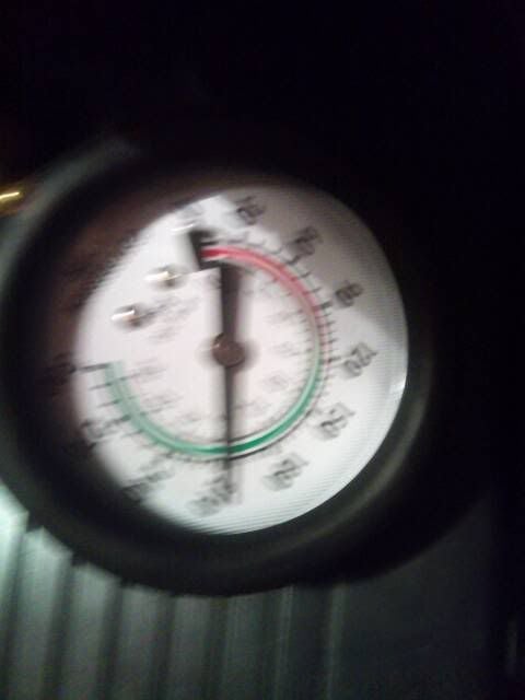

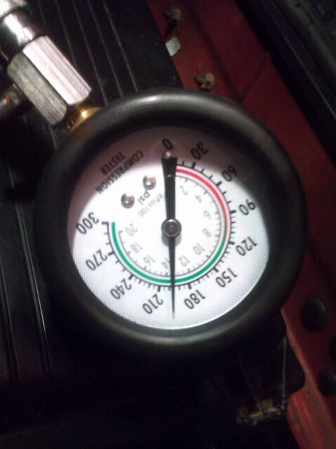

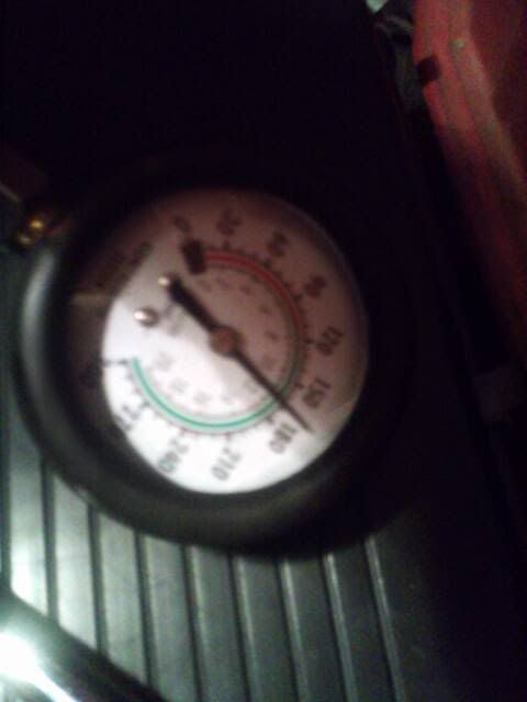

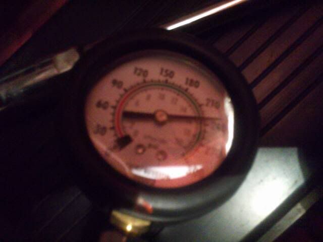

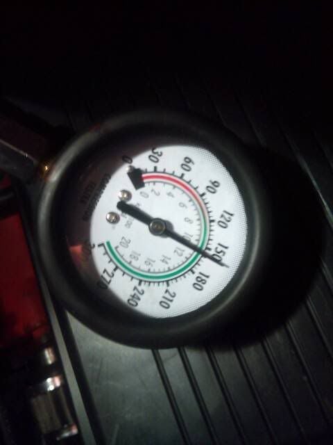

right ran some furthur compression tests on the dot tonight... done them all dry and then a second with about a table spoon of oil down the plug hole just to help seal it up a bit maybe...
ill let images do the talking
CYLINDER 1 DRY
CYLINDER 1 WET
CYLINDER 2 DRY
CYLINDER 2 WET
CYLINDER 3 DRY
CYLINDER 3 WET
CYLINDER 4 DRY
CYLINDER 4 WET
notice the difference this rules out that the piston rings are failing due to the fact that the oil would almost certinally help it seal here and give a better improvement...

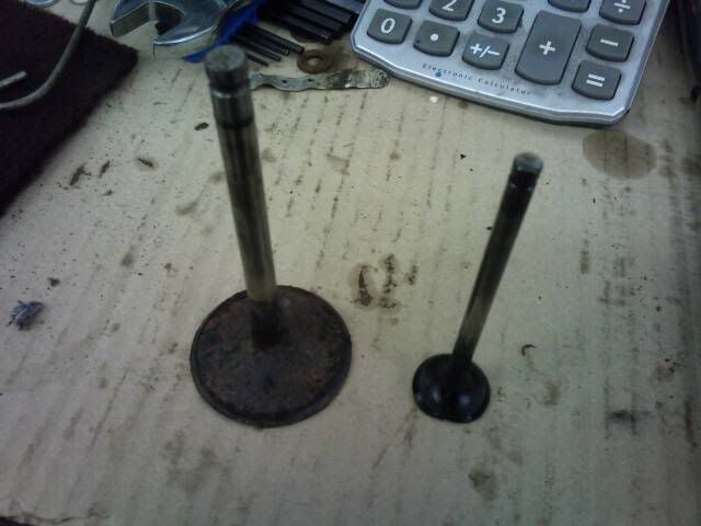

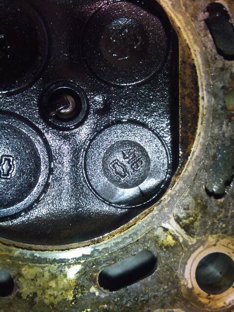

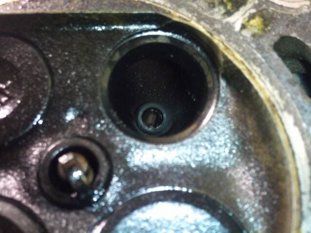

after a long battle and a mess the head is finally off finished about half 10 haha.... taking it into work tomorrow for a propper look etc.... i must admit no.4 is much darker than the rest...
while the head is off im going to fit my other water pump and replace the o ring to stop that leak....
but yes im very annoyed that it seems to me that i bought i duffed engine :(:(:(:(:(:(:(:(grrgrrgrrgrrgrrgrrgrr:down::down::down::down::down::down::down::down::down::glare::glare::glare::glare::glare::glare:
i will deffo need help refitting it as i can do most of it except from the timing and i know if its every so slightly wrong im stuffed so pleas ehelp me i will be able to pay you!

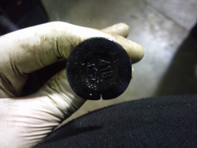

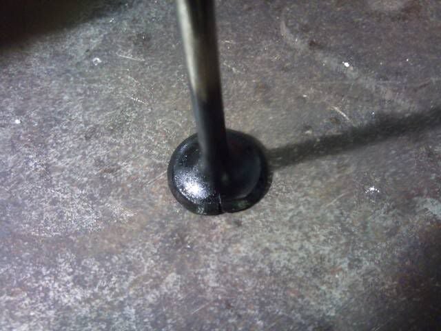

well i can say its deffinately the valve look :suspect:
right well yes its rather nackered my plan is not to go about repairing this head and getting new vsalves as i dont have the money and it would mean reshimming once valve seat grinding done etc....
i am going to run a compression test on the 1ltr at the weekend to see what state thats in.... hope the compression is good if it is ill whip that off and clean it a bit and use that with the cams swapped.....
but yet i am very ####ed off that martin sold me a fuffed engine and will be contacting him but i dont wanna like annoy him cos i know hes a good guy and we get on well etc... but im not gnna sit back etc...
thing is that he said the head looks like its done about 50-60k and that going by the wear on the bad valve it appears to have been like this for a long time just wearing down furthur... and this guy isnt an idiot and knows what hes talking about
and he calls my valves pennies on cocktail sticks as hes used to these hentch exhaust valves from the jags (this one from a 3.8
lool loool:laugh:

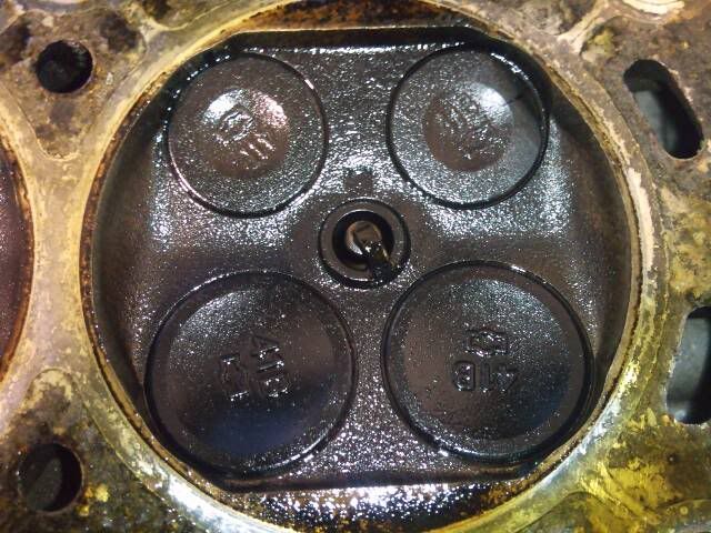

Unlucky mate, what you think has happened to the valve? With regards to your timing is really easy. With the head off i turn the engine over until the dot on the middle sprocket meets any of the coloured links (2 coloured links on the bottom chain them being 18 links apart) and set it to top dead centre. Give the upper chain a clean if you cant make out the coloured links. If you still cant make them out trust me on this one, just scratch the face of one link or colour with permanant marker, this will be your inlet cam mark, then move 6 links clockwise and the one you land on there is your exhaust cam mark then move 8 links clockwise and mark that one, this will be the mark that hooks up to the dot on the 2nd sprocket of the middle pulley. So with the engine at TDC put the 2nd chain on with dot on the pulley to the coloured link and hold it up and tight. Then fit the head and put in the cams pointing the lobes for piston number 1 outwards. You can now put the sprockets into the chain (dot-coloured link) and hook and bolt them to the cams.
Can you put a picture of the pistons up, photo facing down of the block downwards
And a picture of the head next to it the way it came off
I'm just trying to get my head round it
My mates an engineer and can't see how that's happened ???
Oh ######, sorry to see that mate!
That valve looks like its been hitting the piston eh. Have you checked the condition of the valve spring? A soft valve spring at high revs might cause this to happen...How hard have you been revving this engine Will!?
Good excuse to fit some 1.0 pistons though eh:D

Valves don't just wear to a crack in the side, it's whacked the piston, my thoughts are the valves have been bouncing by going past the rev limit

Is the piston ok then!? the valve hadnt dented it?
the piston is fine i checked today i can show photogrsaphic proof if needed... upon furthur investigation both the exhaust springs on 4 were really shabby like theyve been bounding about for a while...
today i ripped off my 998cc head and it look spankin clean as if it hasnt done its 60k odd whereas the one which has low milage looks rank i will get pics up asap! its not looking good and i havent done a single oil change on my 998cc engine the whole time ive owned it....
