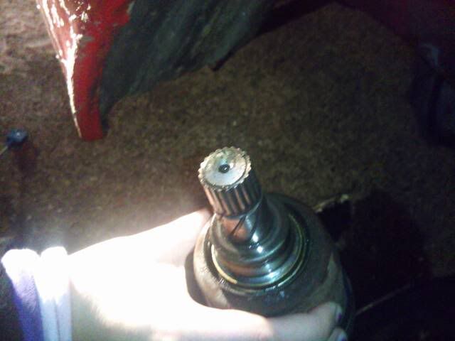

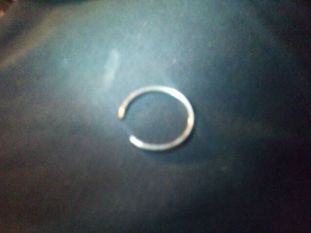

righto just been out to look and that and bought some gear box oil too.... right found some disturbing things i think it may have snapped but i think the bit that snapped off is still in the gear box but visible, righto to start with i found this on the edge.... i dunno what it is and im scared to find out haha

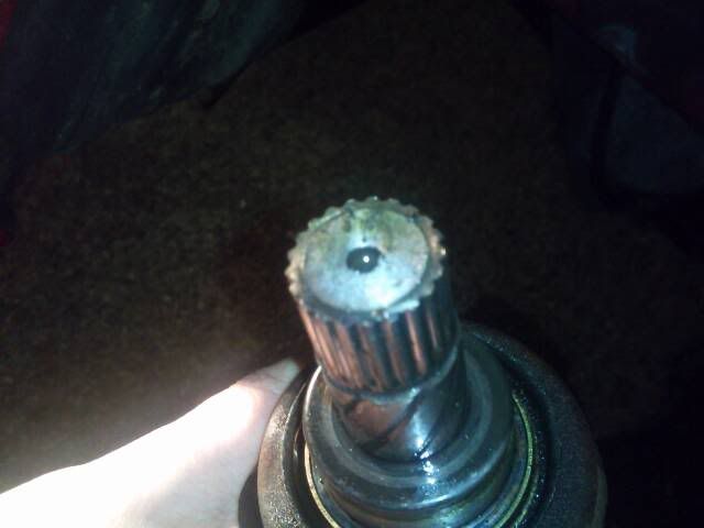

then here is the end of the drive shaft which doesnt look like is sheered off at all which i dont quite understand

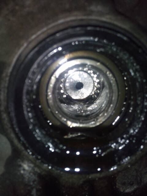

then when i got the shaft out of the way, and saw the spline i looked into the gear box and there was a bit in there which i prodded and it moved so i think that is the snapped off bit but i havent got a clue

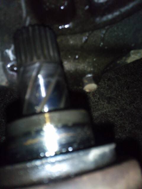

and then just a couple of other i need some real help here with this!!!
righto thats me off please help me guys i need to know if the shaft is fine and just needs wedging in properly!
cheers guys all this help is very much appreciated!
