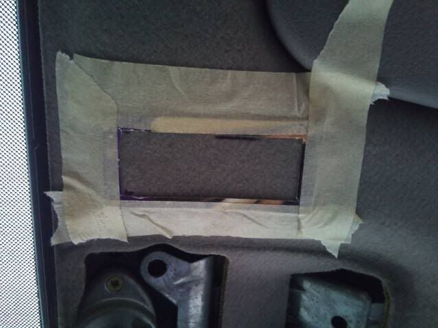

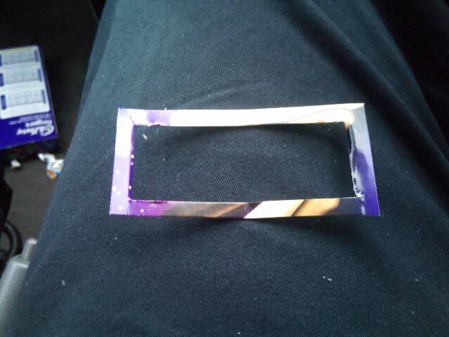

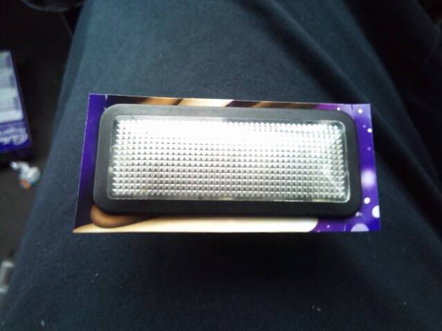

righto the first bit was to make myself a little template to fit the light as the next pics show
took some fiddling about to actually get a snug fit

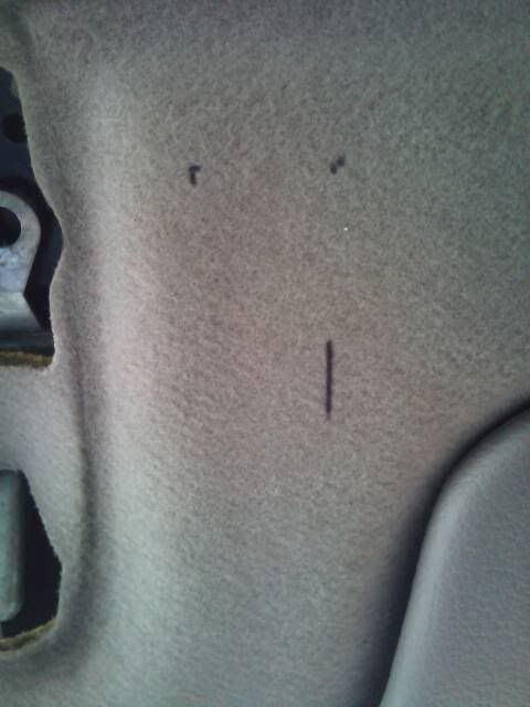

then next thing to do was to measure and line up on the roof liniing in my desired position!
(yes these are my habby marking outs lol but works a treat i thinks)
then simply stick the template to the roof folling amazing markings!
then with a sharp blade cut out as so and then you will end up with a badly cut hole like mine and the both on the same time

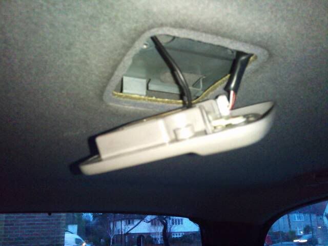

then try out the lights for fitting and maybe have to shimmy about and tweek here and there
and wala

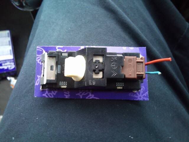

then to the bit which i thought wouldnt be hard then came out an annoying task... which believe it or not is the wiring which was a bum to do... seeing as i wanted them to work exactly with the existing light and id pop into the wires which run up the front pillar! but after some inspection it was the live and then an earth which works with the door open/close which i did want but not only that... so i looked at the main light and worked pout a solution around it.
(cant find pic damn it haha)

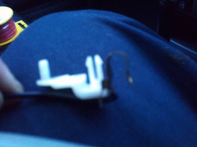

but in the switcher unit that main earth wire goes in one side so when its on that setting it will work with door open/close, then on the other side the earth simply goes into the bodywork and then no connection in the middle secion....
so looking around it how can i connect a wire to all that and allow it to work properly as i want so i took it apart and got the the switch slider thing and solderd a wire onto it so it will work now i do have a pic!
just working out where to solder it so it doesnt get in the way is the fun bit!
and here is the unit back together about to go back in with added wire

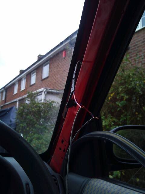

then you can fit it all back together and run the eather wire round to meet the live which i ran from the door pillar as seen below

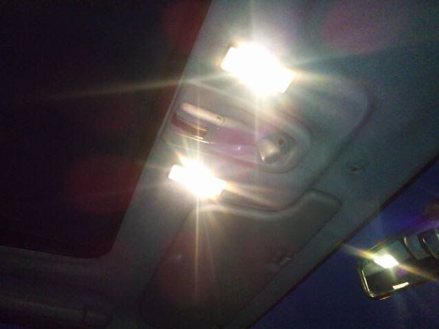

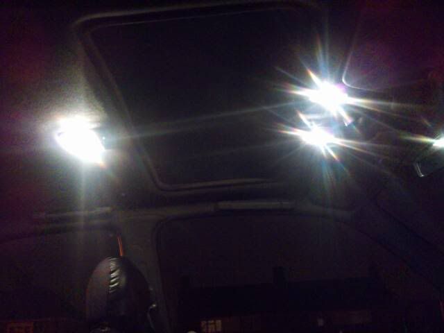

then i ran them to the lights and wired up as normal using ball connectors and made sure all the right weay etc and here are the finished results
all feedback would be loved
