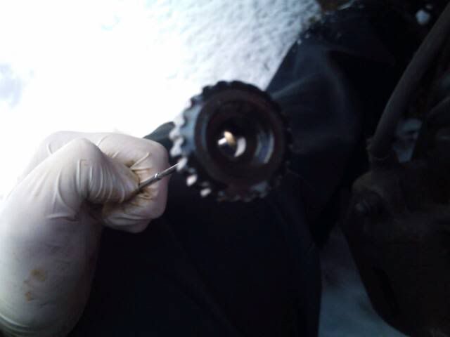

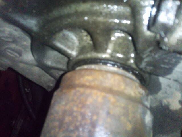

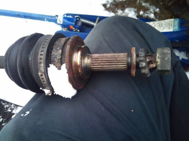

righto heres some pics of my lovely stuffed drive shaft lol
here is the snapped bit rescued from gear box
then just some more lol enjoy!

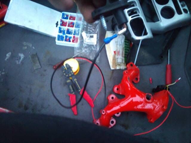

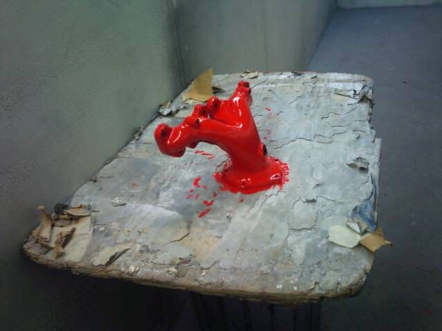

also heres my painted manifold!

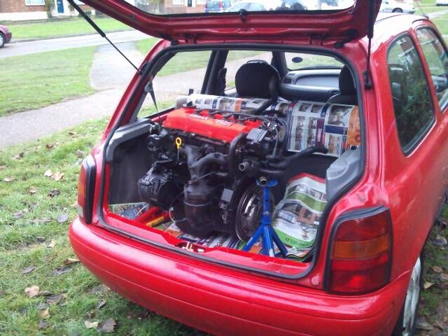

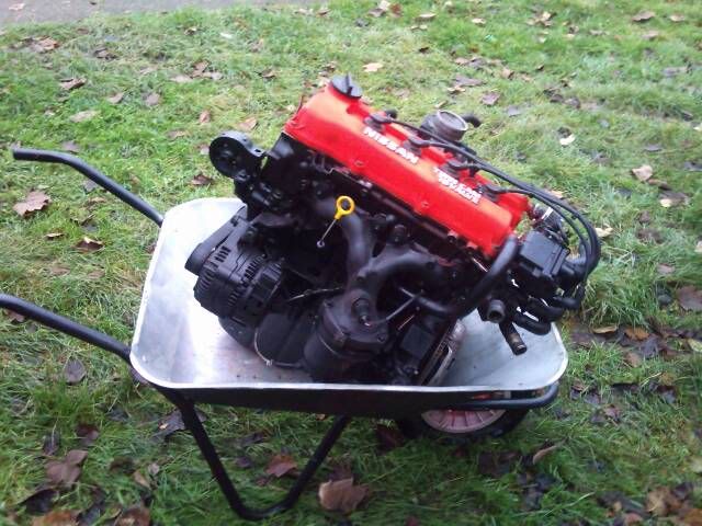

engine in my boot and in a wheel barrow lol

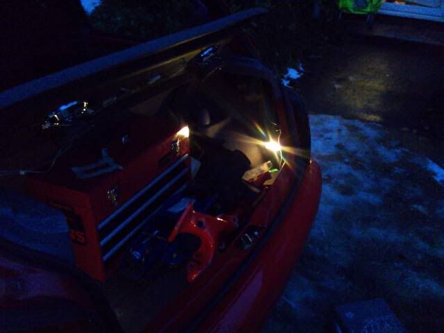

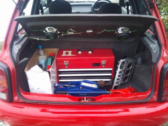

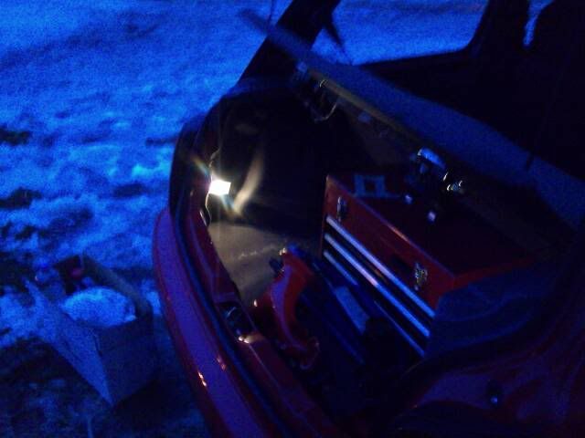

righto i managed to fit my boot lights quite successfully and doesnt take long and works effectively...
here is the car to start with

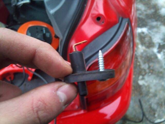

first thing first is to choose a suitable position for the lights to go (following process done on both sides using same template as created before)
once they are fitted may need some wiggling at first... now i need to find a position to fit my push for off switch which has a few possibilities but i needed the accessability behind it.

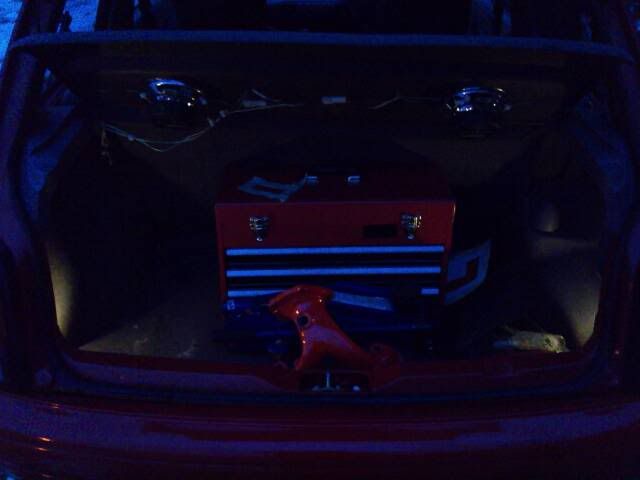

(lights on)
(lights off)
now i position and drill appropriate sizes
and fitted
now that all the parts are in place i had to do the wiring... and as the switch is the earth i just need to run a live... which i got from the main interior lights and ran along the edge of the roof lining and then down the boot seal and in
and heres some pics of my wiring :D
then once all wired up they work a complete treat
all finished feedback very much welcome and thank you!

i found out what my vibration is... the drive shaft from martin had a worn outboard cv and makes a clicking noise on turning lol will swap end with mine from snapped shaft.... any ideas how hard they are to remove?

i see then i simply 'tap' the new end on? :D as i cant be dealing with changing gear box oil etc if it comes out of gear box lol

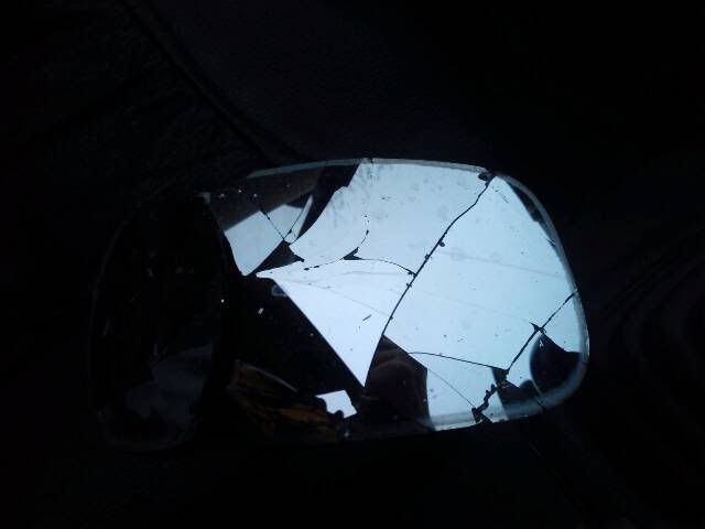

argh went out this mornign to find my wing mirror smashed on the floor!
its funny how that yesterday i had to repair my dad mirror as the whole unit was hanging off, but the best bit the side which was next to the pavement not even the road side.... and the 106 mirrors are like spring loaded and its clearly visible that someone hit it from the top....
and that a couple of months back my mums mirrors were both done in!
%&$£!& ?:mad:#&%£ pikies that live down my road.... cctv going in asap!

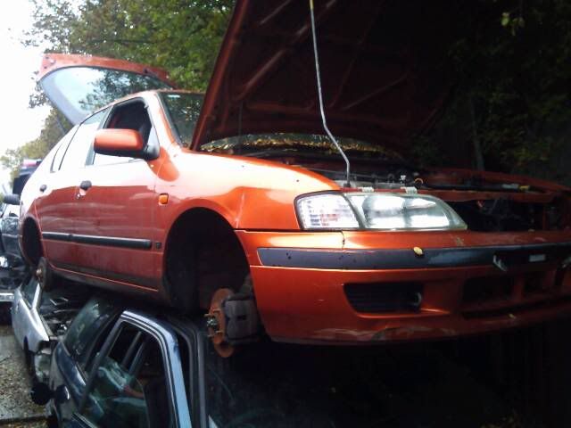

righto i was down the scrapper to day trying to replace this!

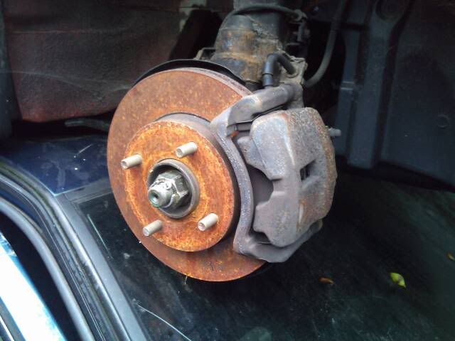

but i stumbled across this and smiled thinking will these old callipers and breaks fit my motor :d not entirely sure so im asking you but its a primera i think
cheers guys the only other way would be just try fitting them but any pointers would be appreciated
