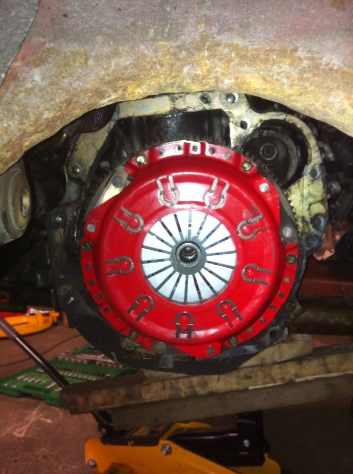

Changed clutch today and its worse than before! Uprated clutch??? More like down rated clutch. Slips worse than original one. Not happy.

So my fast road clutch which slips worse than old one I just replaced wont get better after say 100 miles of bedding it in?
What was the flywheel surface like? If it was grooved then the new clutch won't have the same surface contact.
It may take a few miles to take a surface off the friction plate I guess. What I meant was I don't think you have to be careful like you do with a new engine (or possibly breaks if you listen to them).
Was it all nice and clean when you put it back together? No oil or grease?
Flywheel was looking shiny. No grooves
maybe your car is just far to hardcore eh andy? Is the pressure plate stuffed? if uprated it should be a bastard to engage the clutch pedal eh? What clutch system was on it before?
It was easy to use the clutch. Very easy. Used pressure plate that came with it
Could the release bearing be out of place? very likely to cause this issue. or a simple clutch cable adjustment... too close to eth floor and it will not allow the pressure plate to clamp completely. I think i have said that right. No to close to the floor you cannot disengage, to high and you run the possibility to not engage properly. either way you know what I mean... hopefully. I would be curious to eye up the release bearing.

Just put your arm in the engine bay, grab the clutch arm and wiggle, it should move a little before you feel tension (the cable should slacken a little). It sounds to me like its overtightened... Its like having your foot resting on the pedal and will fry the new clutch really quick.

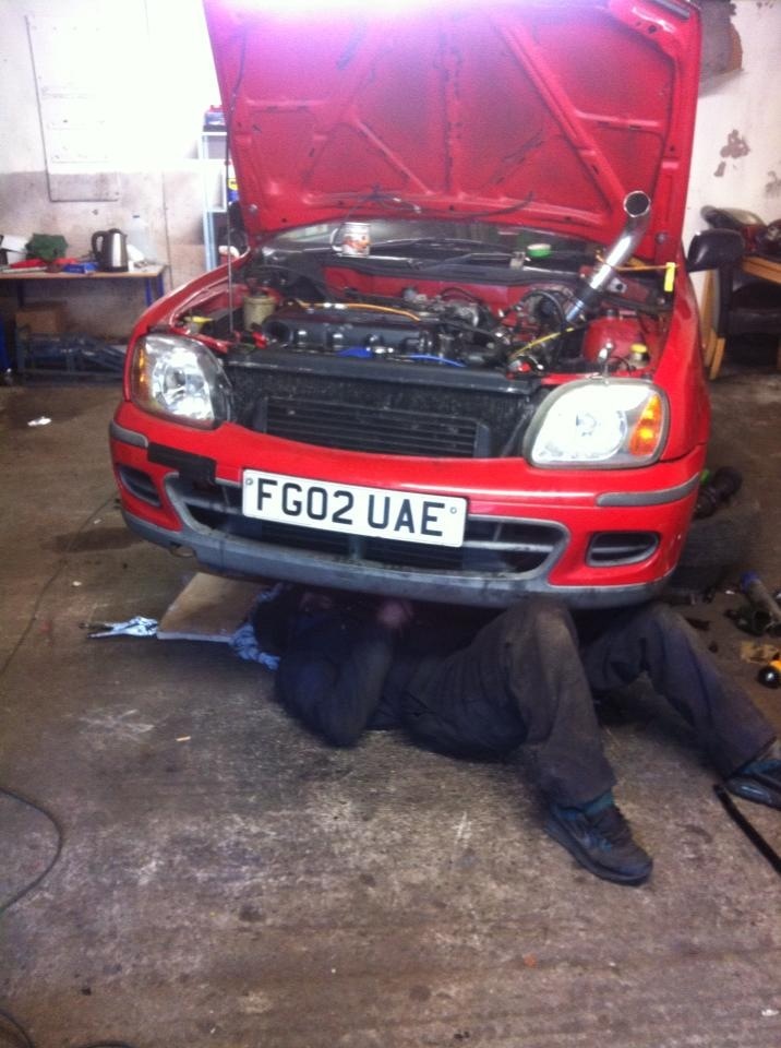

Up an running again.
We made sure it ran fine sat still and then turned off and drained the oil. Took sump off and found the smashed up shims and some other crap!
Looks like pickup filter did its job! As there were bits stuck to the seive.

Just need to refit sump and put fresh oil in again and she's running again
Almera GTi comes off road end of month as it runs out of tax and will be stripped. Be using the paddle clutch from that now instead. Apparently the company said u need to bed it in 300 miles around town and not with full power either!

Clutch holding up today for some wierd reason lol.
Clutches are odd things... Mine should be fine for my power, but slipped after the rebuild (same clutch as before so no bedding in needed apparently) but has now got better by itself.
