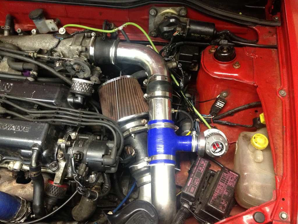

Fitted dump valve today with help over pm from frank. (Thank you sir)
Here is a vid of the final thing. Is it correct it pulls middle in when boosting?
http://i440.photobucket.com/albums/...BA1C3A6-2498-0000019E5933452B_zpsa80c5717.mp4
Doesn't sound much louder than without one for some reason so dunno If its working right.

i think it should be adjusted to be closed @ idle andy, and jerked open when you lift, mine is a bit lazy like yours (mine,s just a diesel recirc valve) :)
How do I adjust it.
Also my idle is a bit lumpy now. Is this cause I've teed into this thing on the right

Took dump valve off. Runs much better without it on. I want it to be a proper dump but clearly my vacuum hose was a in wrong hole or be the dump valve is faulty

It doesn't look adjustable. It's only got a air nipple on the back of it

Mrcheese - it only has a nipple on end for vac pipe so don't think it's adjustable.
