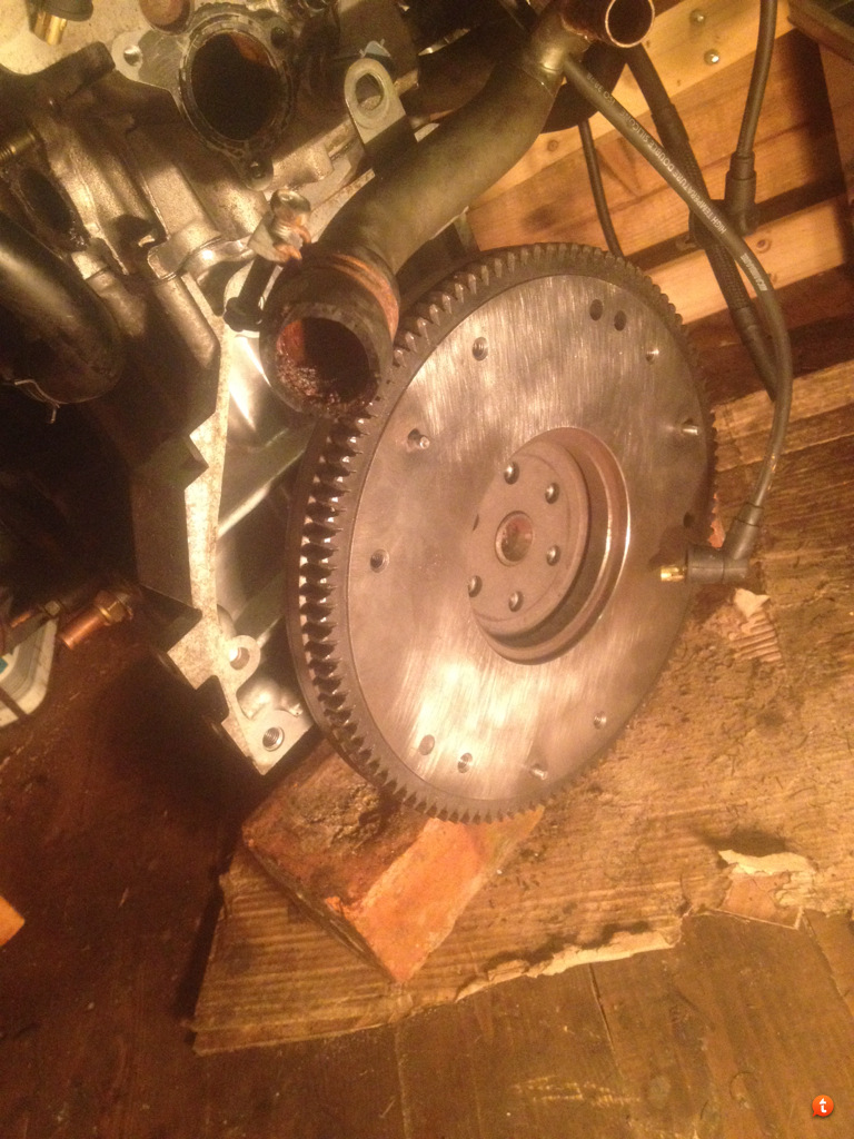

Is it just me or is there meant to be a centre piece to that flywheel?
dsc05414-jpg.27003
yea missing the middle bit. why on earth did nissan do that?
or could shorten the flywheel/crank bolts?
imo I'd prefer the more solid 1-piece 8kg fly which can be lightened
dsc05414-jpg.27003
I have a idea when I take my old engine out I can use the middle off that fly and use it in this ?
dsc05414-jpg.27003
I can use the bolts off my auto engine ? Meanings it's short
is the old one a 3-piece too?
or if its a 1-piece, u mean cutting the mid piece out? seems alot of work
there is the flywheel on my car now which can't see it, or my auto flywheel bolts can use as they shorter ?
