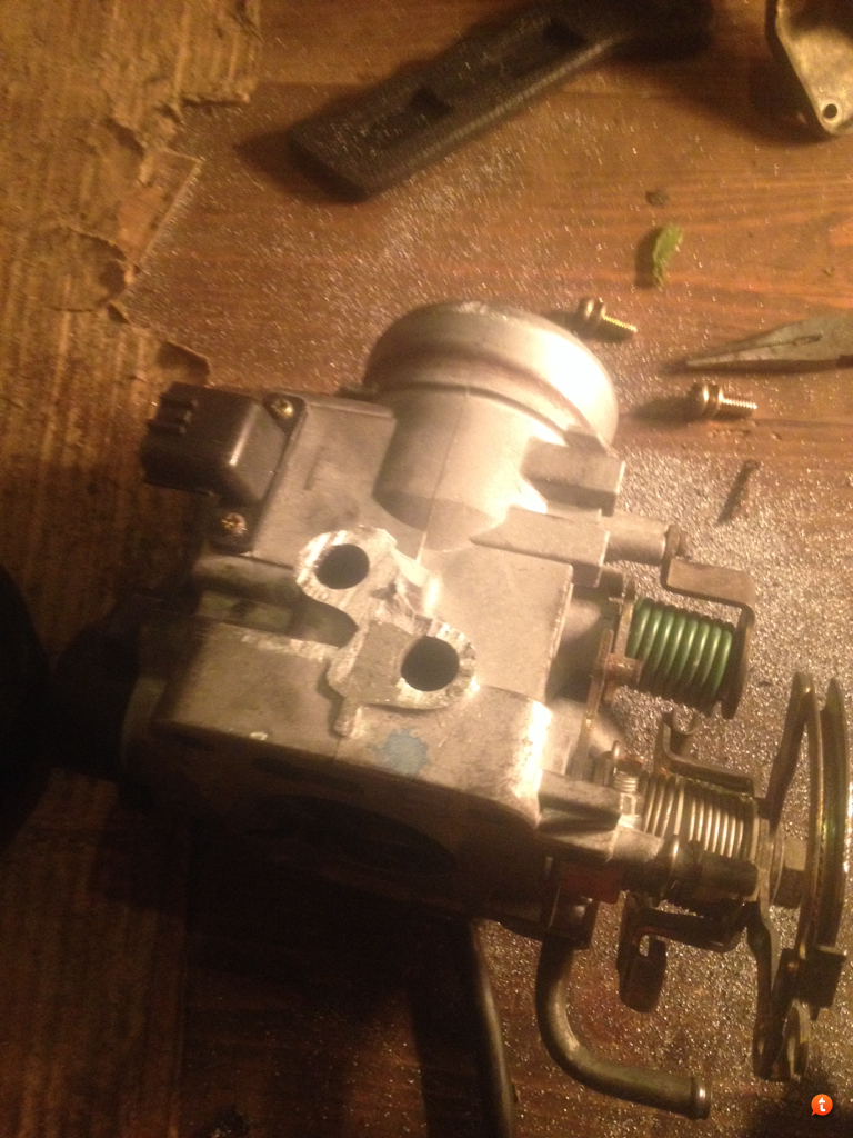

if I move my idle valve controll will it harm the engine ? And can I have it fitted esle where ? my injectors will catch on it ?

My engines all sorted and oil drainage done, injectors sorting out now might need to lose my idle valve coz top feed is on it's way
Thats my idle valve done and my injector is in place without modifieding or welding it, my oil drainage done, meaning I can always go in bigger injectors fits in grinning, only now is flywheel and clutch, injector looms, then engine sorted, frank your a star
