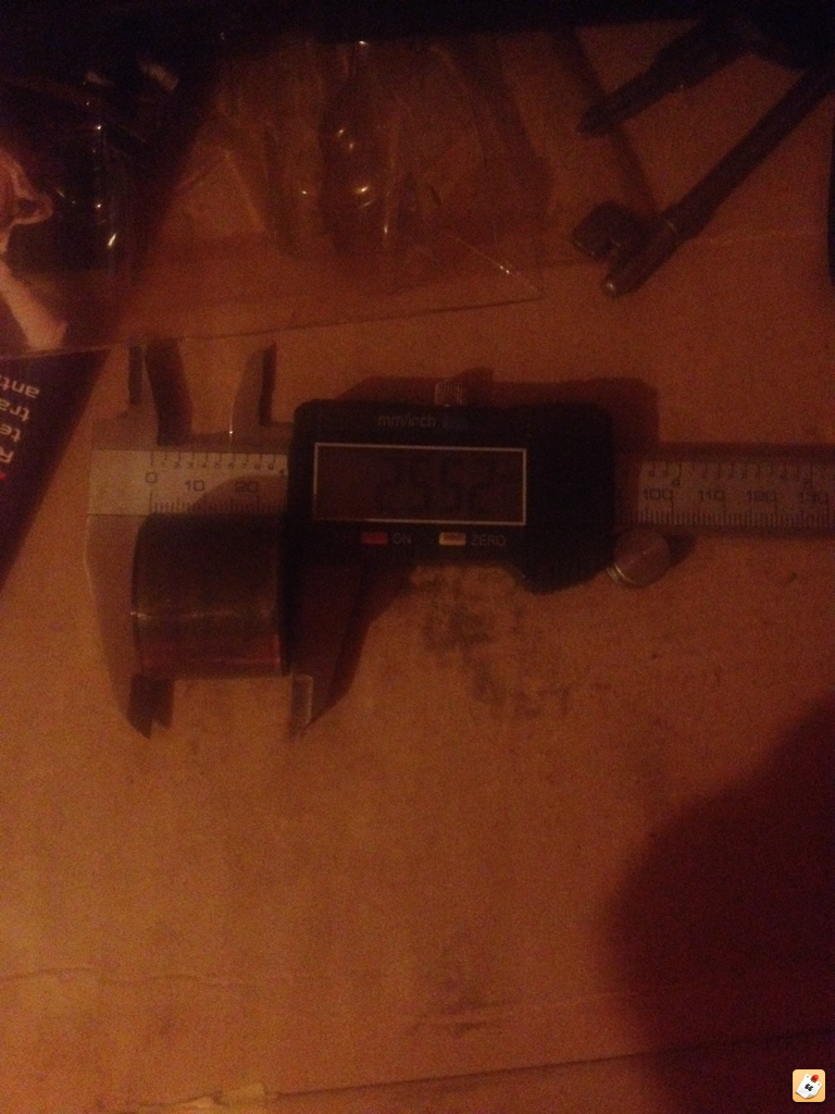

Wat will the shims say on top ? Any codes or letters ?
it's printed on the underside of the shim eg 253 = 2.53mm
but they're usually either faded, worn off or out of spec due to wear.
that's why you should instead measure their exact thickness at several points with a micrometer or digital calipers as accurately as possible and mark it down.
logging which shims are where, what clearances they provide and how much mm to add/subtract to reach back to the ideal specification will tell you which shims to swap about and which ones are missing and need replacing.

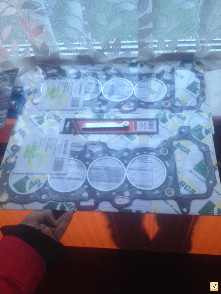

just got my headgasket are they right ones before I open the seal ? I have 2 paid 19 pounds each
from the red line markings they look like the cheapo ebay soft composite type not the genuine victor reinz ones so from my experience they prob won't withstand the high boost reliably and will be a right mess to clean up next time the heads removed
Thanks for the comment I paid 38 pounds for 2 and the head gasket are from bulleyes, I have put 2 should be good, looks good as well

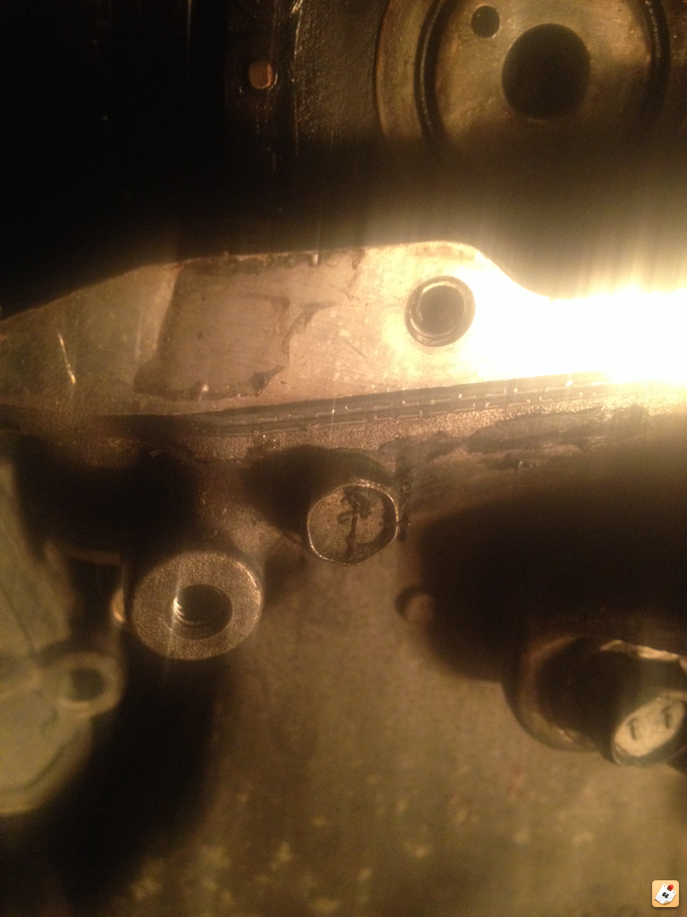

after the head gasket was done I thought I will give the timing chain a try and cam shafts all fitted, broke a the tensioner and screw still in there, thought I will take it off with gripper Tommow, and about the shims everyone is right it comes in Diffrent sizes, if it's wrong like frank said the cam shafts won't it and will rattle on valves, I got the closest I can with timing and the shims, can anyone tell me if it's right ? Also I try to turn the engine over it turned but really tight ? Is that normal ?
why do ppl use 2 HG?
a normal single genuine HG and proper remapping can safely handle 10psi, in which case imo would've just got the victor reinz for the same price.

how on earth did you wreck the tensioner and snap its bolt?
unless you forgot to fully retract the tensioner into its housing before fitting and just forced the chain over it when it got stuck?
and forgot to clean the bolt threads and overtightened it when it got stuck?
mechanics 101, all threads should screw in freely by hand with ease when under no load until the bolt head/nut face contacts the surface.
if the nut/bolt fixing is getting tighter/resistive before the component is fully secure, back off, reclean and reoil the threads and try again till it secures smoothly.
if the torque feeling reaches a peak and then begins to lower, then the metal bolt or thread is overstressed and failing/stripping.
