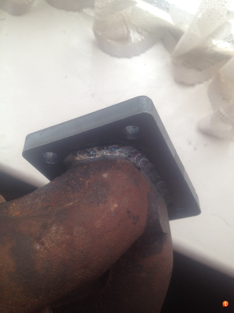

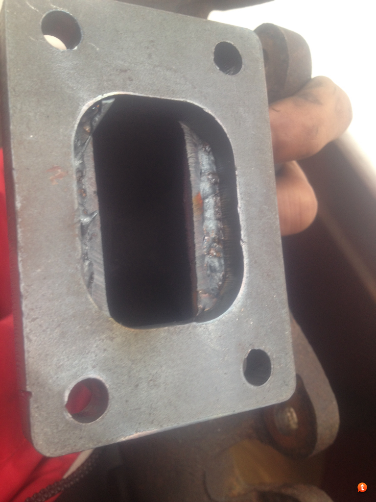

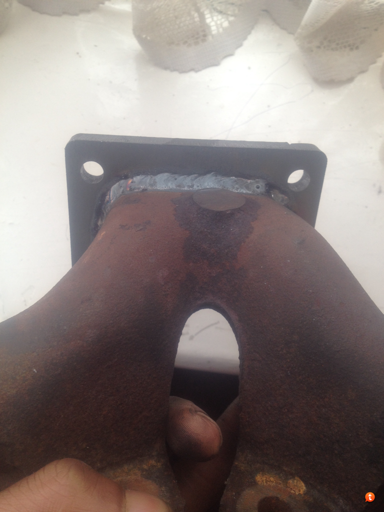

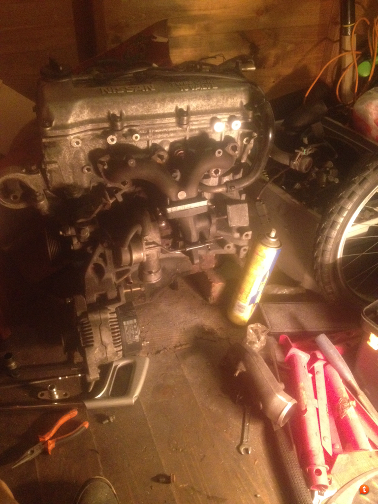

used my tig on my manifold it come out good after many try's on scraps then went for it and I messed it up, the 2 bolts touch the manifold so how will I take it off and angle the flange and do it ? can I take the weld off ? My tb came out good and that's done @frank
Not to put you down but I'm slightly doubtful thats your welding... thats as good as my good day welding and I've been welding a few years now...
plan before welding,,, mock set up like pollyp does
can you get away with smaller mani studs. extending it moves mani away from engine ?
look like smooth welds.
How's about u come Sheffield and u get ur welder with u and will vs each. Other? u can't doubt without seeing me and how much I do
Video? So I can learn how you can weld so well so quickly. Will provide a video myself :)
I don't own my own welder, work provides me with one seeing as its part of my job and all...

I don't need a video how to weld makes no Diffrents to me, that's why I said on one of my post I will never sell my tig and mig wasn't as good as tig coz it's been tryed and tested now and I won't even sell for 2 grand if offered coz I know how good theses are, am happy to send u a video Tommow coz am doing my down pipe cut and weld

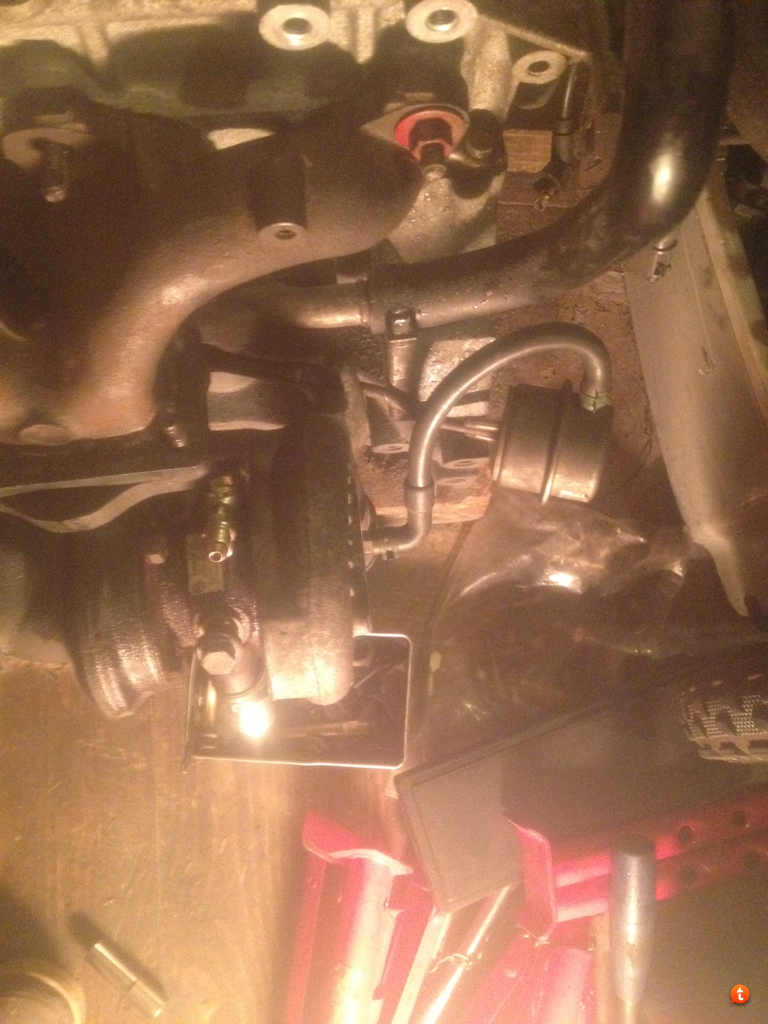

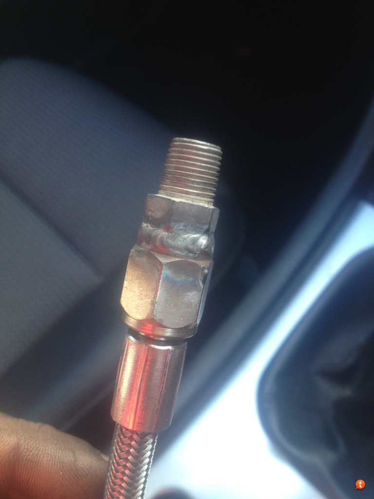

Sorry @Enuo my brother went work while I welded so no videos I will soon got this for my oil feed welded so it's right fitting to my engine to turbo line
I made my video with a camera and tripod on my own. Looking at your welds again, especially the second one, there is a LOT of pitting where you haven't cleaned the metal (like has been mentioned at least 4 times). I welded 2 pieces of steel plate together, but only cleaned one half of the plates and you can see that as soon as you get to the dirty area the weld becomes rubbish:
(I stopped because getting the metal to flow became almost impossible)

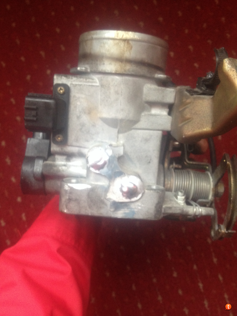

I mean when welding it took me days and time lots of scrap and gas, filler rods to waste but I got the hang of it, the thin stuff needs low settings that u have to move quick with the torch or it will burn holes faster with the heat going it, that's only way I learnt, now saying @h701micra injectors I can weld coz doing smaller stuff is harder then other things, I might even have a 2nd fuel rail made this week

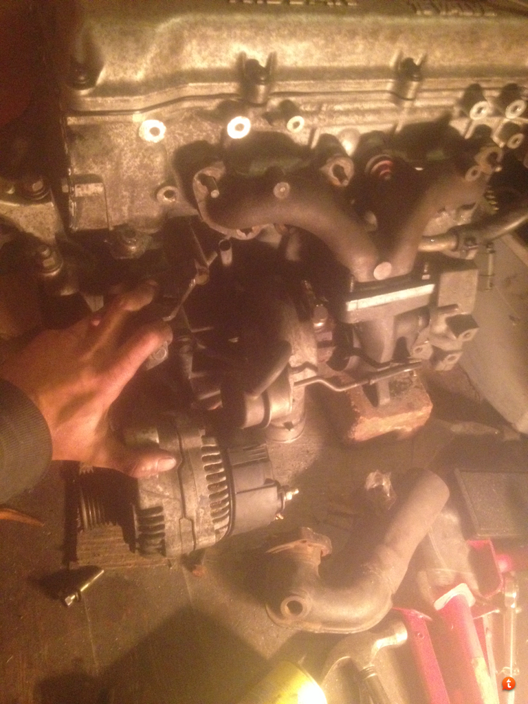

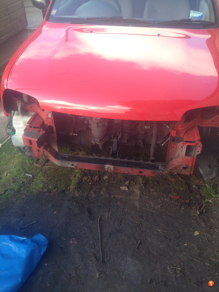

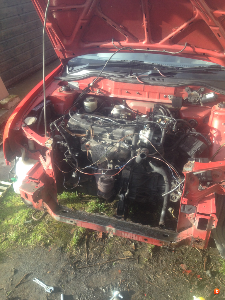

jacked it up and took starter motor out fuel lines, heater matix pipes, now am waiting for a good day to take engine out, @frank is that right ?
Im going to give this a go as well (easier now the heads off too) mainly to save messing with gearbox oil and C clips... anything for an easy life :)
Yeh will all use this idea it looks simple and only messing with engine that way
