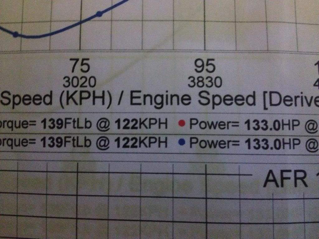

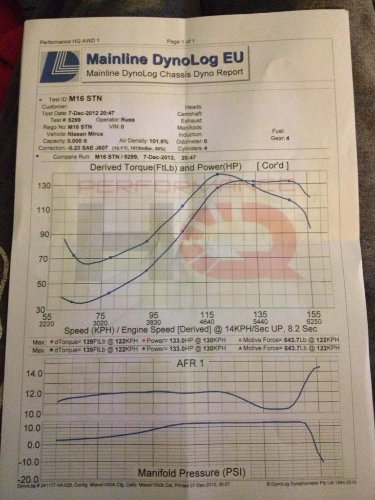

stani recorded 133 whp and 188n/m on a stock clutch i believe azzy http://www.micra.org.uk/threads/stanis-turbo-si-build.43275/page-13#post-558158
i doubt you will be running more than 12 psi tbh

well glanza official figures are 133f/w hp and 157 nm @ 9.4 psi (1330 cc, and 88hp in N/A form) so i guess you will need nearly 1 bar for a "true" 150hp mate
