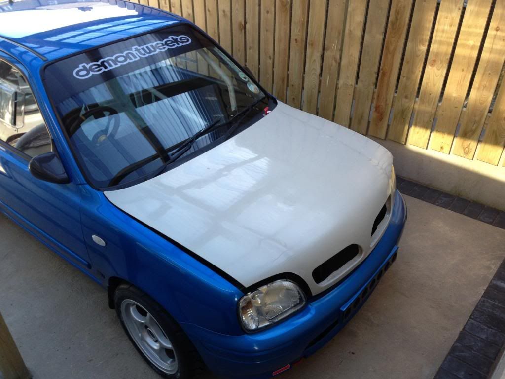

Everything put back together

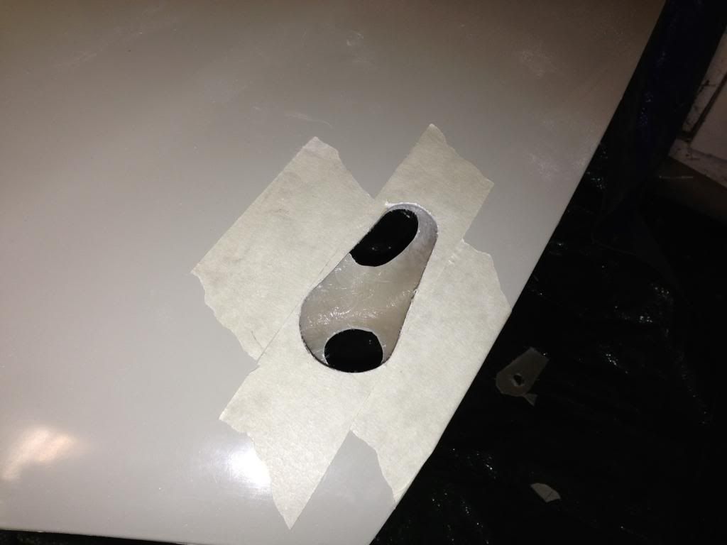

GRP bonnets been on & fitted with the bonnet catchs cut out before it goes to the body shop... waiting on a different vent to arrive to decide which one to use:

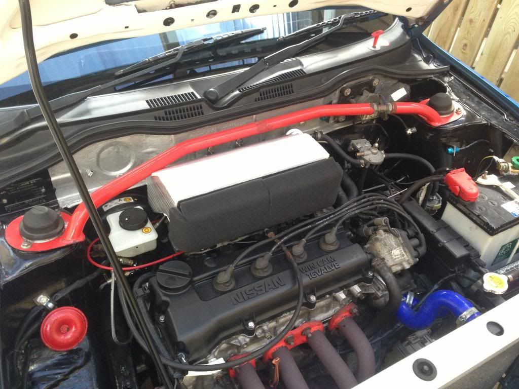

Theres a pic on post #452 bud just up the page, thats everything in place im going to have the bonnet scoop right over the top of the filter ^^^^ :)
Is that going to ram out of the bonnet then? Done a nice job there, how have you secured it all, as my carbs are only on with silicone tubing and clamps, wouldn't really want to add weight to that fixing, have you secured the box and got rubbers round the carb inlets? Deffo next on the list now!

Thats the idea mate it will get the coldest air possible then i hope, its secured buy rubbers i cut & put around the intake trumpets.. they are a tight fit to the airbox, theres naff all weight in the airbox itself:) :

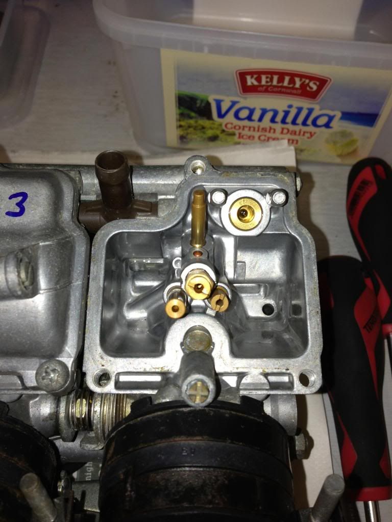

Bonnets at the body shop for fitting and spraying so I've had the carbs off for a once over. Nice and clean inside, measured the jets (they are stamped #115) all coming in at a 1.5mm I.D... I'm guessing that's what the 15 stands for?! So hopefully the #135 jets.. 1.35I.D? Should help get the AFR's in order :)
#115 should be 1.15mm i think paul, maybe they were bored out with a 1.5mm drill ?
I was wondering Frank they were "jetted to suit the spec" by BoggBrothers so your right just drilled out. New jets should be here Monday, so if the 135's are a bit lean I can open then out a little :)

I had 135 as standard with my carbs when I bought them, thought they were leaning on top end so drilled them out, now I have O2 sensitive I realise I was going in totally wrong direction !! Lol

I New jets should be here Monday, so if the 135's are a bit lean I can open then out a little :)
Think mine will get opened out a little but I need a smaller pilot jet aswell. Without having my own rolling road its a case of trial and error with educated guesstimation along the way. Really want to find a dynojet needle kit aswell.
