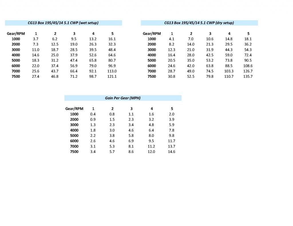

Did a bit of working out on the new gearing with the larger dry wheel tyre setup, happy with the gains i should see in 3rd to 5th as the large straight on the first day of the hillclimb was hurting me a bit hopefully crack the 100mph this year:

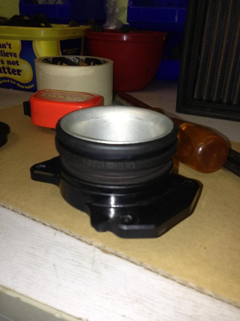

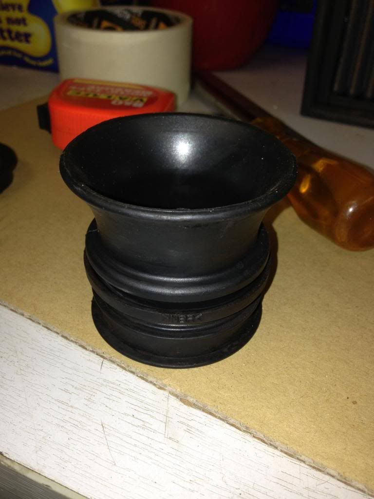

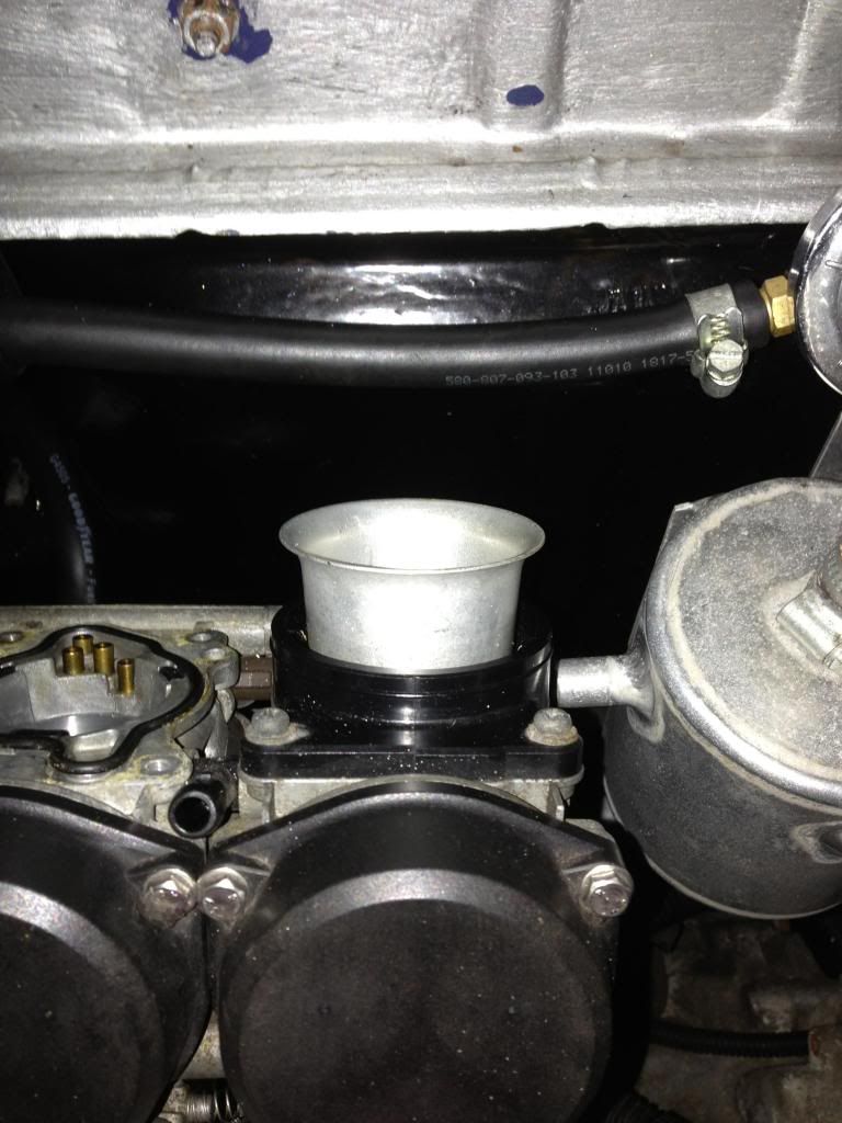

Bit of progress towards the air box, took apart a few Suzuki airbox rubbers mounted to the intake trumpets... These should give a good lip for the airbox to mount too... Best bit they were free :)
That looks like it works a treat :cool: Free mods rule!! Think all my mods are gonna be free ones for a while :(
They will be a snug fit but I hope they work ok, making this airbox fit is going to be a pain in the ..... Lol

What you making the air box from?
This was my way out of done old 52mm exhaust and scrap bit of 4inch tube
Matches the plastic lips perfectly so all yuu do is slip over some blue silicone and j-clip together

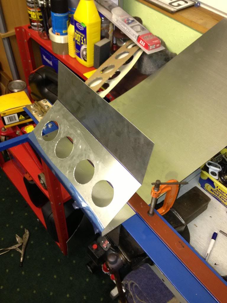

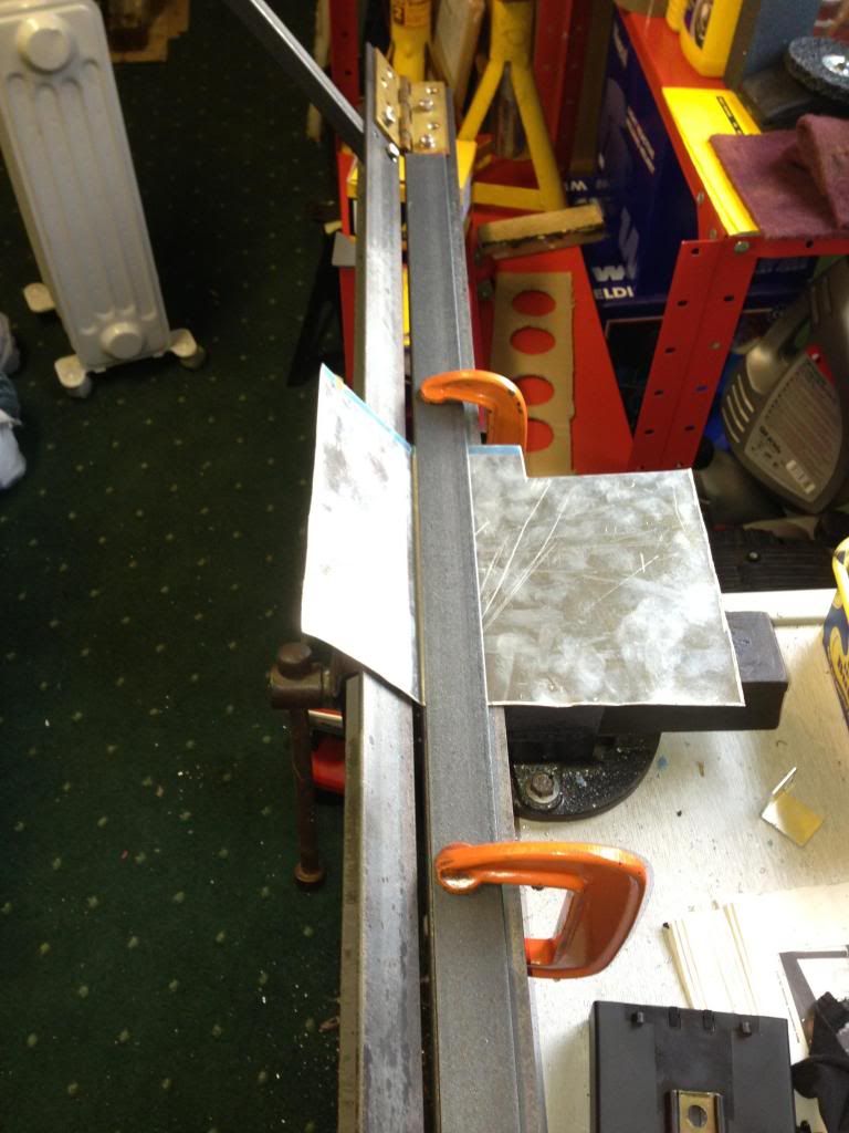

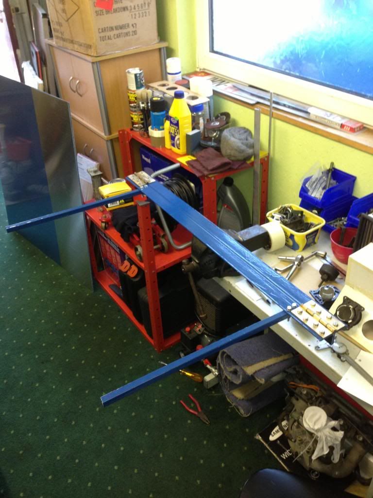

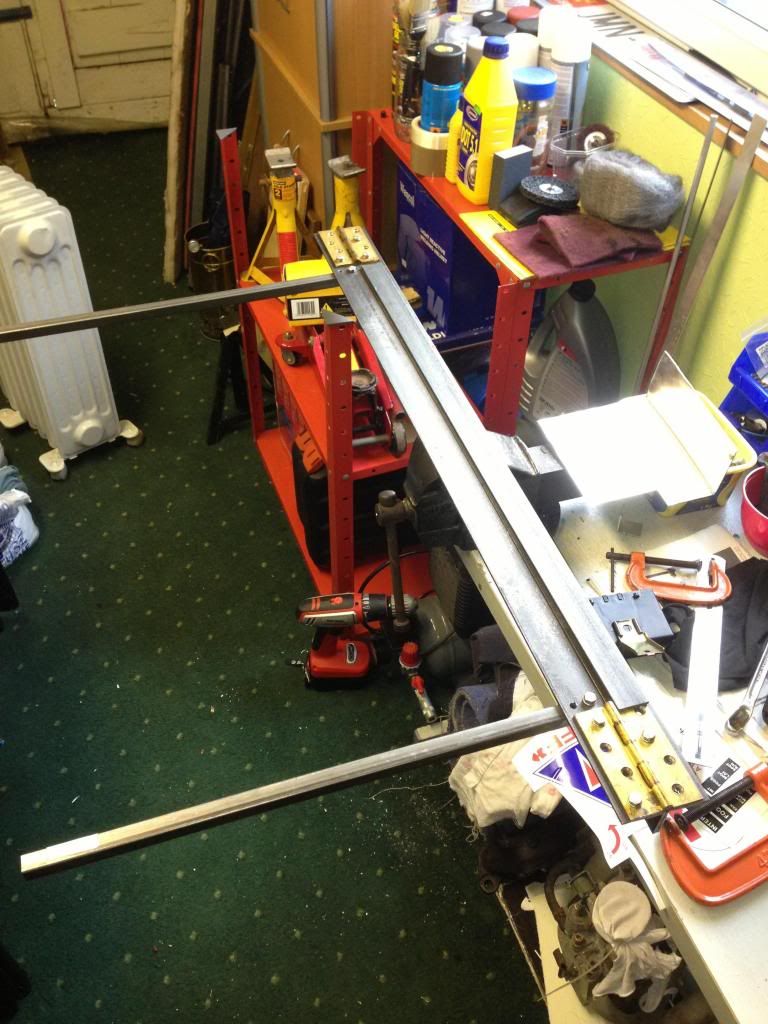

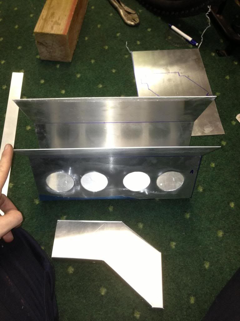

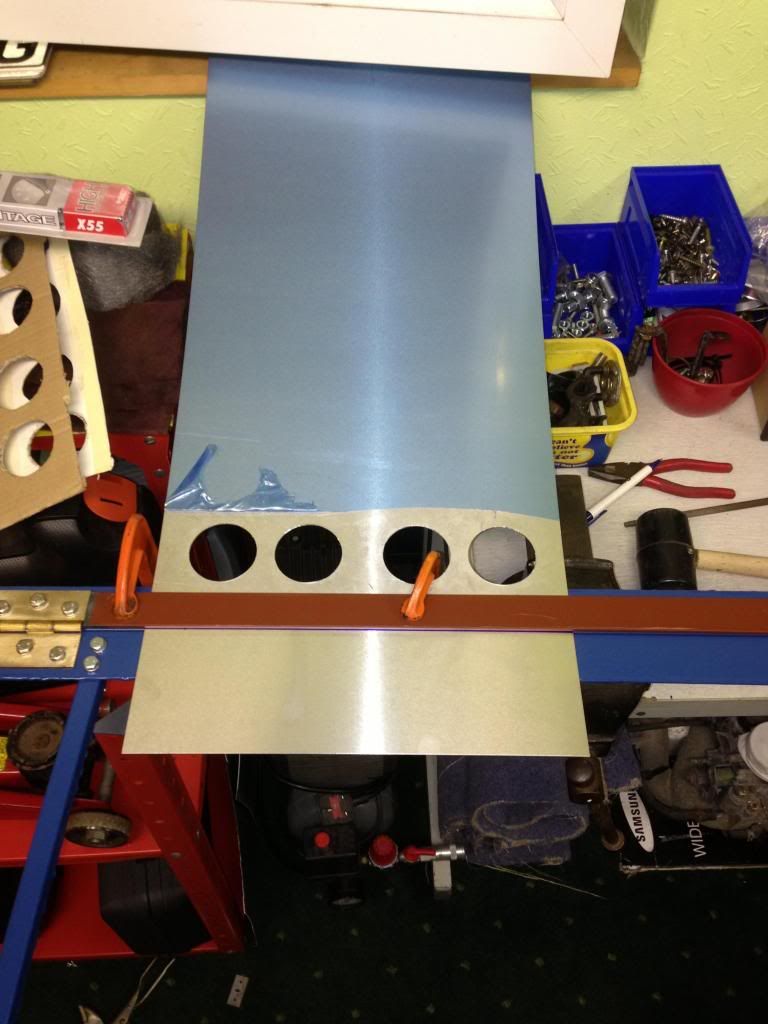

Its going to be made out of 1mm ally mate, hoping to make something like the NME Micras but ducted to the gap next to the rad.
I did think about tubes but 1mm ally is too thin to TIG... if this doesnt work out il have to re think it

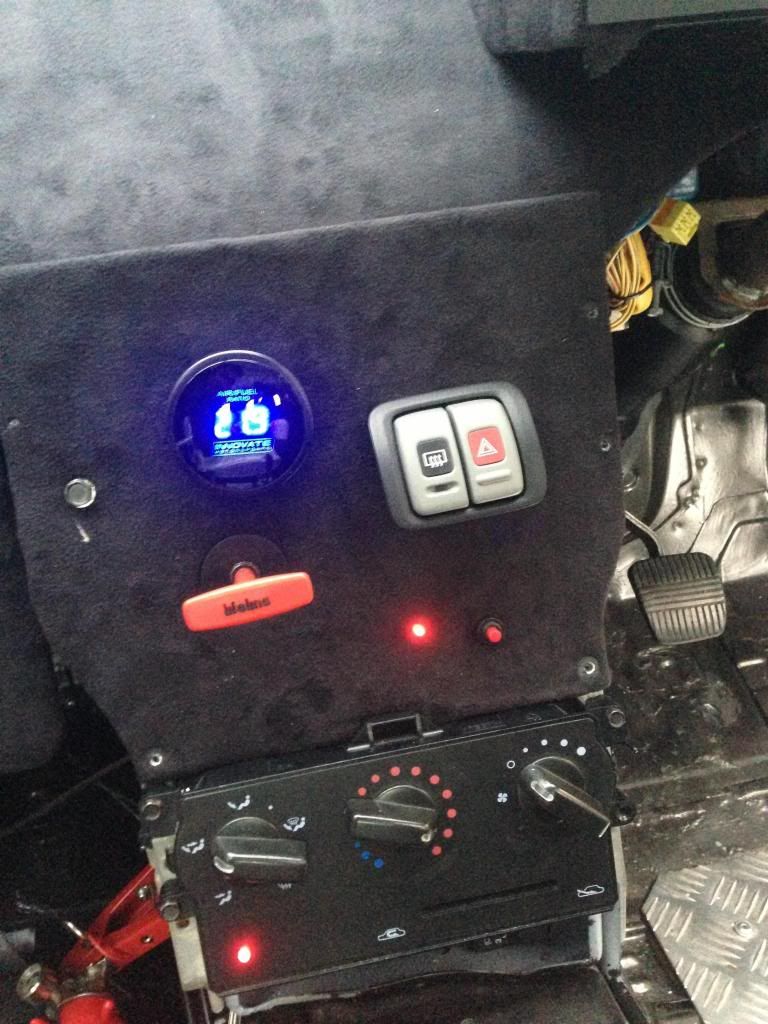

And the dash fits a treat, quite please with how it turned out...

Been trying to decide all day mate and I've ended up back at my original idea, the rubbers I've put around the inlet trumpets will sit in the holes in the airbox, there snug but with a bit of wd40 they should slide on ok :) I'm putting 2 steady bars onto the rocker cover as well for a bit more support.
I've still got to design the filter ducting and how to connect the two bits together, going to be a long day tomorrow
